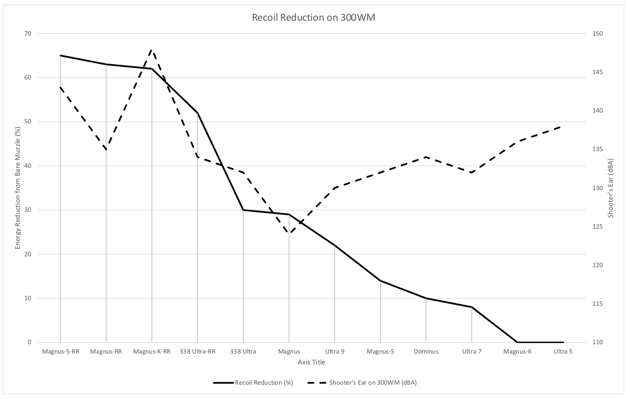

A typical suppressor will reduce recoil by about 30% and a suppressor with a brake about 40%.
The brakes work but it’s not as dramatic as a normal brake because the muzzle pressure is obviously way lower.
So.... 40% is 33.3% higher than 30%. That's fucking huge.
Of course, in your typical fashion, this is also a complete and total fabrication. I've seen them tested with recoil testing equipment, and the difference produced is inside the margin of error of the testing equipment, so the difference is statistically irrelevant.
Did you know that 67% of statistics are totally fabricated on the spot?
A lot. In this graph the RR models have the brake on the end.
ETA: Also, the Ultra50 recoil reduction compared to a bare muzzle on 50BMG is 65% reduction.
Uh. Huh
Reactions: Tx_Aggie
I'm really confused as I study this graph. I'll pick an example, please help me understand..
The first example is a (magnus S RR (with brake as I understand it)). It shows a 65% recoil reduction.
Same suppressor, no brake reduces recoil 15%?
So, unless im reading it wrong, it claims that the brake under the can offers you a 433% recoil reduction vs the can alone? That's just not true.
Am I reading this wrong?
Yes, you are reading it wrong.
ETA-- you are dividing 65 vs 15 and turning into a percent and calling that reduction. That's not how any of that math works. What you are reading as "65" and "15" are the percent reductions in recoil energy from a bare muzzle (per the legend on the left). If Sams is selling brats for 65% off and Target is selling them for 15% off you don't say that Sams has "433% reduction" in anything. Does not make sense.
Also you said "brake under the can" when this whole thread is about external brakes at the exit end of the suppressor.

Tell me you don't understand the chart you shared without telling me that you don't understand it. A 15% reduction in recoil and a 65% reduction in recoil would be a factor of 4.3, or 433% as I originally stated. If a person pulls the trigger and has a 15% reduction, followed by adding a brake to the end of the can and getting a 65% reduction by adding the brake, then that would mean the reduction is 4.3x the non-brake vs the brake. Again, thats a load of shit.
Either neither of us are reading it correctly, or it's bullshit.
I'm pretty sure he understands the graph, given that his company did the research and published it... also, I've heard you get more recoil reduction if you use a crush washer ;)

That's not now "reduction" works.
If a bare muzzle has an amount of recoil energy that is normalized to 100 units, then:
Device A has a 65% reduction, so it has 35 units of recoil energy.
Device B has a 15% reduction, so it has 85 units of recoil energy.
I think you are trying to calculate how much better device A is than B. Do do this, you would divide 35 by 85 to say that device A has 41% the recoil energy of B, or put in other terms: A has 59% less recoil energy than B.
Alright sir, I'm not an engineer, so please bare with me while I attempt to understand this.
If we use your method to explain this, and we say that with no muzzle device, we have 100 units of recoil.
With a suppressor sans brake, we have a reduction of 65 units, or 35 units remaining (which is very impressive to my mind by the way).
Then, if we remove the brake, shooting suppressor only, we now have 15 units of reduction, or 85 units of recoil remaining.
That's a 242% improvement in recoil reduction vs the suppressor alone. Is that correct? I'm ready to be wrong, no shame there. I've just never heard of any of these causing any measurable effect in the tests I've seen, although they weren't tbac cans I saw tested.
The way to say that would be: Device B has 2.43x the amount of recoil energy vs. Device A.
But bottom line, yes, the RR brake does have a dramatic effect on recoil energy compared to the same suppressor without.
Also note that that particular graph is data from 300WM. Data from 308 is a little different as can be seen from the other infographic that BurtG posted. In the case of the Magnus-S or Ultra-7 sized suppressor, 300WM is "almost" overwhelming the suppressor (you can see the K and 5" cans have zero reduction). This is not so bad on 308 since the gas volume is much less.

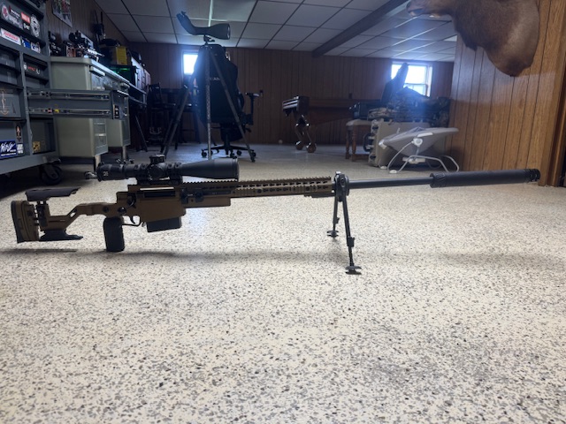

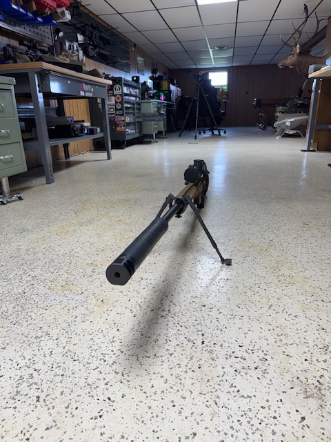

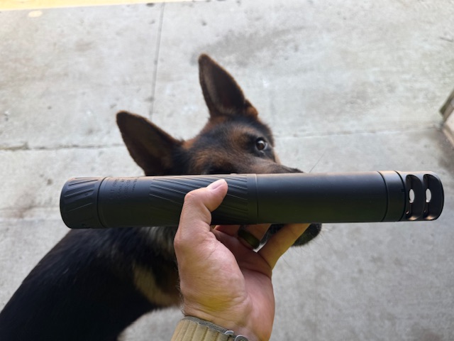

One 338 Ultra RR SR showed up so far. This thing is enormous. Such a nice piece of kit. Hopefully I’ll be able to shoot it tonight.
Reactions: Hecouldgoalltheway

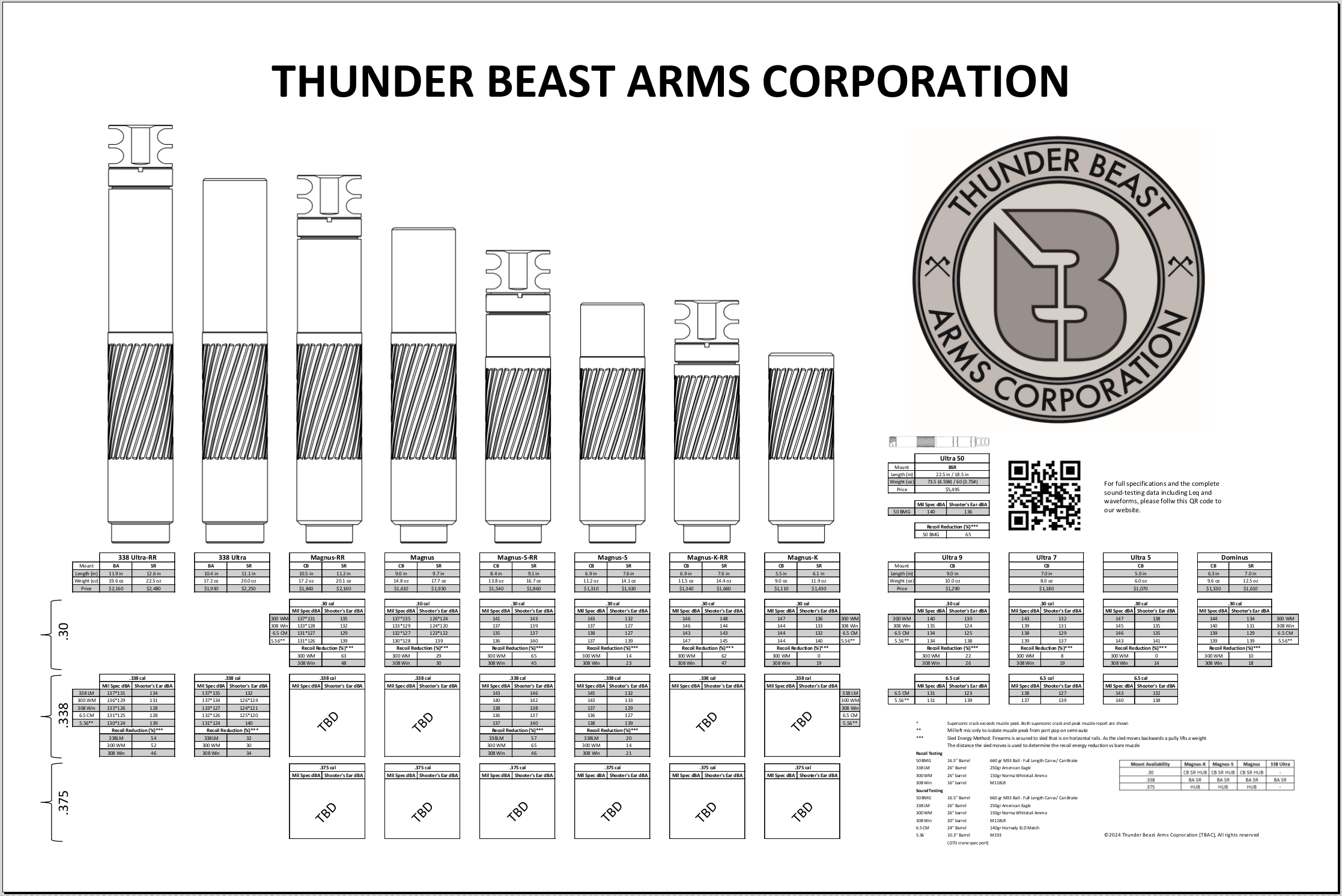

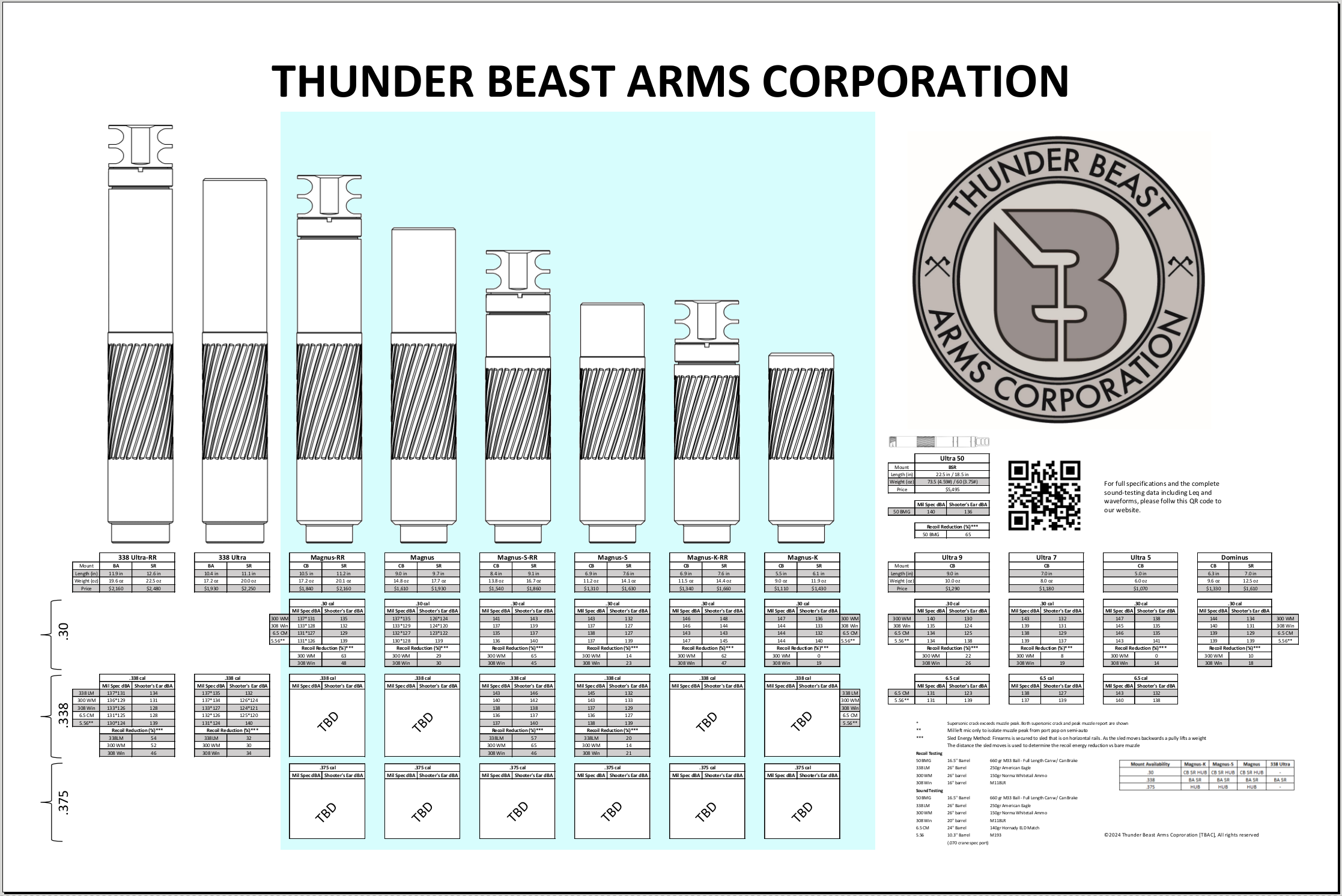

I don’t own a can with a brake, but TBAC has this thing that lists both recoil reduction in % and dB. It’s pretty neat.
Pdf link (also attached):
  • TBAC Poster_2024.pdf
Interesting so it seems like if I'm reading it right the brake increases sound 10-12 dB at the shooters ear compared to just the suppressor alone. Seems like with supersonic ammo, most suppressors from the info I could find reduce noise levels ~20-30dB, so this suggests using a brake on a suppressor costs you about half the noise suppression performance, at least to the shooter and probably anyone to their sides.
That also means the Magnus S or KK with a brake on it are over or flirting with the 140 dB limit for instant hearing damage, but again, with supersonic ammo none of the suppressors are really hearing safe if you value your long term hearing for range use etc.
None of the braked cans are going to provide less shot disturbance than the best brakes. It’s silly to think otherwise. But if you can get halfway there with none of the brain concussing and otherwise obnoxious side effects that are inherent to brakes, then to me it is well, well worth it.
My Dead Air Nomad TiXC with the Recoil X gen 1 brake and my RXD30Ti are both quieter to my ear than my Ultra 7, if that gives you an idea of how effective they suppress. That was my gold standard can for years.
