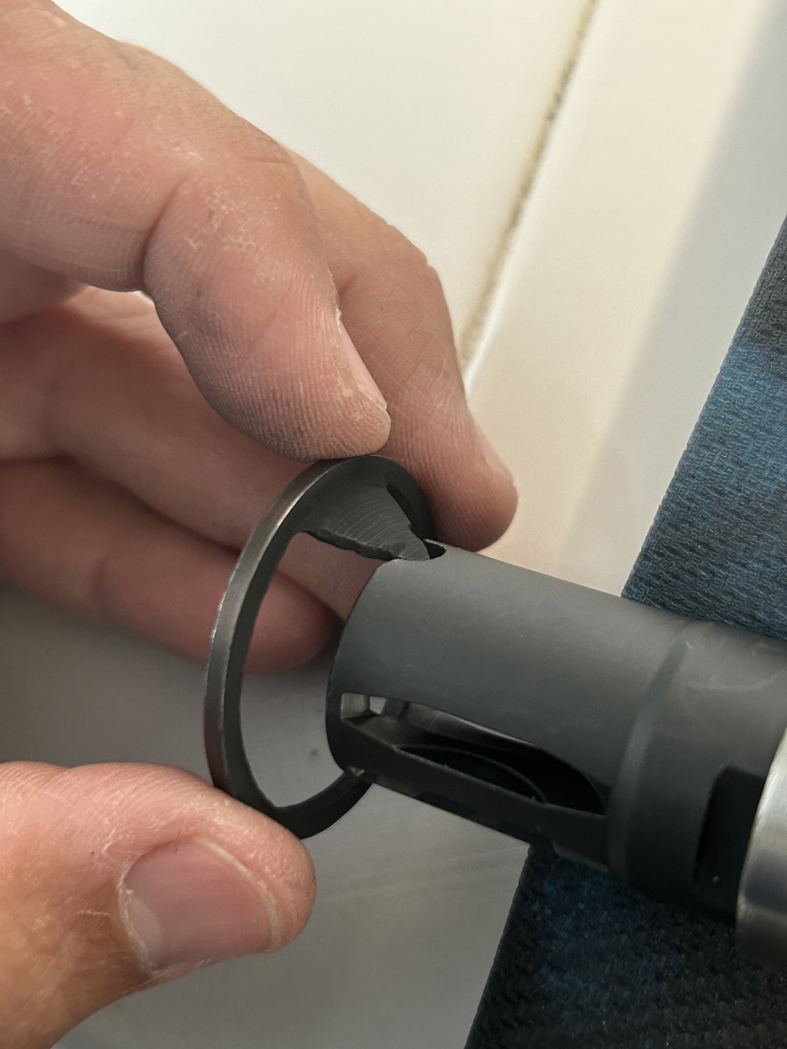

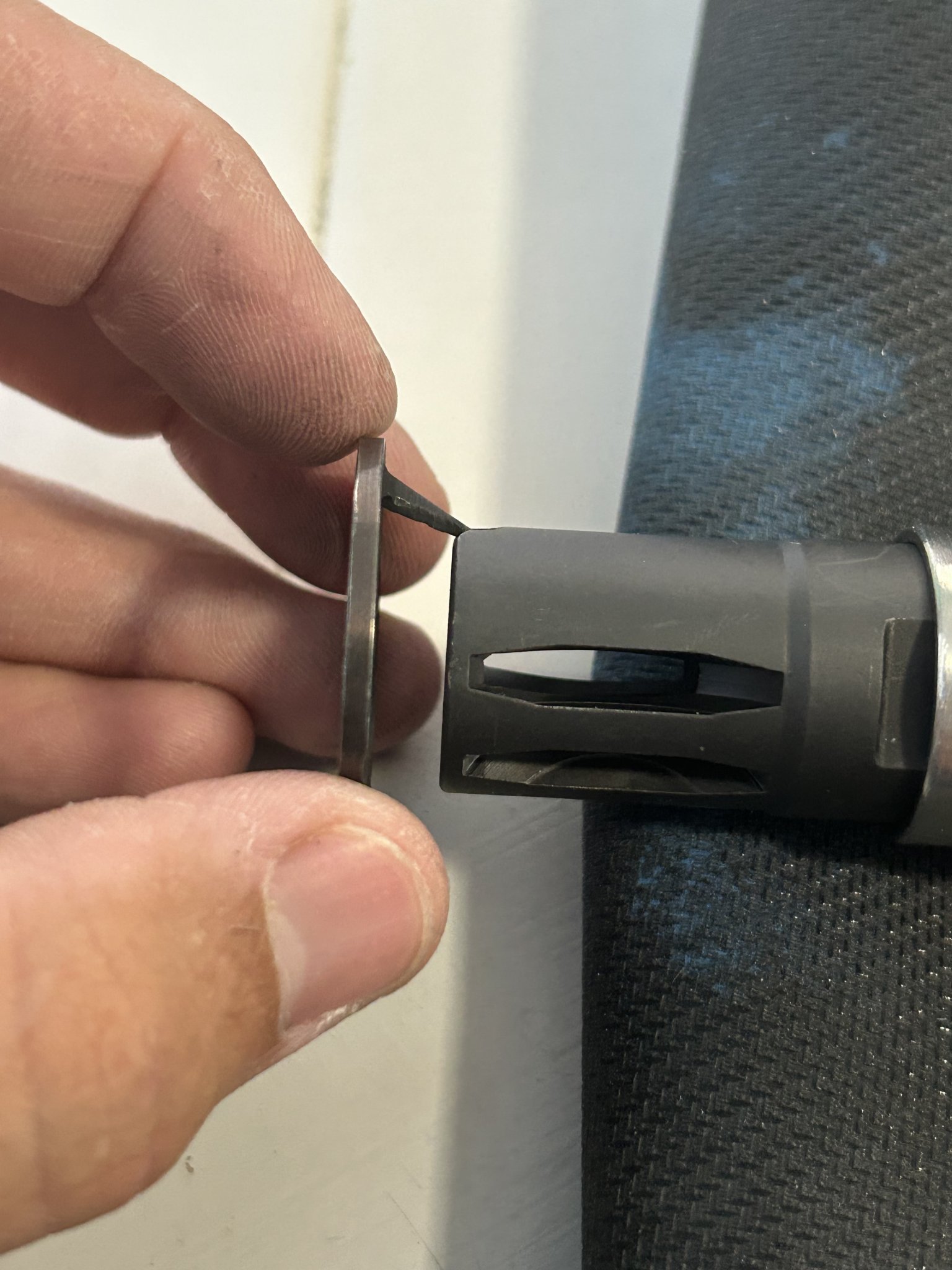

My xm-3 should be done in a month or so, so I made some time to finish my clone can.
Sounds great on a 12” 6.5G and a 24” 6.5c using a quell tech OTB adapter.
9” tube with a 3.25” shelf. Stack order against the shelf:
Alignment tab
Flat SS baffle
2 SS double angle cones
7 Ti double angle cones. All the cones single clipped and about evenly spaced.
For the alignment tab, I cut a 50 degree cone then dremeled all the cone away except for a little triangle tab that the muzzle device can only index on one way without touching. No baffle pics, but I’ll post pics of how the tab works when I get the rifle back.
Weighs in at a hair over 19oz, with 5 and change of that being the Surefire adapter.

looking forward to seeing that. I'm waiting for ECCO to start taking work orders again.
