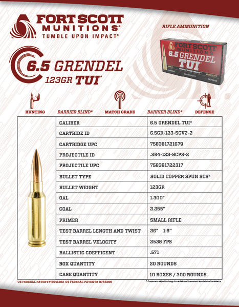

The Fort Scott 123gr TUI has a listed .571 G1 BC, and is 1.300” long. It doesn’t look like anything in that picture. It’s really secant with a pointed tip. Their 24” test barrel showed 2538fps with that ammo, which means the monolith is eating up case capacity, and you have to be careful driving it into the lands.
