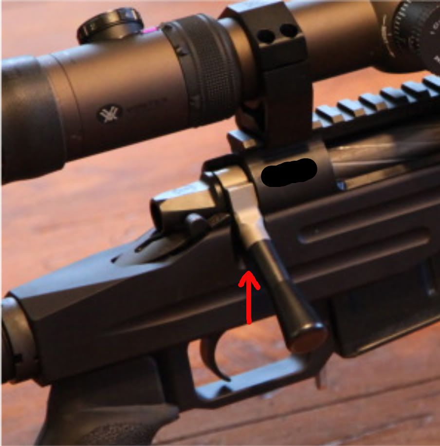

No mod needed for bolt handle to close.

Hmm...I think you might want to double check it. It looks like your bolt handle is not seated all the way.
Look at your ser. # and the relationship to it where the handle joins the bolt. It looks as though it is sitting "high" and not all the way closed. Look at the pictures of my two 591 actions and you will see what I am talking about.
That was the reason for my question. Most chassis/stocks that are inletted for 700 actions need to have some material removed from the bolt "notch" in the stock as the Surgeon handle is not flat like a Remmy 700 bolt handle.
You can also verify this by removing the barrel action and closing the bolt and again, measure where it sits when closed vs in the chassis.
The AICS,and JP Chassis need to be modified to allow the 591's bolt handle to close all the way and material must be removed from McMillan and B&C stocks as well...these I know of for sure.
I could be wrong...been there before...but it sure looks like it is hitting the chassis from your pic.

<div class="ubbcode-block"><div class="ubbcode-header">Originally Posted By: BgBmBoo</div><div class="ubbcode-body">Hmm...I think you might be wrong. It looks like your bolt handle is not seated all the way.
Take care,Stan
</div></div>
Hmmm, thanks for the heads up. I didn't look really closely this morning, but everything felt fine. I'll take a close look when I get home this evening.
Just so I'm clear, the part of the chassis that need relief is the bottom of the bolt handle channel (as illustrated in my picture)?
Re: Surgeon .243 Build with XLR chassis
Yes...take the barrel action out of the chassis and close the bolt. You will see right away where the bolt handle should be when fully closed.
I had the same issue with the JP chassis. And thankfully caught it before I went out and shot it. It will still fire like that...but the lugs are not fully engaged with the handle up like that.
I know it will feel "right" because your having metal on metal contact...bolt handle hitting the metal of the chassis. But for safeties sake please check it out CLOSELY.
Let me/us know what you find. It is not a big deal...I am sure you could send it back and have them hog out some material and re-anodize or re-coat it.
On my JP chassis I just took it slow with a Dremel and small grinding wheel.
Then taped it off and painted it black. Had to see and tell unless I point it out to folks.
Take care,Stan

Well, I checked last night and did indeed need to dremel quite a bit of material out of the bolt channel. Kyle at XLR also contacted me after seeing this thread and was very proactive in getting everything straight. Gotta say it again, the service from XLR is absolutely top shelf.
