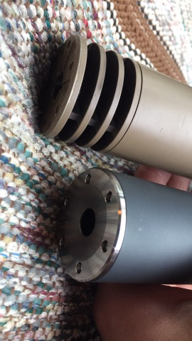

I just got my new second omega. The one difference is the asr break cap on my old dirty can vs a flat titanium cap on the new clean can.
Using my 6xc and my 6 dasher I couldnt tell a difference between the two at 100 nor at 500 in my little test while swapping them back to back and trying to map any differences.
Using my 223 I was perfectly centered up and punched out the orange dot with the tan asr cap can (which is why the dot is not there anymore), I was slightly low to the right with the new flat cap can (which is why the sticker is still there and not shot off, it shifted that small amount)
So 2 out of 3 rifles were good enough, 1 was slightly different. Ill stick to what individual can I developed a load with just so I dont have any doubts in my mind.
