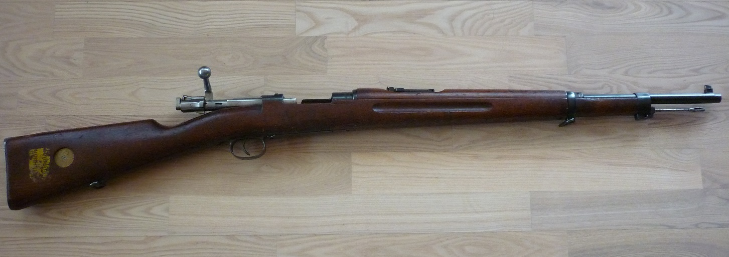

    I just bought an M/38 on Wednesday! You are correct in both points 1. and 2.
    Here is a photo of mine

    Husqvarna made m/38s and m/96s. The m/96 is a tough one to find. The bolts can be found with straight or forged down handles. On these husky m/38 guns, only a few numbers will be matching. The bolt handle, sometimes the whole bolt, receiver, and sometimes buttplate are matching. Other times, parts are mismatched or do not have any numbers on them at all. You can tell if the parts are Husky made if they are marked with a tilted crown. If it's a flat based crown, it's a Carl Gustafs made part and if a "sagging bottom" crown, it's an Oberndorf made part.
