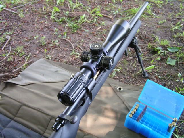

I’ve had the Super Sniper now for 7 days and was finely able to use it for what it was designed for, long range target engagement. To this point I had put just enough rounds under it for a zero and a quick load test and a little time out in the back forty to see how it stacked up against what I usually carry. That being a Nikon, Leupold, Burris, Vortex, Swarovski and/or Nightforce. The SS appeared to be well made, well thought out and showed characteristics of good optical quality.

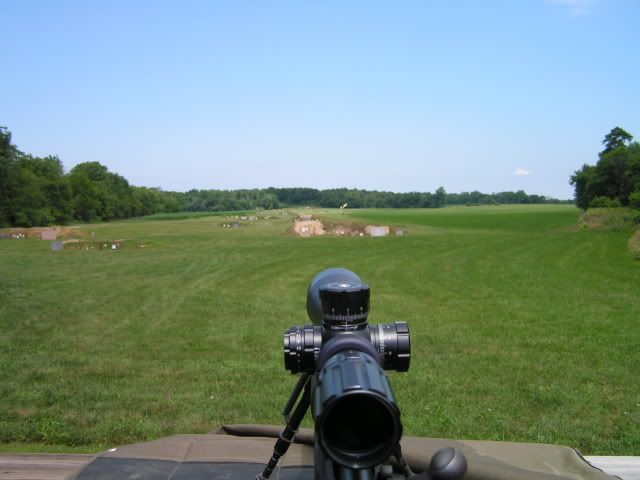

Now for the meat. It was a nice warm day today at the 1000 yard range and there was significant mirage present. Along with me was the 5-20x50mm SS, 3.5-15x50mm NF NXS mrad/mlr, Leupold (pre MK4) 3.5-10x40mm M3 and a Nikon Tactical (pre X)2.5-10x44mm with the Gen2 copy reticle. I started shooting with the SS at 400 yards and dialed in every hundred yards out to 1000. I experienced no problems there so I started dialing in drops predicted by JBM or my FDAC slide rule for different distances between 300 and 1000 but not in order this time. I used up to 11.8 mils and I am happy to say it track properly with in that range and right on the numbered indicators. I mention numbered indicators because when I first zeroed in the pouring rain and reset the elevation knob it would not line up perfectly with where the 0 is indicated on the dial. It would line up either tenth of a mil low or half way between 0 and a tenth of a mil above the indicated 0. When I went out the next day to shoot some dots I found needed to adjust my zero by a tenth and reset the knob zero at which point everything lined up like it should.

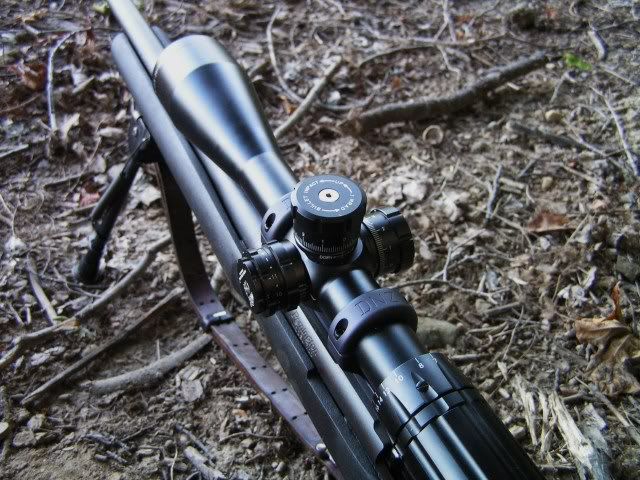

I too find the power adjustment difficult to turn because of nothing present to get a grip on. I suppose a cat tail will fix this but it truly will be necessary, that is, unless you like getting out of position to get a better grasp on the adjustment ring.
