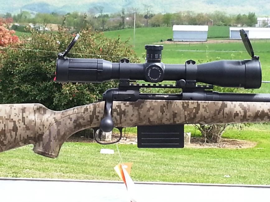

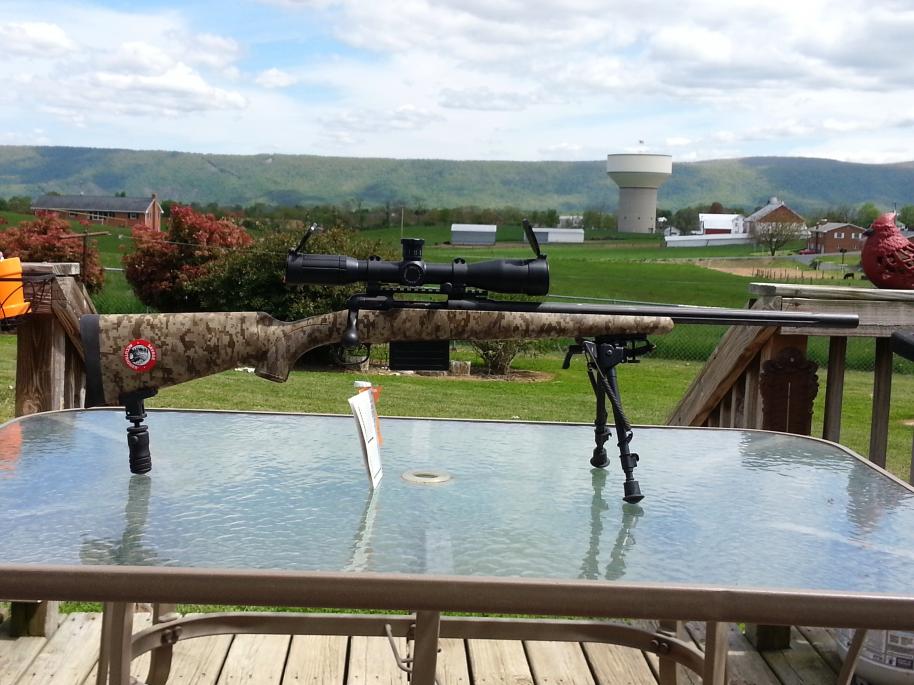

Got mine mounted on my shorter BBL 308 folder this weekend but didn't make it to the range.. Review is comming
My New Savage 10FCP .308
22 Inch Heavy Fluted Barrel
Brown Digital Stock with Dual Pillar Bedding
Adjustable Accu-Trigger
Oversized Bolt Handle (Sharpshooters Supply Tactical Black Bolt Handle on Backorder)
SWFA SS 3-15X42 with Butler Creek Caps
EGW Tactical Picatinny Rail 0 MOA Scope Mount
Warne 30mm Low Quick Detach Rings
US Optics Anti-Cant Picatinny Rail Mount Swivel Bubble Level
Sharpshooters Supply High Capacity 9 Round DBM Magazine
Harris Ultralight S-LM Swivel Bipod 9"-13" with Micro Stainless Steel Pod-Loc Handle
Accu-Shot BT04 Locking Monopod

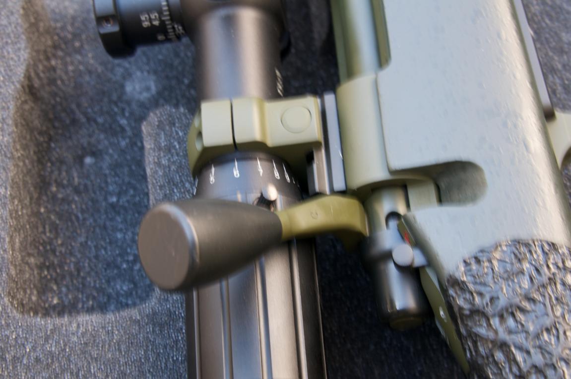

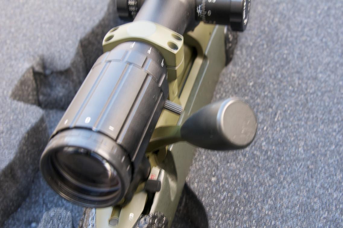

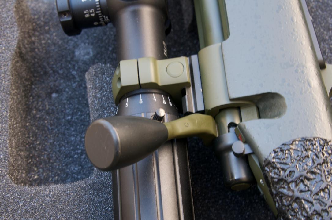

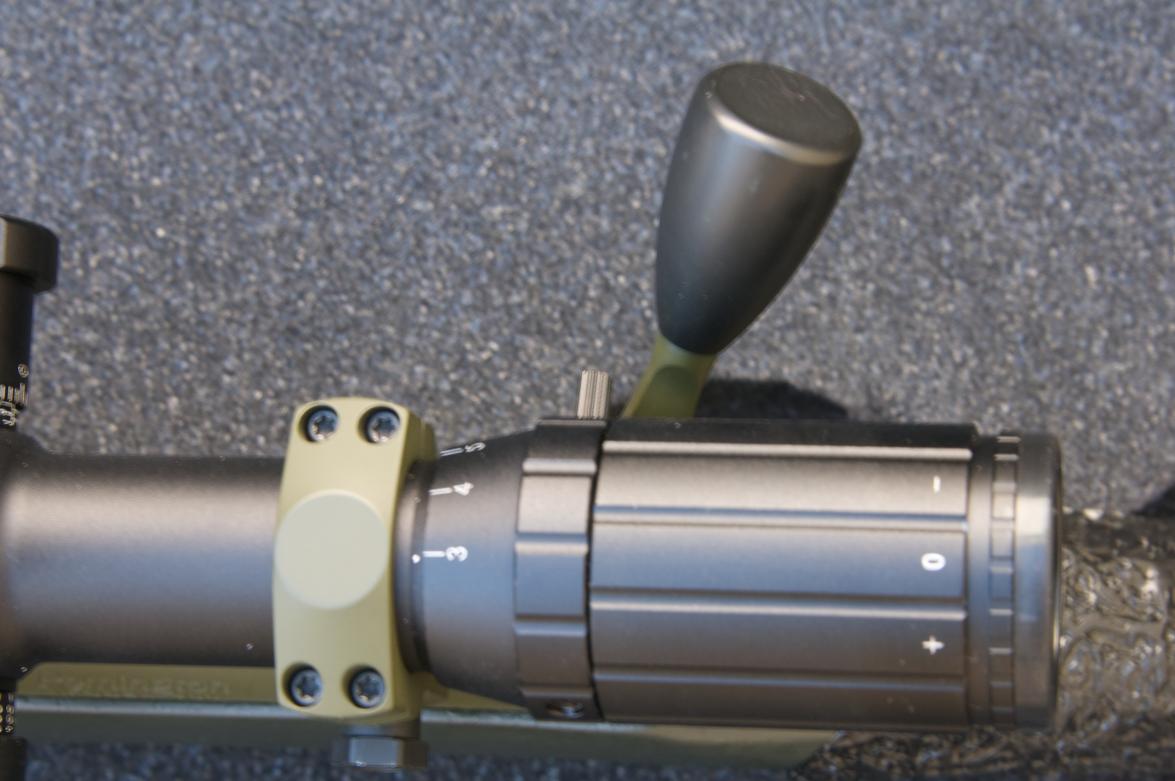

It has to be dependent on the rifle and set up for the throw lever and mine is definitely clear even on low power.
So you can't just say it gets in the way ...

Frank, You are correct. Sorry I didn't take pictures to post, but with the scope setup the way he wanted it, the lever ended up further back. He picked up the rifle earlier today or I'd take and post pictures. I'd venture at least an inch further back than in your picture, so that the cat tail lever is to the rear of the bolt when the bolt lever is locked down. So, when the bolt lever is in the raised position and pulled back it would certainly hit. I could finesse the bolt past and barely clear the cat tail stud, but if it were done in a hurry with force there could certainly be an issue of hitting it hard.
To all other SS 3-15 scope owners, let me clarify. If your scope ends up mounted and the cat tail stud ends up ahead of the pivot point on your bolt, you will be just fine as Frank's photos above show. If the cat tail ends up further back where a raised bolt handle could possibly interfere, make sure you check for proper clearance throughout the scopes magnification range.
