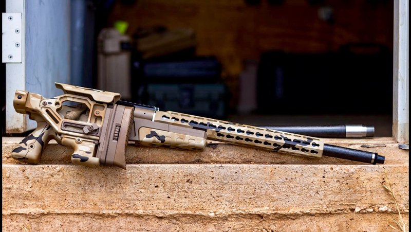

I went with the switchlug. It's almost most finished up, I'll post an update one I get it . For me I wanted a system that I could use with the action and chassis I already had plus to be able to swap barrels without removing the the action or the scope.
heres a pic my smith posted on FB.

Looks great- I saw that on WTO Instagram earlier today. What action is that?

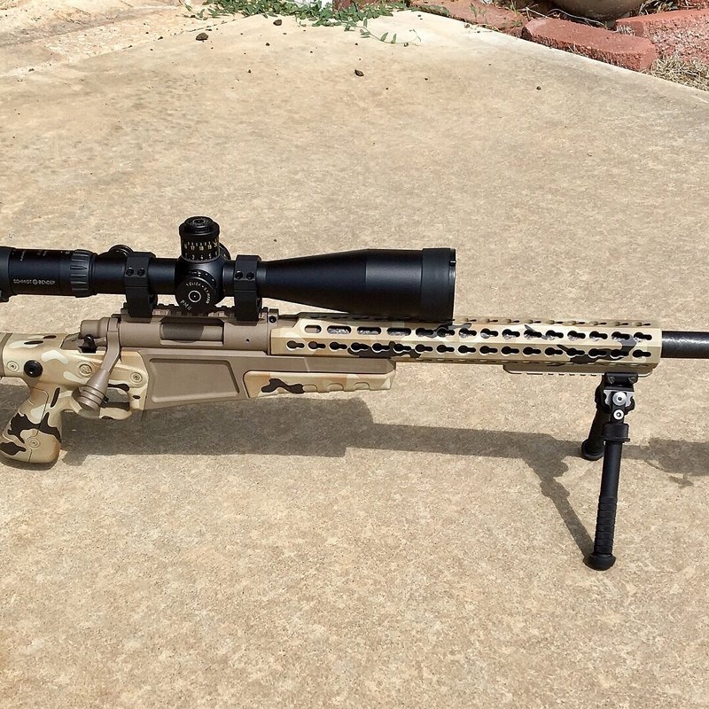

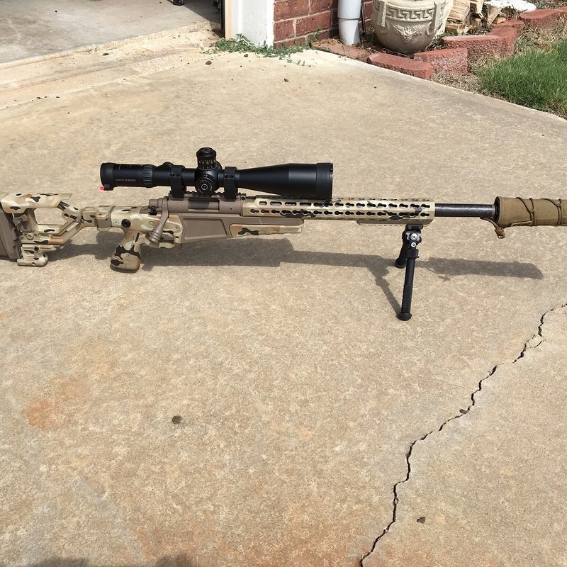

My switchlug lug back from West Texas Ordnance and all dressed out and loads all loaded up for load development tomorrow.
