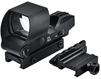

I almost want to suggest as a possible option is one of the bore sighting tools from Leupold or Bushnell, where you can document where the sight is according the the graph on the bore sighter. I actually have both brands but never ever use them as I just find it too frustrating.
What you can do to reliably confirm your zero is use a secondary sight of some sort, and that could be a compact laser or a red dot, but it needs to be mounted on the rifle separately from the scope mount. That way you have a consistent point of aim on each rifle you can reference whenever you change. Even a low cost option will get the job done for you, so you don't need to go spend top dollar on a premium brand red dot or laser. Its way cheaper than another good scope, and it can help save your bacon if you ever get lost in the changes.
Accuracy will depend on the shooter not having astigmatism so he can see the red dot sharply. I see about 8 dots, so This wont work quite so well for me personally, but lots of young guys wont have that astigmatism problem... Or older guys who've had cataract surgery. I cant believe I'm looking forward to THAT!
Here's a cheap example of a sight you can mount separately.
Reactions: Lthrt
interesting, i have an offset/angled mount on my AR and enjoy it....never considered using one on a bolt action rifle.
There's another bonus if you're a PRS shooter where you can use the red dot to get close quickly, then switch to the scope for precise shooting.
I always see guys running out the clock by zooming in and out to find the target, but a red dot is faster.
