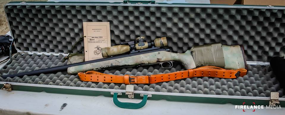

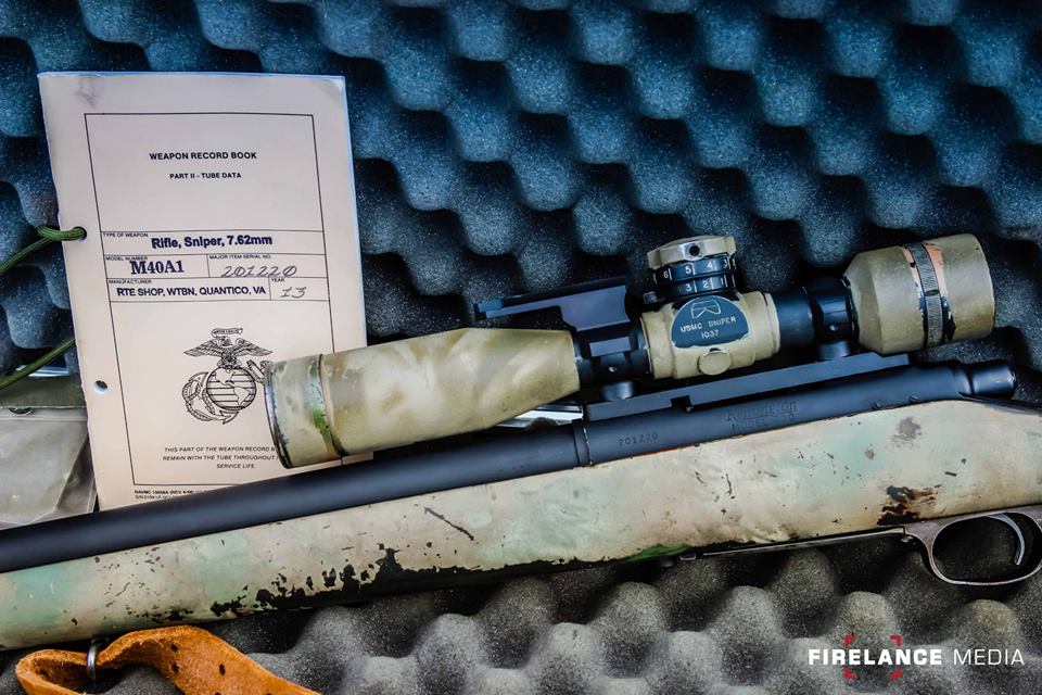

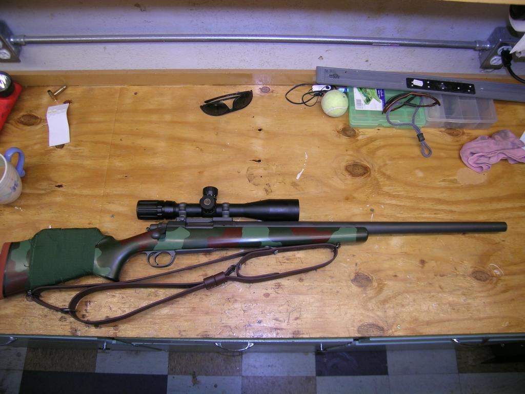

Fun thread! Thanks for bringing back fond memories. Here's some photos from the ones we used in 3/6 STA, mid 90's. I'll dig more up tomorrow. A legit M40A1 is a beat-up, ugly ass used rifle that continues to perform after taking as much abuse as a platoon full of hard charging Marines can dish out!
S/N
[MENTION=13734]Stone[/MENTION] Bay, ~1996...
A1 in Japan...
And just for fun and because...some Barretts...
Later model M82A1 with longer rail...
vs earlier model rail...
We never thought to take close up photos of these at the time...wish I had! And I wish we'd had better camera's back then. These old 35mm and 110 cameras weren't that great...they don't scan/transfer well to digital media.
Well said! Nice pictures. Especially the first one with the old Kaddy case with name and serial on it ;)
