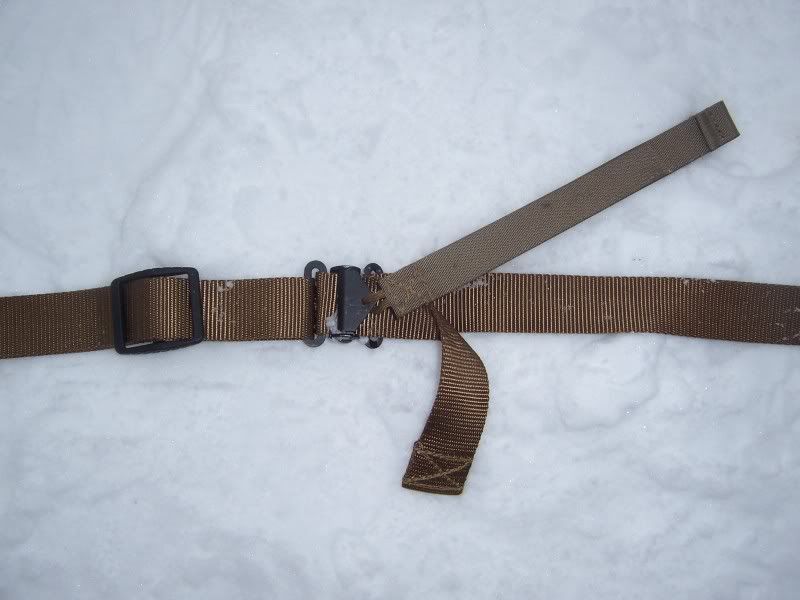

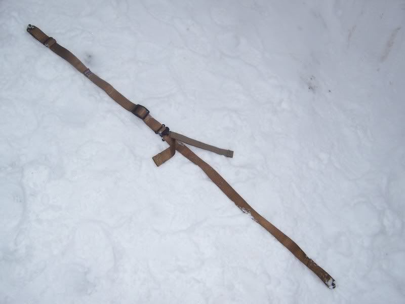

Well I got my hands on two of them at Shot and smuggled them back to the frozen Ohio Tundra. Since I got back from Shot I have logged about 12 hours of range and dry practice with the new TAB QA (Quick Adjust)Sling. The sling is built with the same 1.5 inch webbing and hardware as the standard TAB sling but with a robust adjustment similar to the ones found on ALICE packs and VTAC sling but the adjustment on the TAB sling is a 1.5 inch adjustment.

We will be changing three things from the sling you see in Cowboy's pictures.
The user will be able to change out the swivels himself, the back swivel will not be sewn in.
There will be a stop sewn into the main webbing to keep the end from pulling up into the quick adjust buckle when the sling is loosened all the way.
The one inch grab webbing sewn to the quick adjust buckle will be shortened, and made of a contrasting color.

Quickdraw40, I was asked this several times at SHOT. If you look at the pics above you'll see that the webbing on both sides of the adjustment slider are all sewn in, so in this configuration you can't convert an existing TAB GEAR sling. We'll be working on a version that has a male portion of a Fastex buckle sewn in where the the quick adjust is now. That will allow you to purchase the "back section" of the sling and simply install it in your sling now and you'll have the quick adjust feature.
