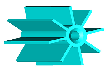

tacom structured barrel
If you think of the barrel as one that moves up and down in a sinusoidal wave pattern, projectiles traveling at different velocities will exit the barrel when it's at different positions in that sinusoidal wave. Some velocities will result in the projectile exiting when the barrel is pointing up, others while the barrel is pointing down, which results in a hypothetical vertical dispersion.
If you can "deaden" that barrel by removing, or at least mitigating those sinusoidal wave patterns, aka "harmonics", you reduce the vertical dispersion in projectiles traveling at different velocities.
At distance, you're still going to get vertical dispersion due to differing velocities - that's physics that isn't overcome by a structured barrel.

The basis is the harmonics and a few small other things. It is well known that a straight barrel tend to whip less. What they have done to what in reality is a straight profile barrel is to block the path of the barrel’s harmonics. They flute and drill based on computer simulations of the barrel’s harmonics. They are also changing the cooling thermodynamics reaction of the barrel. As I have said a few times I understand the Engineering of the idea. What I am unconvinced about ( due to the incomplete test protocols) is to what extent they are actually making meaningful change.
If is interesting that the new Noveske DDF series of barrels is claiming the same benefits. They have used a different easier path , no holes but deep rounded flutes, to gain the same results. This in principle should gain some of the desired outcomes with the ability to built at rate.
I am still interested, not enough to buy one, but interested nonetheless. I am waiting for more concrete studies and victory plaque evidence. But as always I love true innovation.

The structured barrel design is interesting. It appears to have natural damping across a wide range of rounds, hence why Tacom says the rifle shoots the same regardless of the ammo used. Their design appears to be a closed star pattern, basically a tube that has parallel bore ribs to provide anti-bending, and then it's closed which makes it even more stiff and forms cooling channels. The ribs on this example provides lots of strength from bending, in other words, the bending moment parameters change and the harmonics from the round are squashed. So what Tacom is doing is manipulating characteristics via physics. Neat.

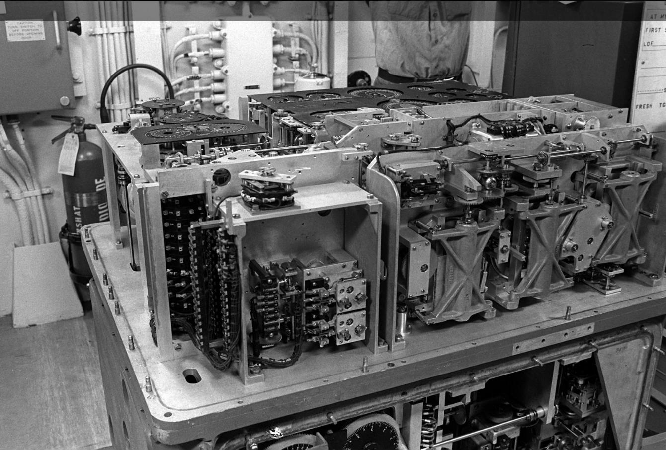

Generally with very advanced fire control computers. Even the old battleships had analog computers that were filled with gears and wheels that computed the gun position. These take into account the characteristics of the barrel.
Modern guns (like the Abrams) have computers that take temperature, barrel droop, number of rounds fired, humidity.... all kinds of factors into the shot. If you look, you can see a laser on the barrel that is part of the system.
None of that really applies to small arms (yet).

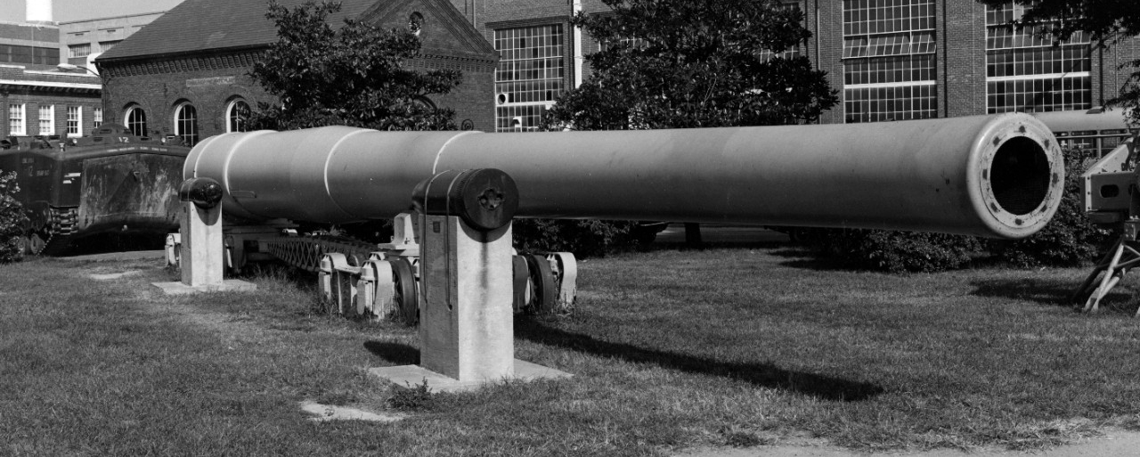

And the Abrams is a smooth bore. So it has very different dynamics from a rifled barrel. It's more like a blowgun than a rifle. It doesn't have the same twisting or resistance of a rifled projectile.
So it can get away with much thinner walls. And it is all backed up with electronics. IIRC it's a German gun and stabilization system. Krupp or Rhinemetal. The accuracy comes from the fire control computers.
As for the barrel to bore diameters on a 16"... Not as thin as one thinks! And if you look at the breech area (much lower pressure back there than a rifle round, too) the working area is pretty thick. Look, too, at the OAL. It's short and stubby (even though it looks long and thin).
As for structured barrels, they have been around a while in artillery and similar applications. But can be expensive to make vs. the cost of using 'regular' barrels and swapping them out often or using fire control computing to make up for the deficiencies. And now using smart munitions.
None of that is an option in a small arm/precision rifle that has to be toted from place to place in competition or the field.
As for the barrel to bore diameters on a 16"... Not as thin as one thinks! And if you look at the breech area (much lower pressure back there than a rifle round, too) the working area is pretty thick. Look, too, at the OAL. It's short and stubby (even though it looks long and thin). View attachment 8682767

Doing the math for the 16"-50 guns is the equivalent of a 15" 308 barrel or 13.2" 6.5 bore.
