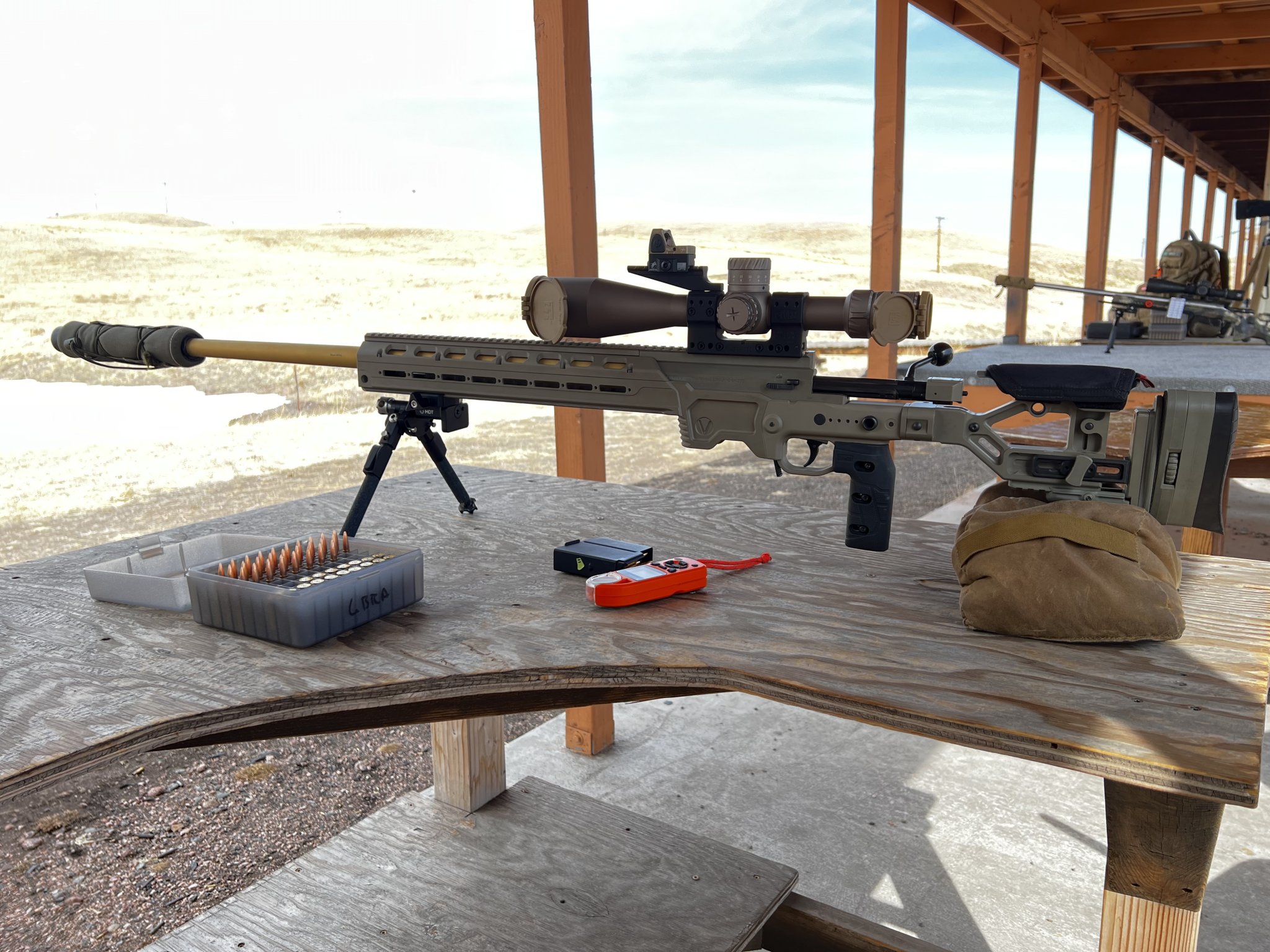

Relevant photo, I brought my 22GT barrel to get dope, and had the BRA barrel to break in that day.

I used my AT-X for the the same reasons you’re looking at. Had my 6.5 CM barrel for practicing and my 6GT for matches. Practiced with the 6.5 for the added recoil. My zero difference between the 2 barrels was .5 up and .2 right going from 6GT to 6.5. Very repeatable. As mentioned above, you’re paying a bit of a premium for AI but they’re some of the most rugged rifles out there and you won’t be disappointed

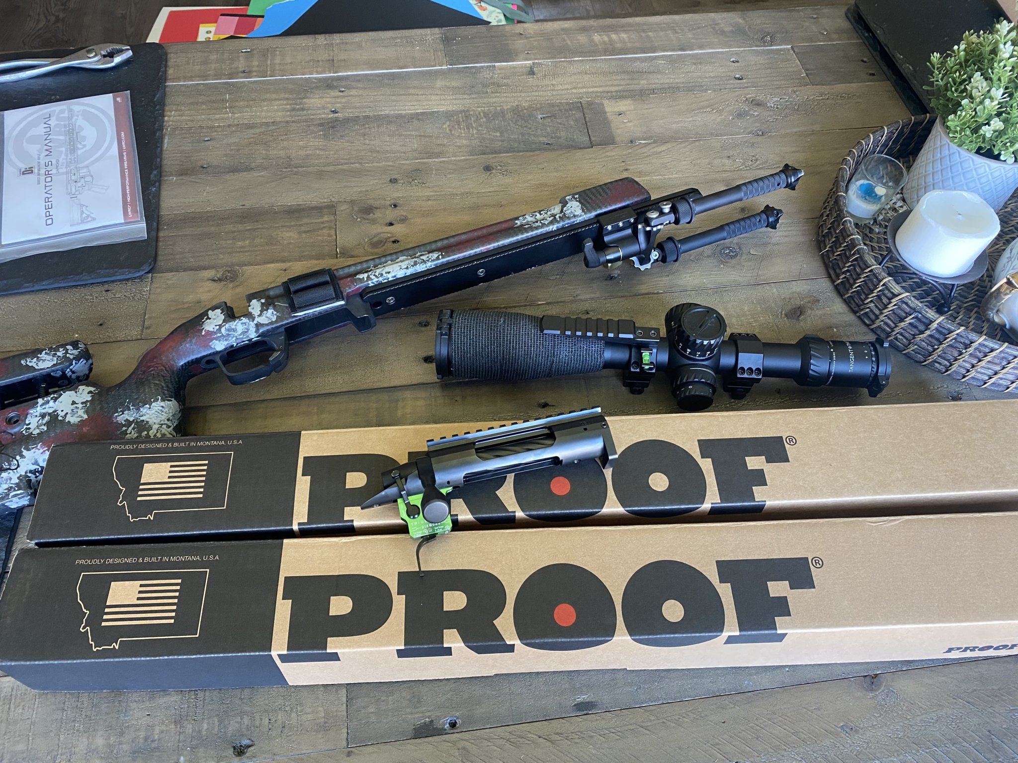

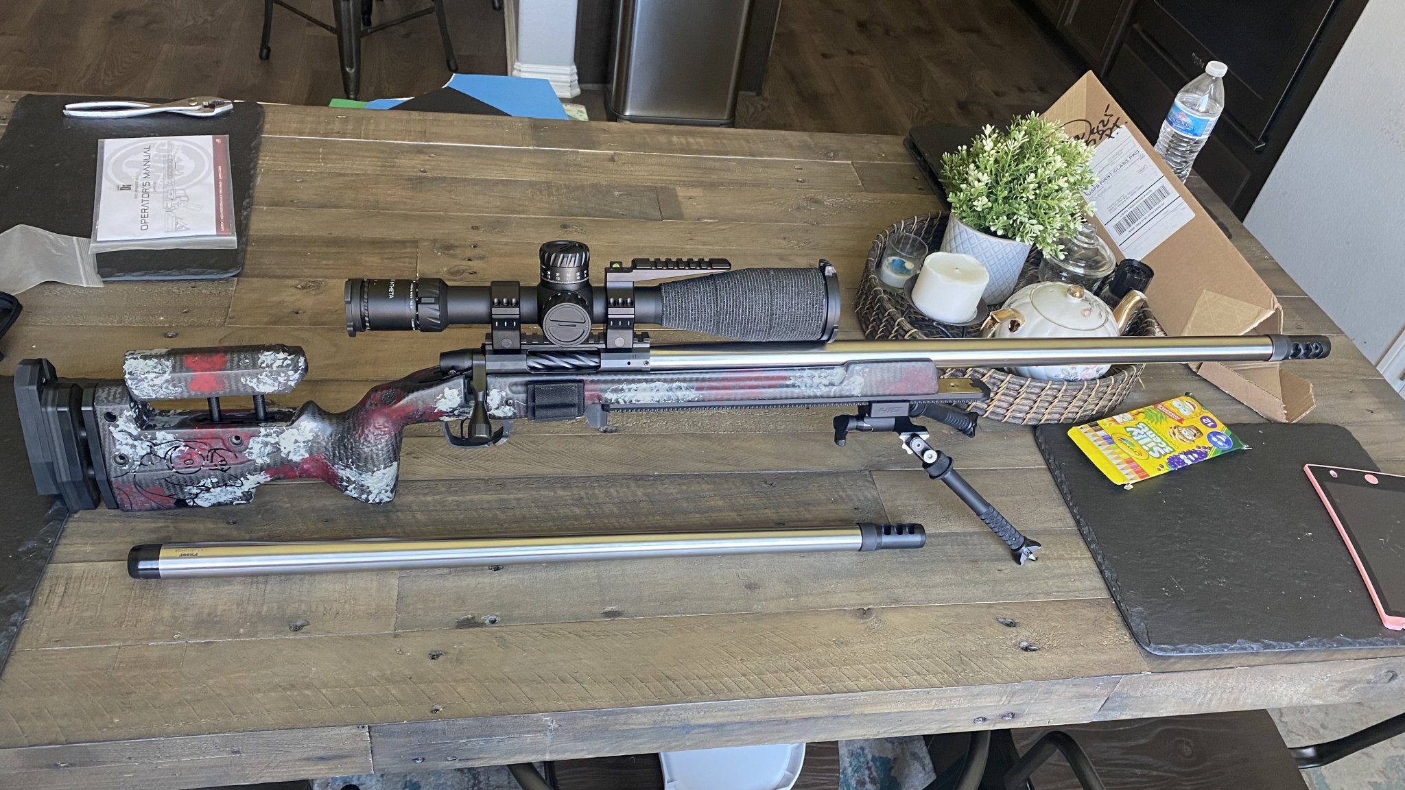

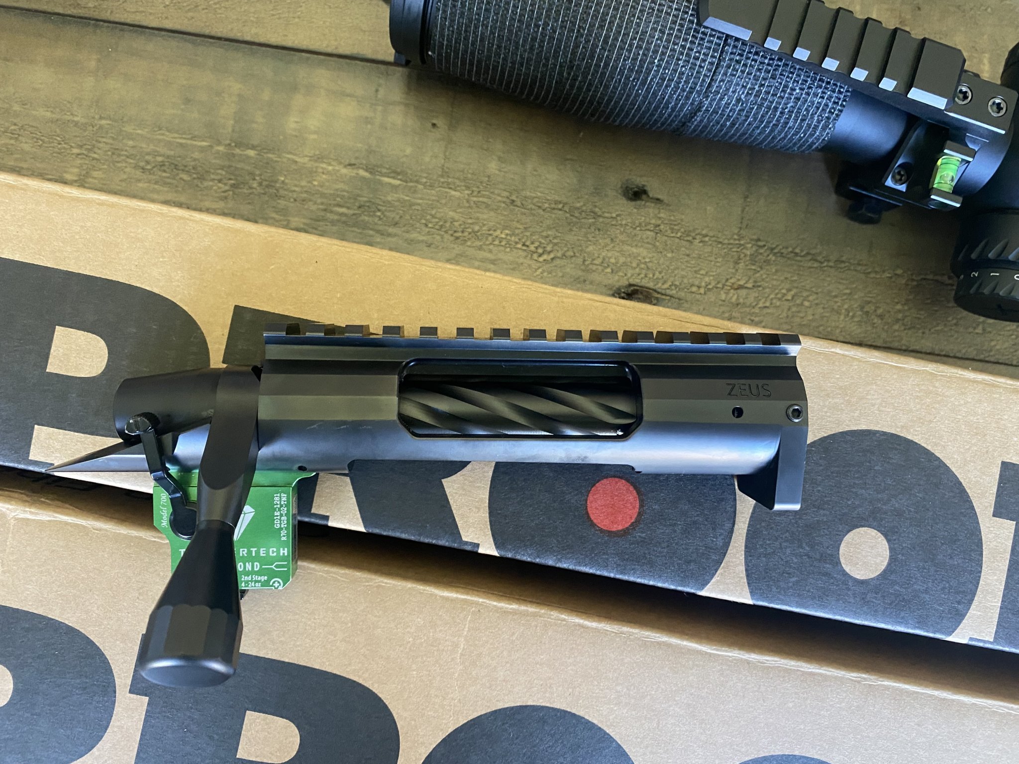

The Zeus action is awesome but I don’t have a QC action. I wouldn’t trust that setscrew. Not at a PRS comp anyways. If it works for others then cool. I have trust issues so mines getting torqued. It hasn’t failed me and I doubt anyone else has experience a failure. The beauty of the Zeus or any other custom action is you get to choose a lot of combinations of parts and they also offer different bolts too. You could even get an ATX chassis for it.

You can't go wrong with either. Both actions are built like tanks, the Zeus does have a slightly lighter bolt lift and it will throw itself into battery. Hope that helps?
LOL, that's the best way I've seen it described on the Zeus... I swear sometimes the bolt pulls itself forward and closes itself its so fast. And I'm talking about the long action.
