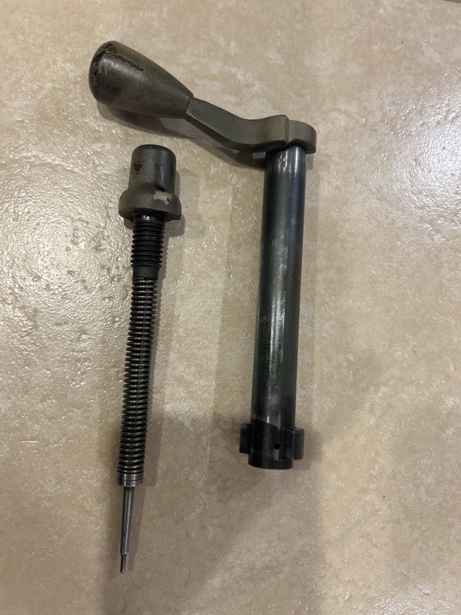

Go through your bolt. Pull it down and inspect everything. If it has the J lock firing pin assembly toss it and get a complete pin assembly from Gretan.
I read a post here from LRI about going through the fire control on the 700's. In some of his posts he was describing the issues I was having to a T. He uses a 27/64" chucking reamer to make sure there is no interference with the firing pin and bolt body. (In my case there was) Check the fit between the bolt shroud and firing pin also. You don't want any drag there. No coil binding on the spring either. There are some things you can do to the shroud to improve it but it requires a lathe. Cortina precision sells some modified shrouds also.
I say all that because I had a problem 700 of my own. Chased my tail with it off an on for years. Had it rebarreled three times. When the third barrel presented the same issues I started digging in here and on youtube. After sorting the issues out, the same ammo that struggled to consistently shoot .75 moa shot a .3xx. I've gone through the fire control on all my 700's now and it improved every one of them.
I appreciate all the help gents. I didn’t even know this was a thing. Now that I think about it, it makes sense. Time to take that rascal apart and look.
Seems ok…
Seems ok…
Make sure it's clean and clear inside the body. The bolt heads are soldered on and excess solder can be inside the bolt causing a problem. That was the case on my long action 700. The chucking reamer in a drill fixed it. All my other bolts were good in that regard. One had a J lock assembly, the other had a spring binding on the firing pin.
Disassemble the pin assembly and make sure there is no drag on the spring/pin and the pin should slip through the shroud with no resistance also.

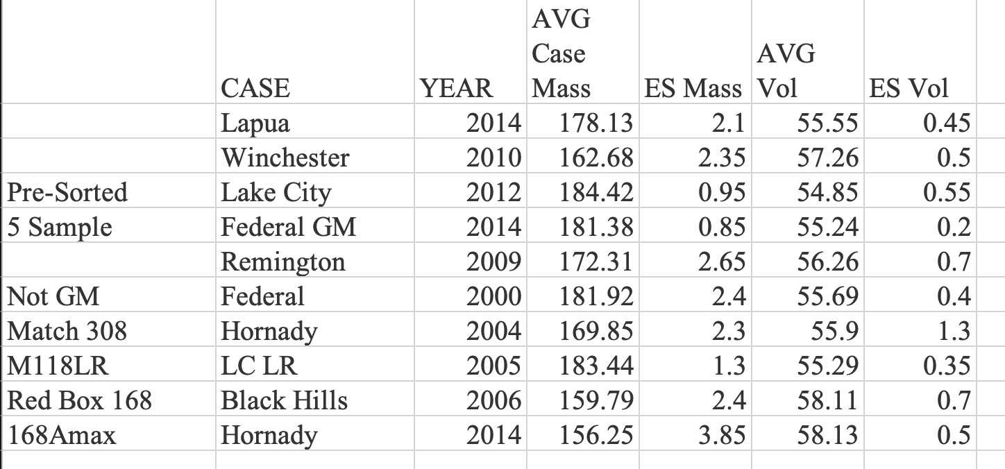

Here is some case data from about 10 years ago for reference. The Black Hills brass was Olin/Winchester and we believed that the Hornady was also that at the time but could not verify.
Reactions: kaskin and sinister
Just FYI: For anyone looking at this chart for "Federal GM" and "Not GM", according to the person I talked to at Federal, just a few years ago, when I called and asked what the difference was in their process, he advised that there is no difference in the cases as they all come off the same production line and there's no sorting to get cases that are more uniform than others. The difference you see in this chart is simply the variation one will see in production from one lot to another.

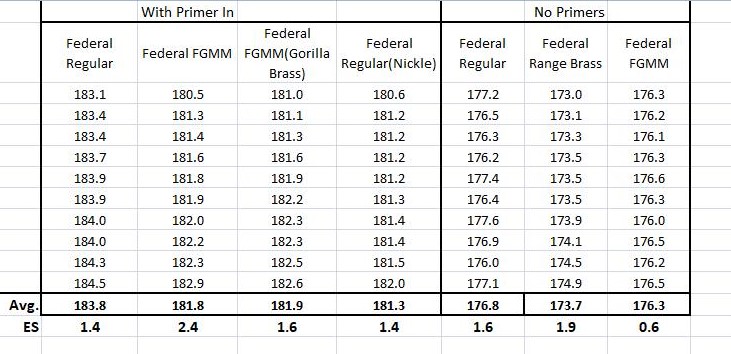

Here some data I've collected for the Federal brass that I've used (those designated with FGMM were from factory boxes of 20, the rest were once fired range brass some of which were also FGMM):
Reactions: Doom
This is great information. Part of the reason I love this forum... There would be a very slim chance, if any, of me finding this out on my own...
