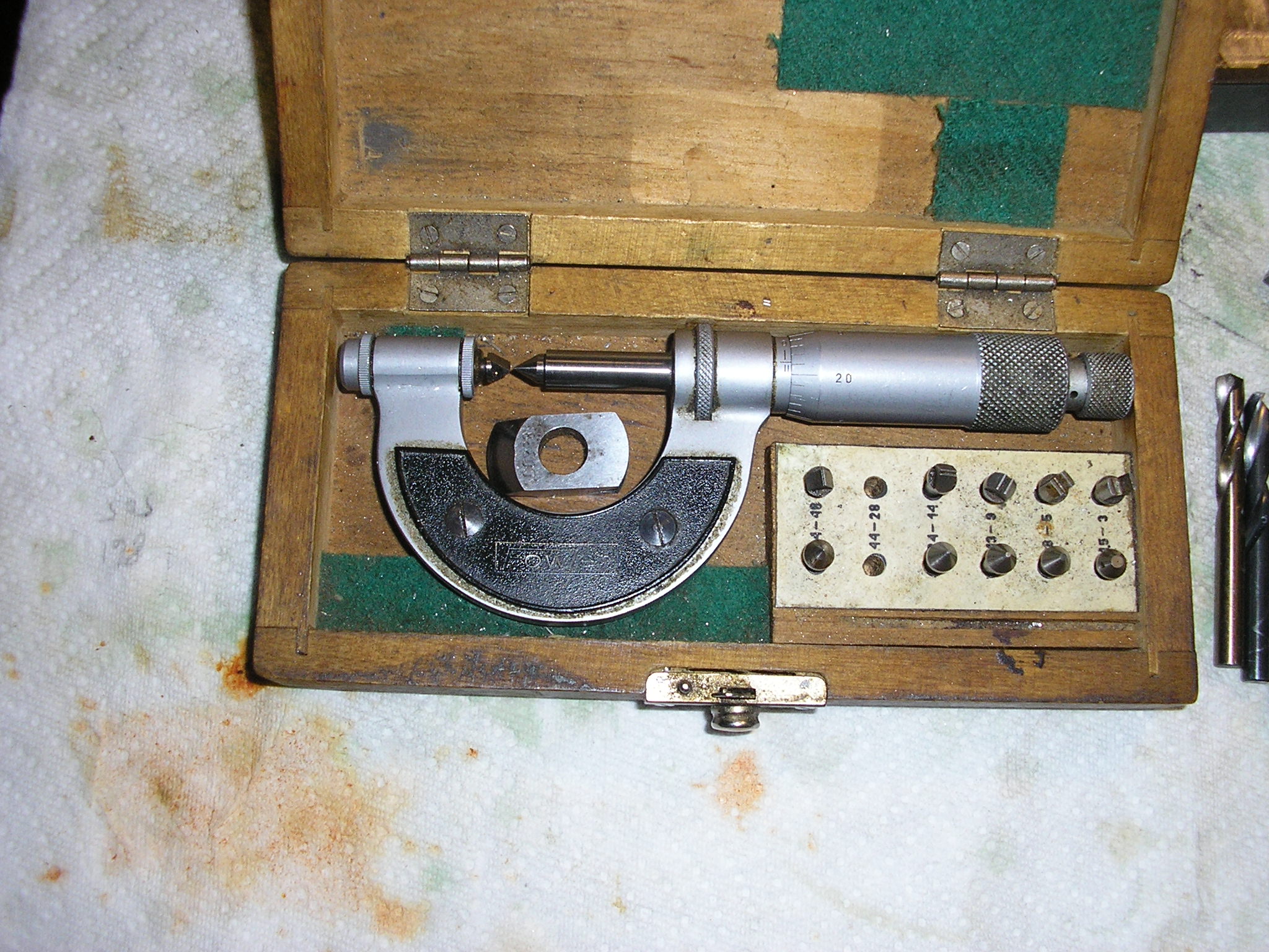

you can simply measure your barrel threads using thread wires and a mic. 5/8-24 unef class 3a should measure .6339 max over .024 wires. any gunsmith that has a lathe should have them. sometimes the crest of the thread can be cleaned up with 600grt emery cloth and it will sometimes go right on.

I highly recommend you have one of these in your inspection department. They aren't cheap, but they remove all doubt on thread size.
Is there an echo in here?
Also, a pitch mic isn't much help for inspecting internal threads.
Sorry for the repeat. The bad thing about internal threads is that you can't check the profile on the optical comparator or under a microscope. Gauges are about all you can do once you've established that your tools are properly mounted in the machine. Gauges can wear, and the pitch mic can let you know their condition.

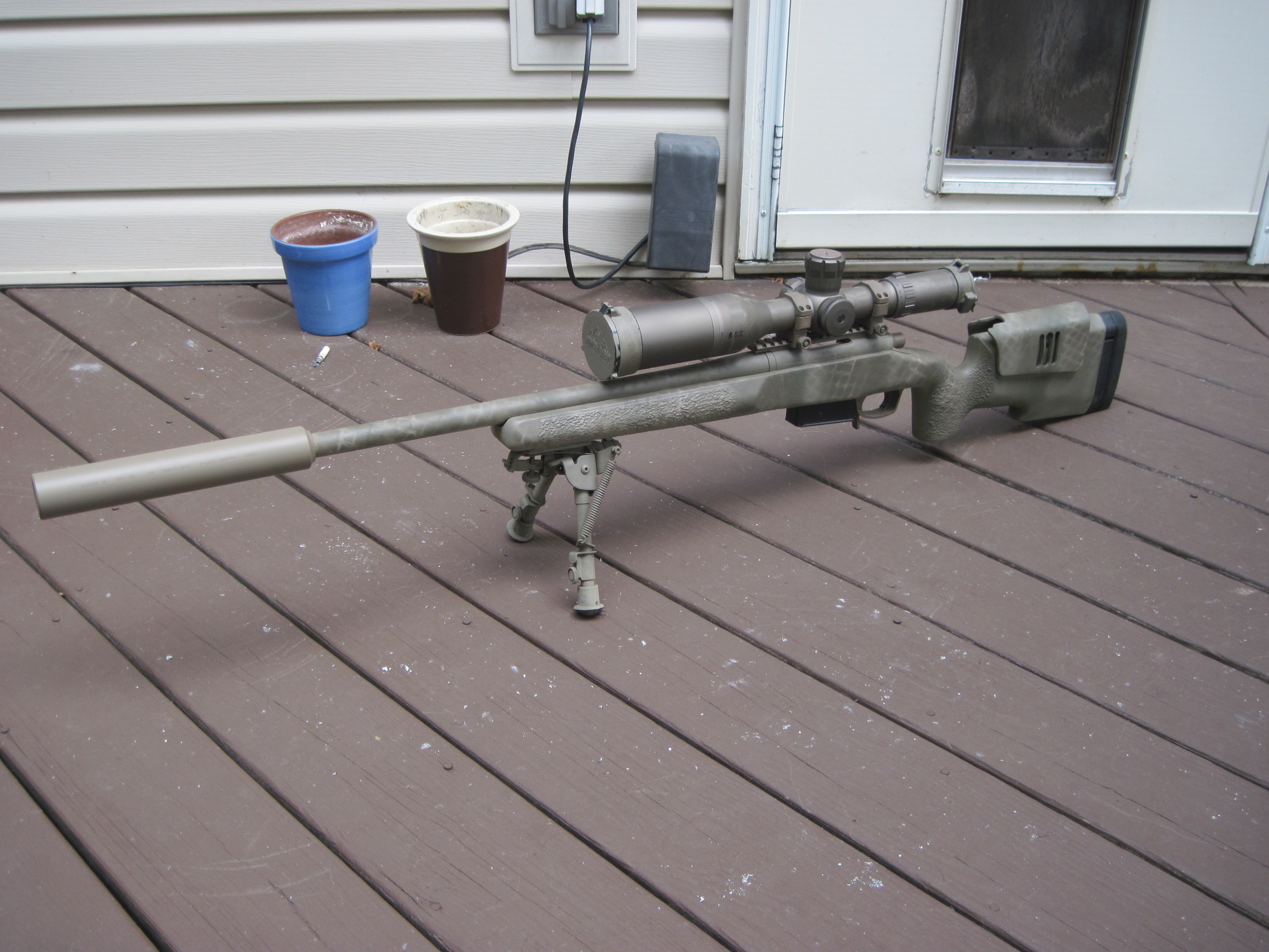

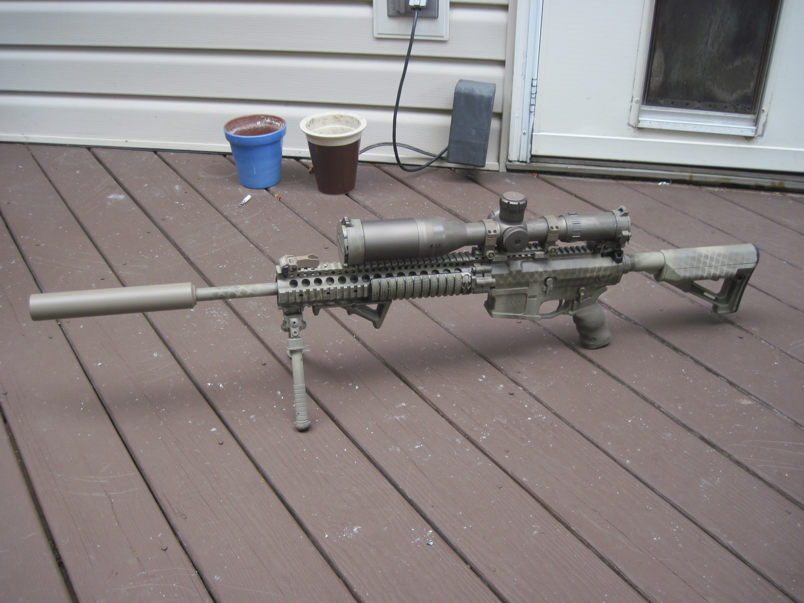

Update on situation - My suppressor arrived today at Thunderbeast Arms. Got a call an hr after it arrived, according to UPS, from William with TBAC, explaining the situation. Apparently there was a bur in the the third thread that was probably caused from my over sized threads on my stock rem barrel (apparently it doesn't take much force to cause it, on fresh threads) This would explain why it was not threading on any other rifle either. He said he cleaned it up and re checked with a go and no gauge and told me I had two options: Basically get it completely re threaded or get it overnight shipped to me today. He told me that with the threads cleaned up and checked, it will thread on fine with a class 3 thread spec, so I went with that option. On top of that he said he would personally get my threads fixed at just the cost of using the shop machines in order to help me if I couldn't find a competent gunsmith. So even though my experience has sucked ass...Thunderbeast's customer service has been some of the best I've ever dealt with, period. I will keep everyone posted after I get my barrels re-threaded.
WTF are you doing at home on the computer posting on Snipershide? Get to the range and shoot that thang!!! My 30P absolutely rocks on my 300winmag. People at the range can't believe I'm shooting full power magnum loads from it.
Lol I'm working up loads for them atm. Taking them out this Thursday, to do ladder test.
