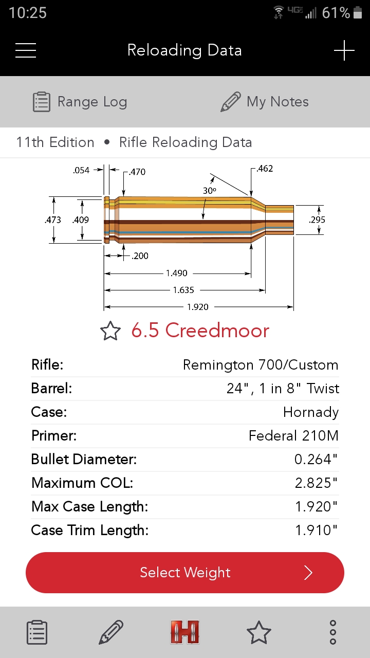

    The Hornady manual lists a max length and a trim length. They are typically .01 apart. You want all cases to be the same length, but pretty much anything between those two works. Attached a screenshot of 6.5 Creed as an example.
