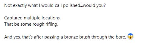

Question came up...How do you know it's not just the lead causing the smoothing?
Had to think about it to maybe provide an answer.
Air rifles use lead pellets at a decent fps.
Do pellet rifles show smoothing of the rifling?
No burn residue involved.
I've never seen the inside of my Crosman 1322 air pistol barrel before...it ain't pretty. :(
This ones had about 3 tins of 14 grain 22 pellets through it. 1500 shots
I don't see any signs of smoothing...yikes.
Good thing it's only used at less than 10 yards.
qLlBx4MuTmKjSfb6L6ZS51yesNGony7wv2Umf4I15B1GU0MfDSmfaPHko72m8wVyQDyhmA3OdQhEY2QZGCCxhmR0-6NYpQxxn7zu0_wxzK52RjqX9Talf2MZqGWqtDz8pIW4ieB0oqnpO9me9dNjfHXPBq5dIp28xn5rbr4u6xd81gS1U9IpcLFqLJqzqApBv5qq_GSE01pCEQBAW3zzXBgXnLmczvlhRBJeMbjTQ0d78hPoXQEljS5j8VIx_XYUJBnI_rgcy2LU28sb44OTRqlrQK2zm5-Zbp5uDgJoRpfZAnc8-Gqs5awKj_KQ7lyQLLOaWfIdViBSgta44BG5uOZVZy9KIE-mCeV_L1JvGG5Tbe2sPDitOVosMohIaT_6N4oAvCa4Oy2cJd4vzfTrO1Dekp2lKskQoljN1aDASP5toSCl_Q4H4XiFqMR45XigJ3b1vZovGyXW1e--1UfvZZB82GkdnSmFoJAnLmdy4t8S5uVITpWABRdnOhYJQvBqQkkLG0EvrJdV3mBfglArp6k4us4QbgEySxP7CoqFyNZNWPLQp_vTxThNDwdClqsC7HbCCr1sYCGLcVxb5NzkefR35xuWiKYqTyo4LWgd4BdC7X0JN-i8MP7C0QMqrQJElGD5c7ex6I-rO1ZAb0bKqKRxIJZ3224inJJ_UylvjRzupRIu3rcG27had9mo=w872-h654-no
Not exactly what I would call polished...would you?
Captured multiple locations.
That be some rough rifling.
And yes, that's after passing a bronze brush through the bore. :eek:
Link to the rest of the images https://photos.app.goo.gl/ZBBV82v6WindM7Ef6
Not sure a Crosman barrel is a fair comparison to a competition SS barrel used in an air rifle for Benchrest.
Maybe not, but if you want to see if lead rubbing on steel will smooth out the imperfections,
I'd offer that after 1500 pellets down the bore, it don't look like they do much smoothing. :D
Justin....do you realize the bore is probably not rough, you cannot tell, that’s a badly leaded bore.
pellets or 22 slugs, until you learn to comprehensively clean to bare metal, every time you stick that camera in there, it is apples to oranges.
Tim, I knew you were going to point out my cleaning technique. :D
That's why I added the note regarding how it was cleaned.
That's not leading of the rifling. It was cleaned with solvent and a bronze brush.
That is the actual steel finish of the barrel...that's some seriously poor rifling.
I do know how to clean a barrel. Not a totally ignorant amateur on this side of the keyboard. ;)
Since when does bad rifling have deposits ON TOP of the underlying metal ? Any crap barrel fish yields tool marks, inclusions, rough finish INTO the steel, not on top of the steel and since it's probably lead, you can brush it until your freaking arm falls off without much improvement when it gets bad. That's why they make specific lead remover like No Lead. Different approaches for different issues.
Youse gots lots of learning to do.
