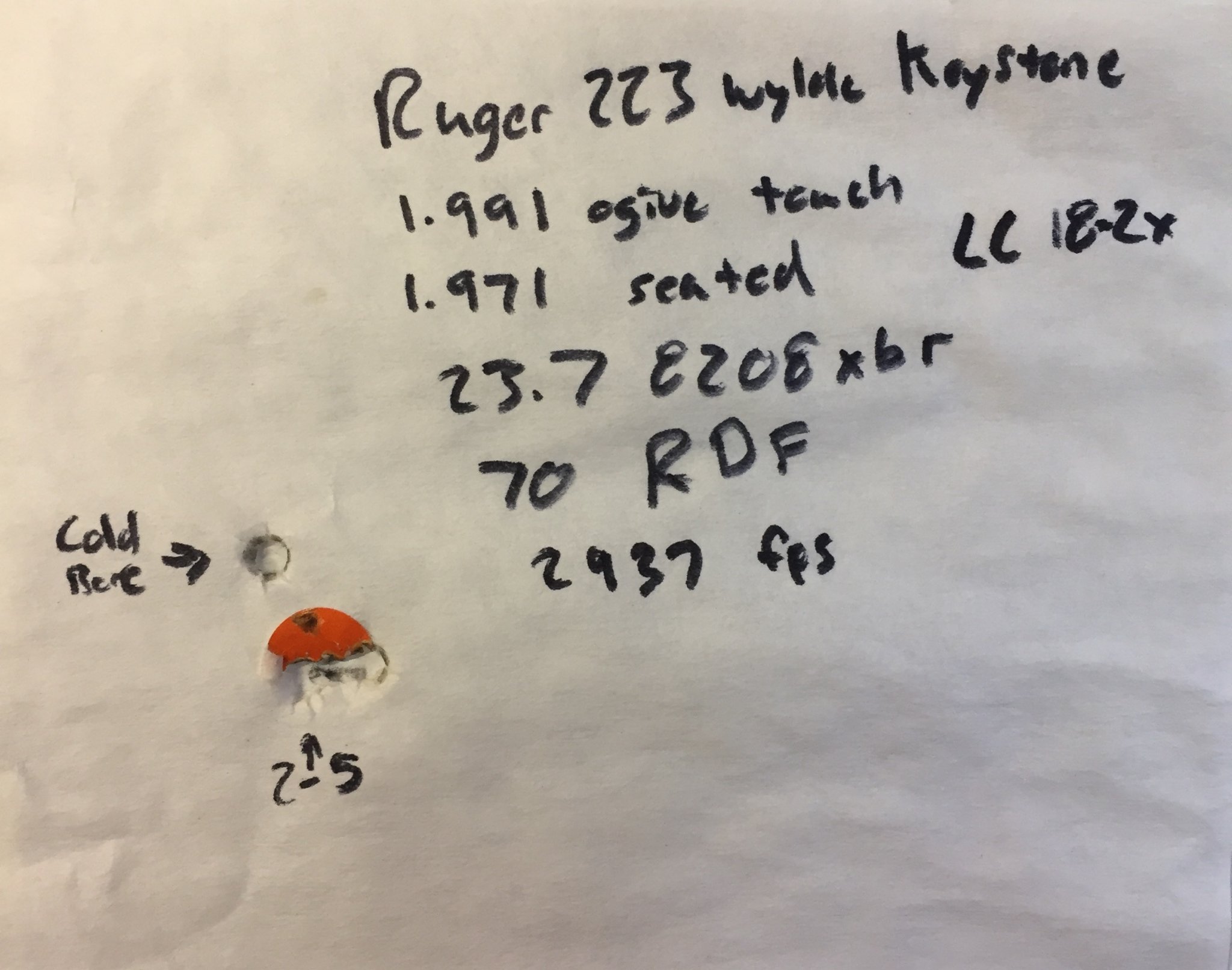

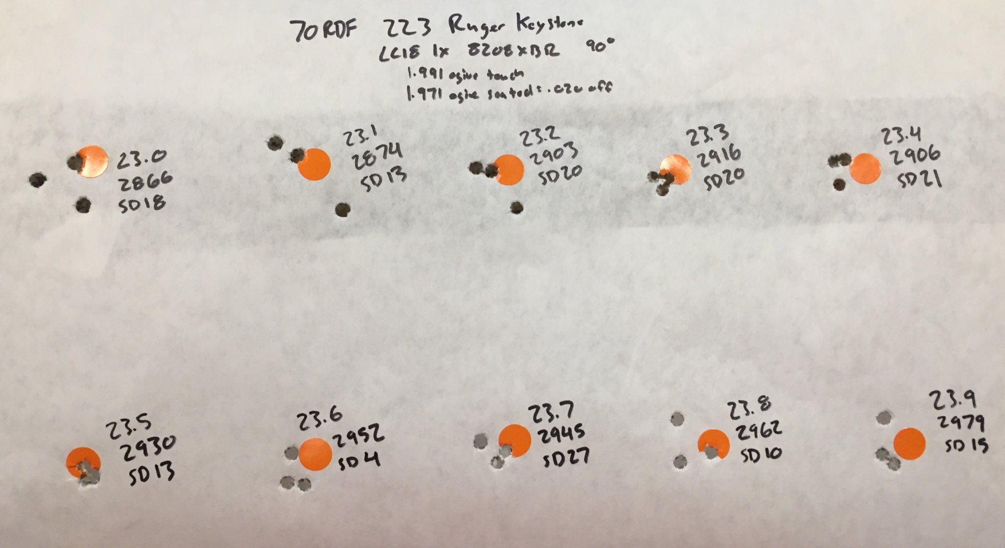

I found a good node with TAC at 24 grains, moving the bullet at 2700 FPS out of my Noveske with a 16" barrel. Im loading some up for friday and will try them in my 3 AR rifles.

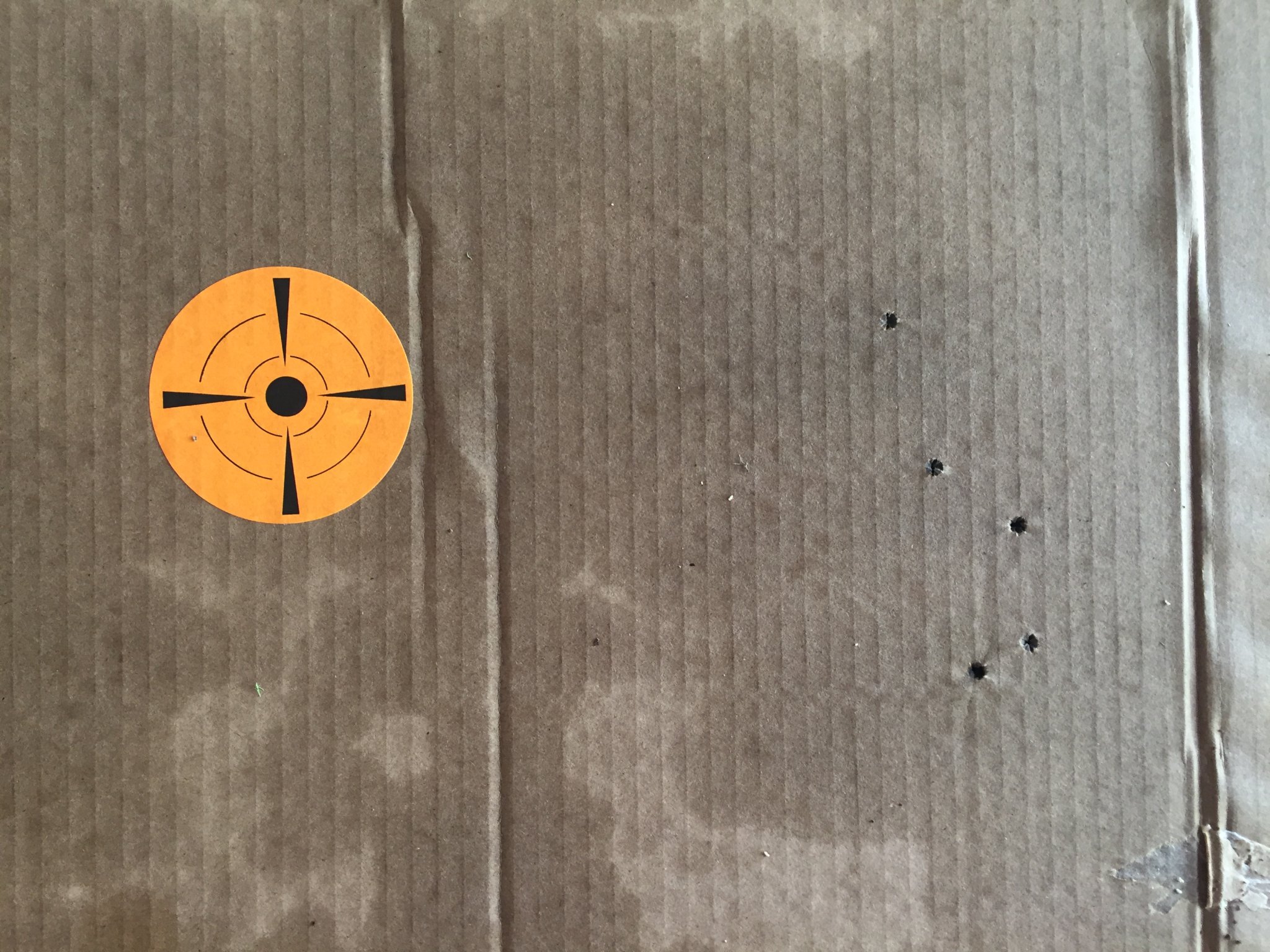

The new rifle I built and tested these in.
First OCW

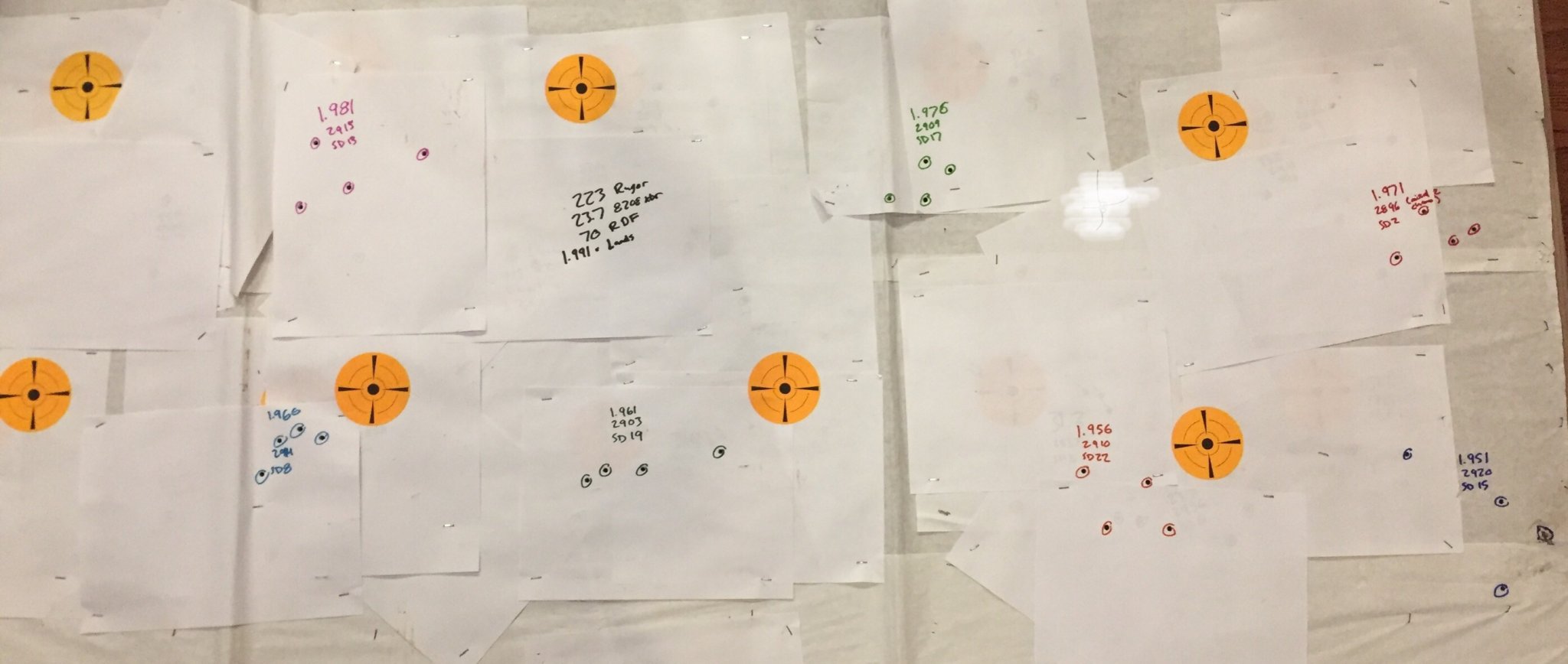

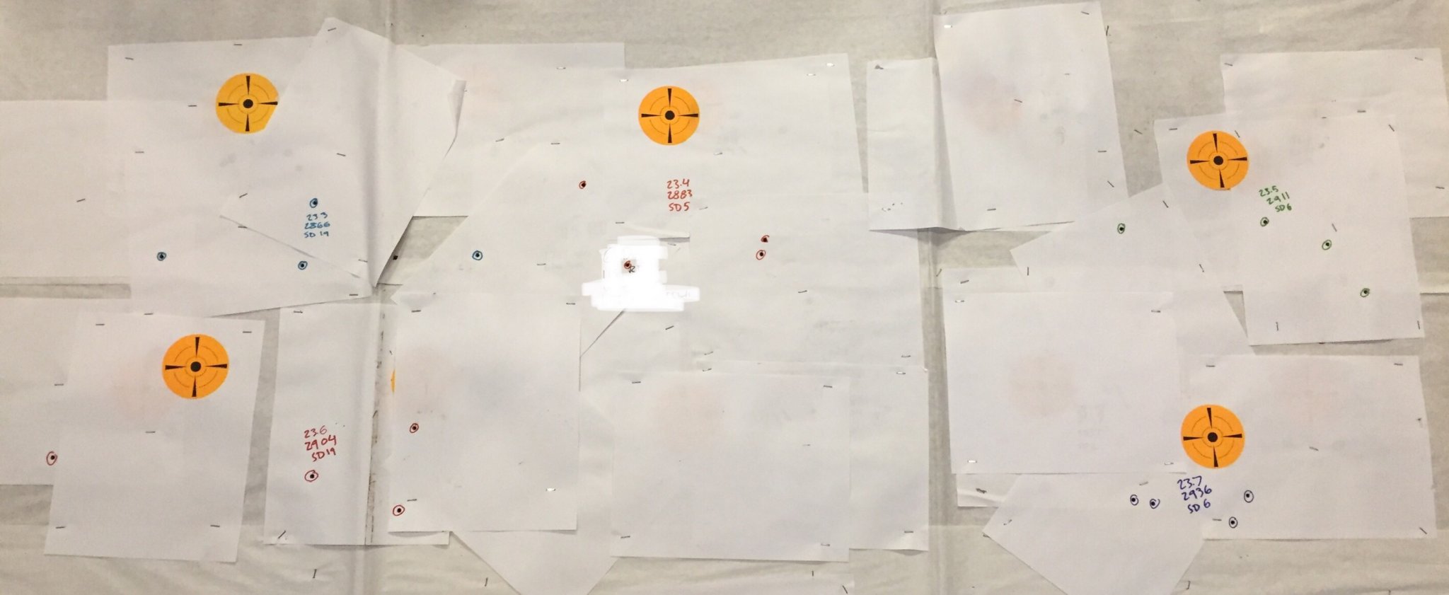

Narrowing down at 500
Seating depth at 500
100 yard verification
500 yd verification-called the high one but I expected it to be way further out so...
