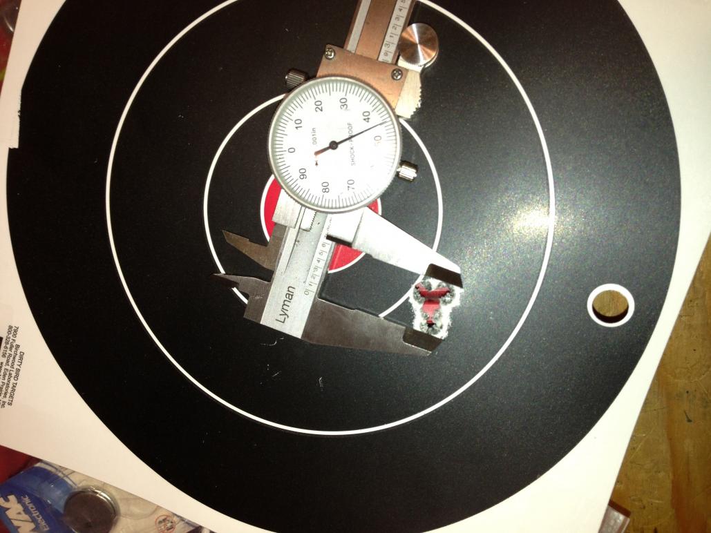

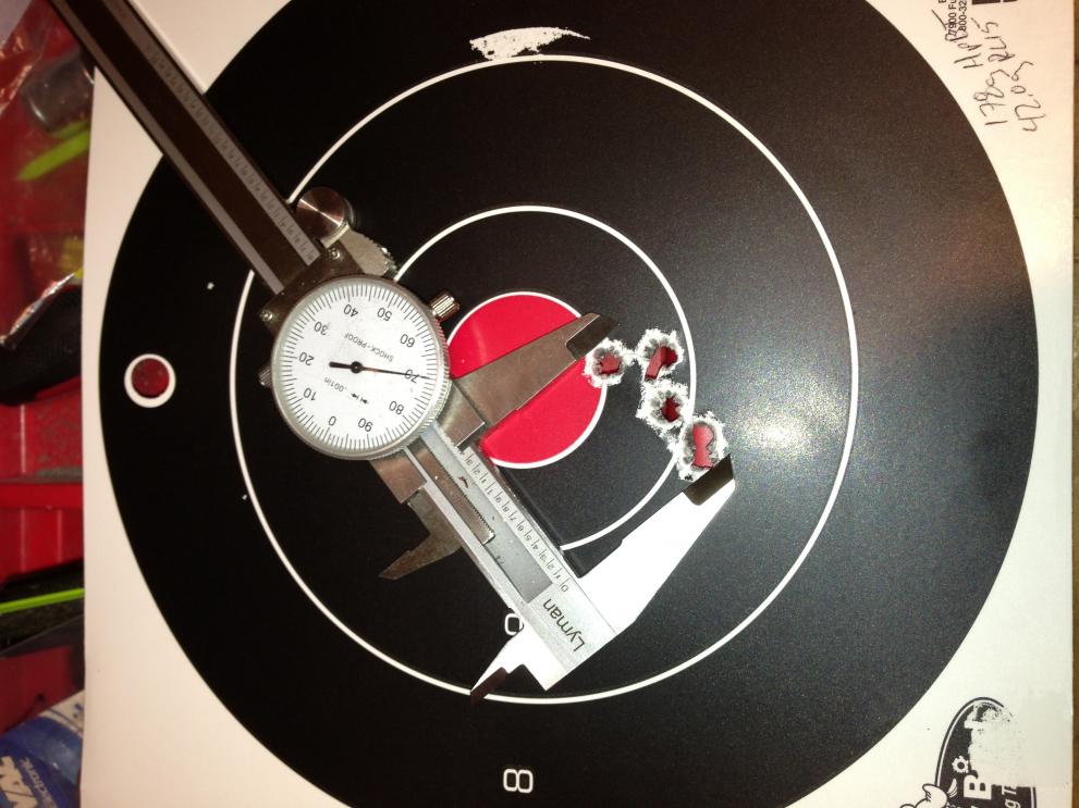

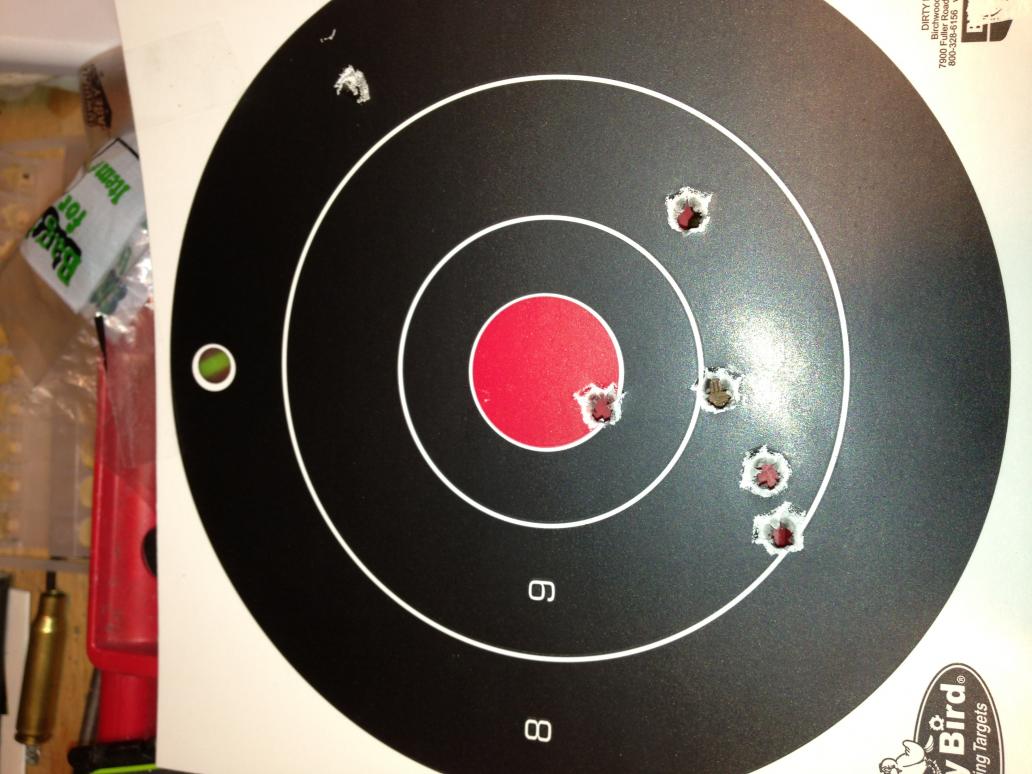

So.... I did not have any Flitz, some of the maintenance guys I BS with at work gave me some valve lapping compound to try. I looked at it and it was WAY to course for my liking. Looking around I found some of the green polishing compound that comes in those Dremel multi kits. I took a piece of it and made a liquid paste with some WD40, used it to polish the barrel with about 10 strokes or so. Then cleaned really well.
I then loaded up and headed out. Tried the 175SMK with 43.5gr of Varget that is my standard go to load in my savages. As you can see I got the "shotgun" effect that I have been getting all along. I was a bit discouraged.
I then tried the 168SMK with 42.0 gr of RL15..... Holy Shit! 0.337 MOA! On the first group of 5 rounds. I did the last five of the 10 I loaded just to prove it wasn't a fluke and got 0.455 MOA!
I then tried some of the Hornady 178 gr HPBT I had with the RL15, now it wasn't as great as I got a 1.057 MOA, but to point out this bullet was the worst with Varget... Around 3-4 MOA....
YOU GUYS ROCK......
