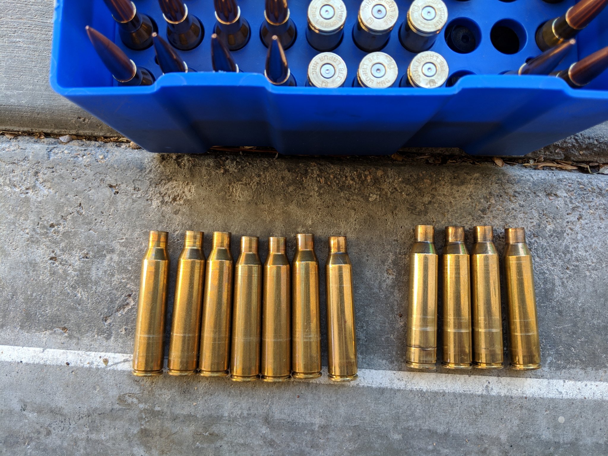

    Never had any issues with my 338 LM Lapua Brass...7-8 firings (Left cases).
    Bought what was allegedly 338 LM Lapua Brass 1x fired. Below are the results (Right cases).

    @Strykervet So let me clarify, I do my due diligence sometimes that is not enough. I got pictures and asked the right questions. The member got the brass from a friend he was getting some brass also for his personal use. He doesn't have a 338 or his friend doesn't seem to reload. Everything looked good. I loaded them and fired them, the 4 on the right are my first firing (the brass allegedly second) for that brass. I loaded and fired 10 pieces prior to the components, no issues. I have a few things I need to do to the other 120 pieces before I fully discard the lot. Definitely a lesson and wanted to at least bring awareness. Thanks for the comments.

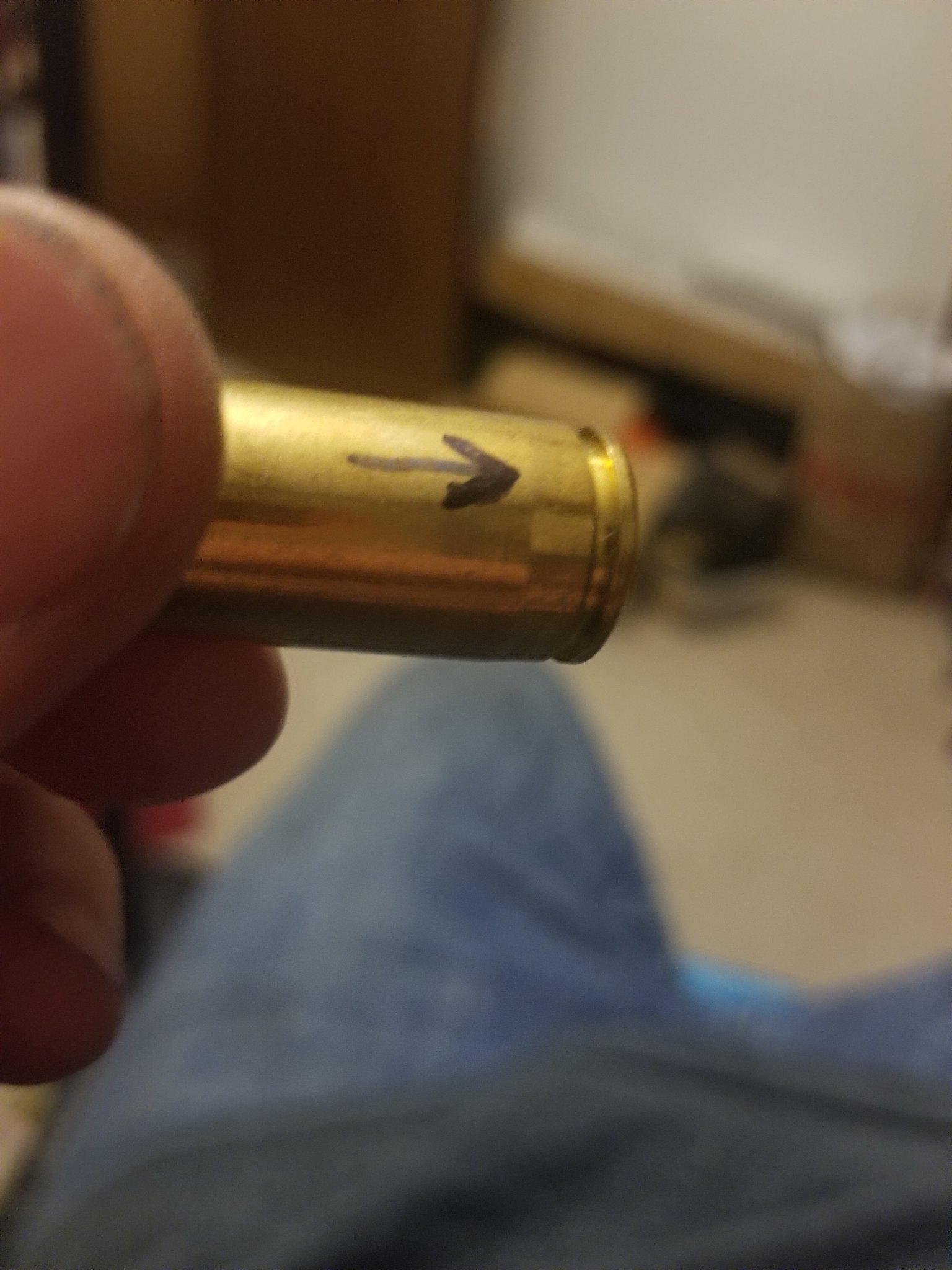

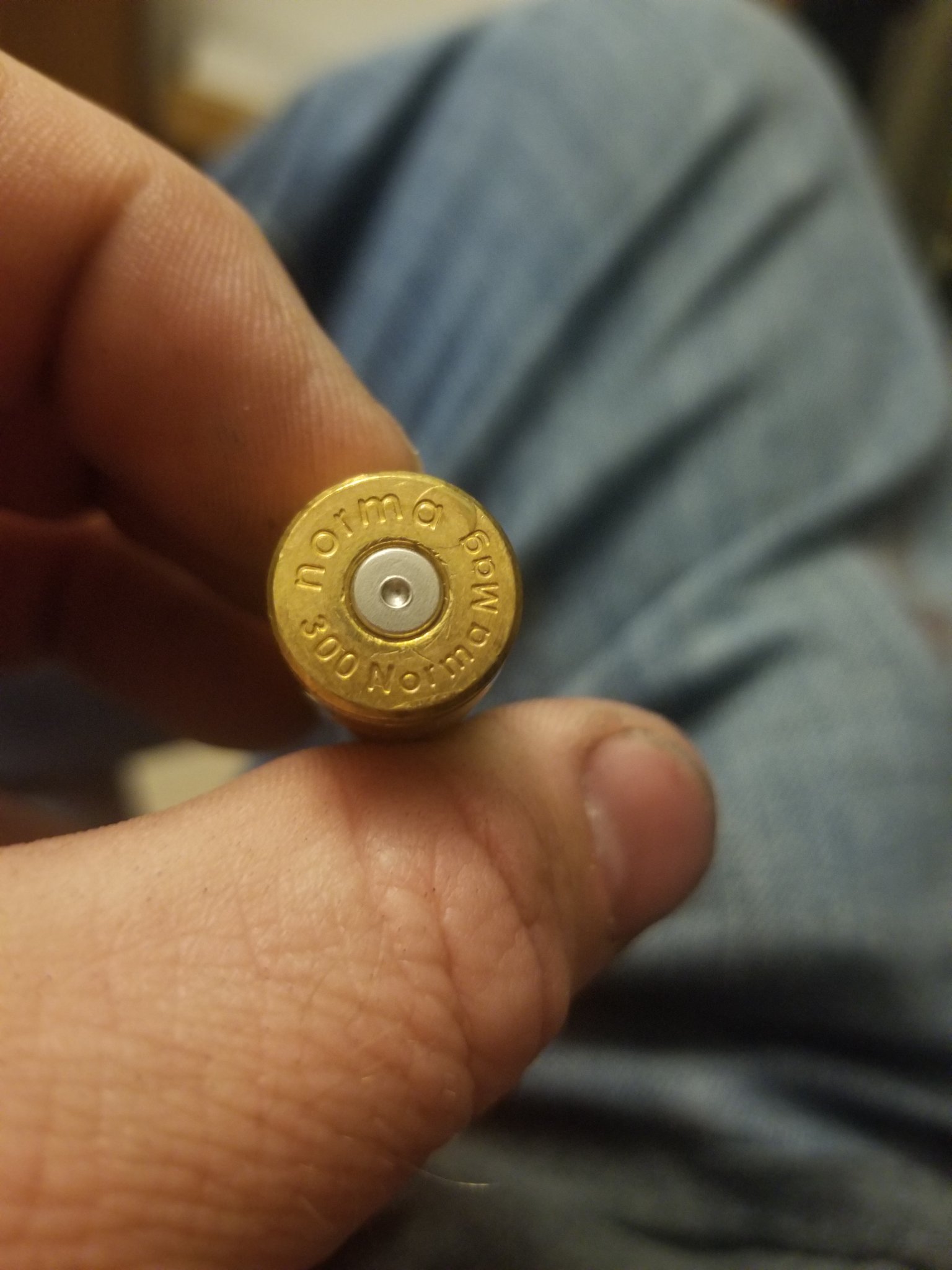

    I got some once fired brass from a friend and it was junk. This is factory ammo that was once fired and the case was swollen above the web and had some pretty bad extractor marks.

    The question is how much headspace did it have for the first virgin firing, and how much headspace did the brass have in your chamber when you fired it?
    Also, were the primer pockets tight when you seated the primers? That's another indicator of how the brass has been treated previously and whether it's truly 1x fired.

    If you have brass that is already sized 11 thou from "fired" headspace dimensions, I would personally want to fire form it properly before using further. That could most easily be done by jamming a bullet hard into the lands (hard enough so that bolt close is moderately difficult) with a reduced powder charge. That will hold the case head firmly against the bolt face and allow the brass shoulder to expand and conform to the chamber. If you shoot brass with that much headspace without jamming a bullet, the case will be forward in the chamber. When it fires it expands horizontally and grips the chamber walls, then the rear of the case expands backwards to meet the bolt face pulling brass from the side walls and potentially causing the case head separation that you see.

    You may be able to cheat a little out of it by sizing again with a fl or body die, but keep the die from touching the shoulder. Will depend on your die vs the die used by the other guy.
