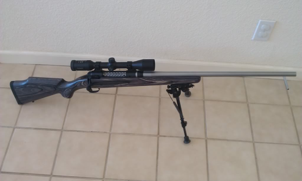

Man that barrel nut is so ugly..lol once its altogether it doesn’t even catch my eye. Here is mine i did on my own. Had Pac-Nor cut me a nice barrel and the the rest was my own...i enjoying being able to do things in my own garage. But it was a long action so parts and what not were limited. All in all it’s a nice hunting rifle
