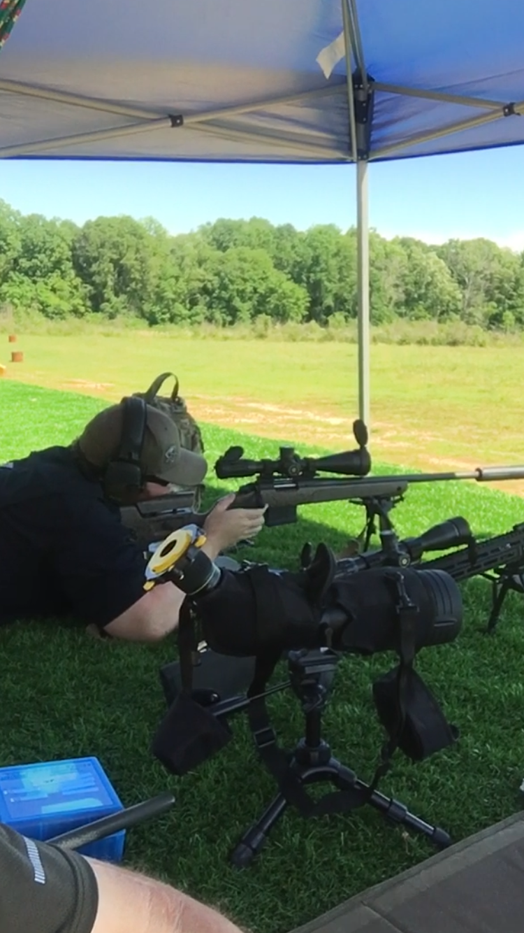

I spotted for a guy using one chambered in .308. He was hitting the 1224 yard target easily with it. The action looked smooth. Btw he was using 168 grain bullets. He said that’s the farthest he’s ever shot a .308.
