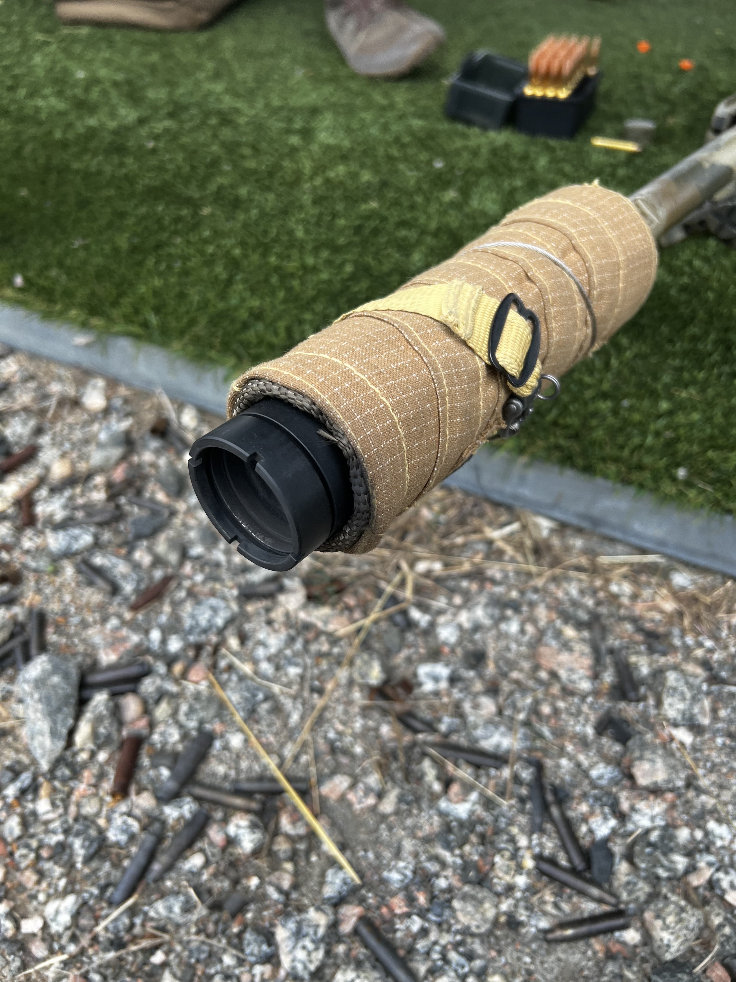

I was out shooting with a buddy today lobbing some 300 PRC at a mile when about 50 rounds in his RR brake module shot off the front off his Magnus suppressor. Unfortunately we were unable to retrieve the brake as it got lost down the hill at the range. I was curious if anyone else has had this issues before (If so did they warranty the brake and or provide any details as to why this might happen?). Dan, one of the guys that runs the range told me this is the third instance hes seen where one of the RR brakes shoot off. I also have a Magnus RR suppressor (~2000 rounds on it) and never had any issues with it. I did check, the brake was tightened down prior to shooting. Below is a picture of it after it shot off the rifle.

Hi,
This happens if the locking ring is not kept tight. The two causes of that happening are it simply not being tightened correctly, or carbon getting on the tapered mating surfaces preventing it from actually being tightened metal on metal (when the carbon disintegrates slack is created).
He should submit an RMA and we'll replace it, along with additional instructions on how best to tighten the RR locking ring.
The system was designed with a huge safety margin provided that the ring is tight.

Thank you Zak for the info will pass it along to my buddy!
