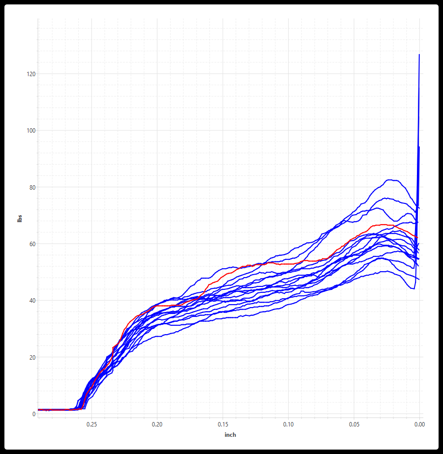

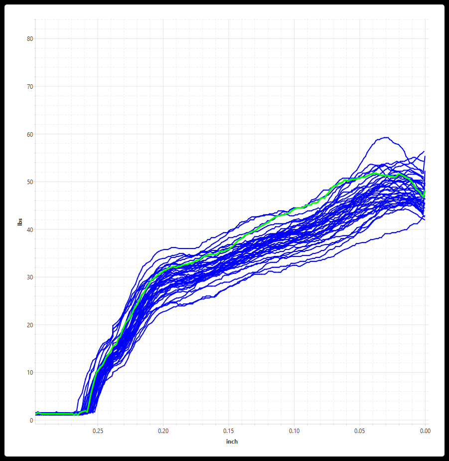

    Below are the graphs from the AMP Press showing the difference. I did 16 on process 1 and 46 on process 2.
    Process 1: Single neck lube before trim, primer, charge, etc.

    Process 2: Neck lube before trim, then second neck lube before primer, charge, etc.
    Notes:
    - On process 1, some of the plots spike at the end because I needed to re-zero the press height
    - You can see that the extra lube step on process 2 pretty dramatically brought in spread. It's about a 30lb spread on process 1 vs. a 16lb spread on process 2.
