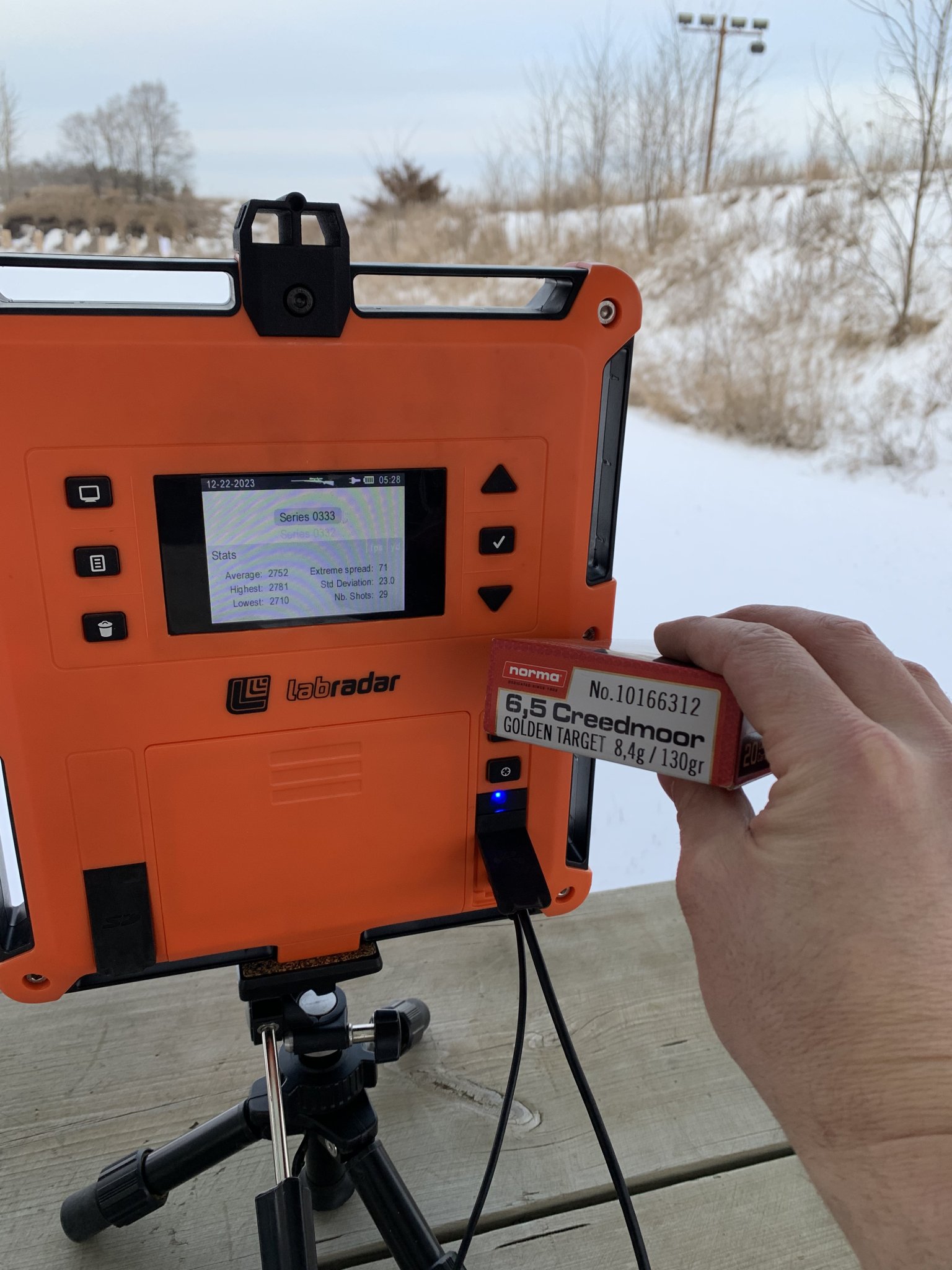

I knew this, but I was asking for numbers, for comparison to my numbers.
My CTR shoots AAC 140smk’s at around 2650.

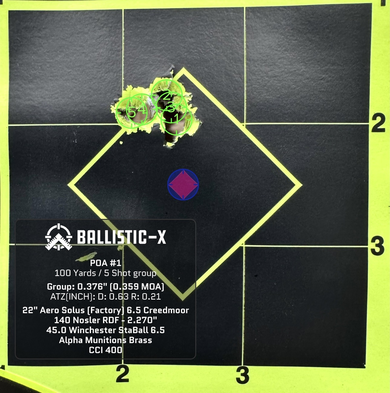

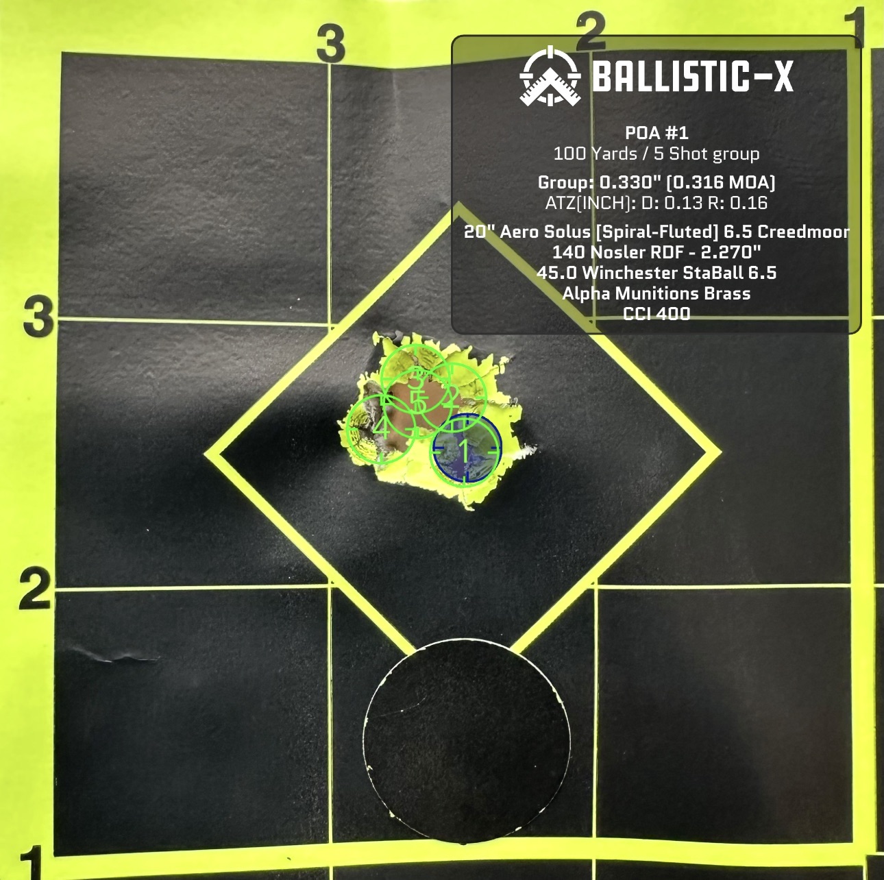

I have 2 Solus builds with factory Aero/BA barrels in 6.5CM, and I do handload. One barrel is a 20", the other a 22". Both are 1:8 twist. They both absolutely love the same exact load, same seating depth, etc... Makes life really easy. Both chambers were measured out, and the only difference in them, is that one of them the OAL to the lands is 0.001" longer. They're so close, I can even swap brass between them if I wanted to...I don't, just saying that I tested it, and they both fit neck-sized fire-formed brass into each other's chamber without any issue. Which would help explain a portion of why they like the same load...Consistency in chamber cutting.
With Nosler 140 RDF's, 45.0gr Staball 6.5, Alpha Munitions brass, and CCI 400's. With the 20" barrel, i'm averaging 2,795 FPS MV. And with the 22", I'm averaging 2,834 FPS MV same day, same Garmin Xero, same exact location, never moved the chrono.
Both loads shoot like this...

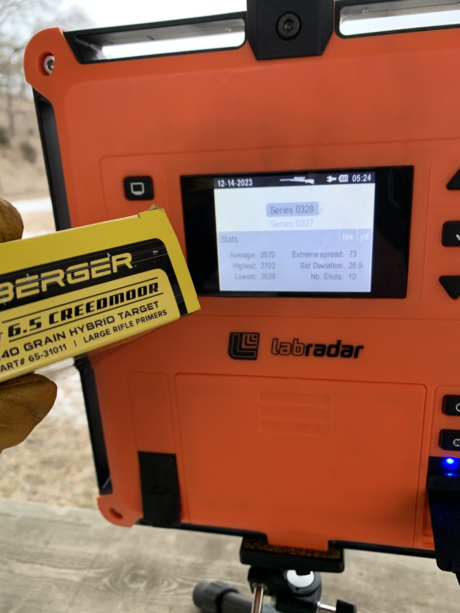

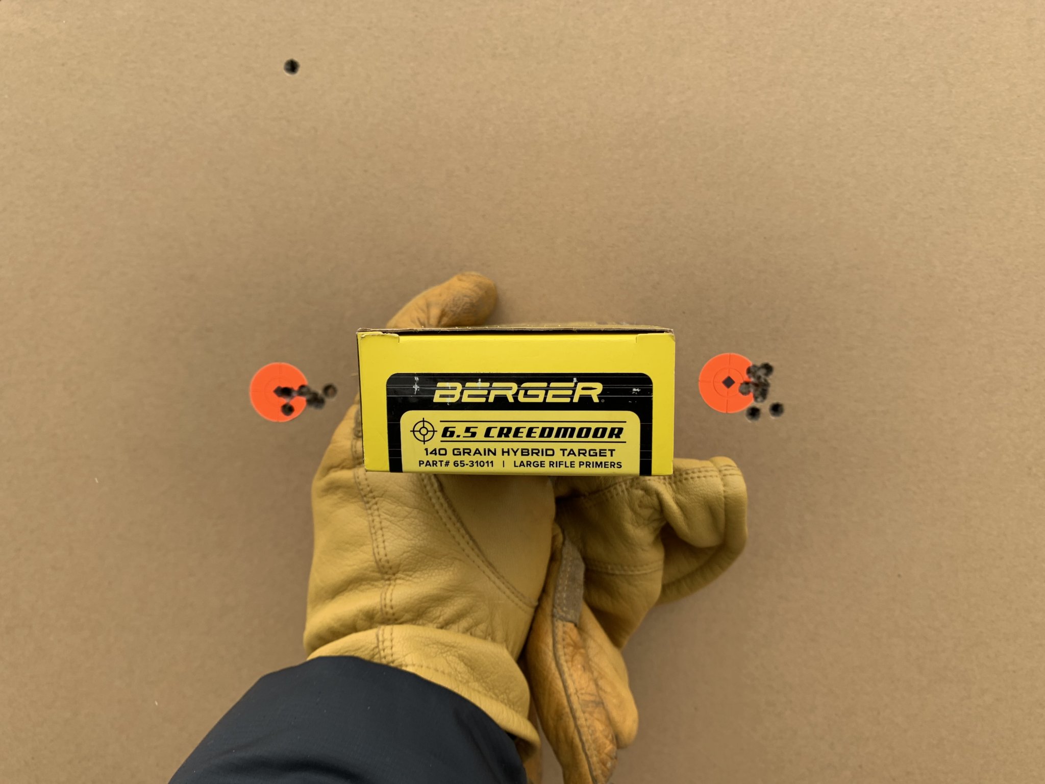

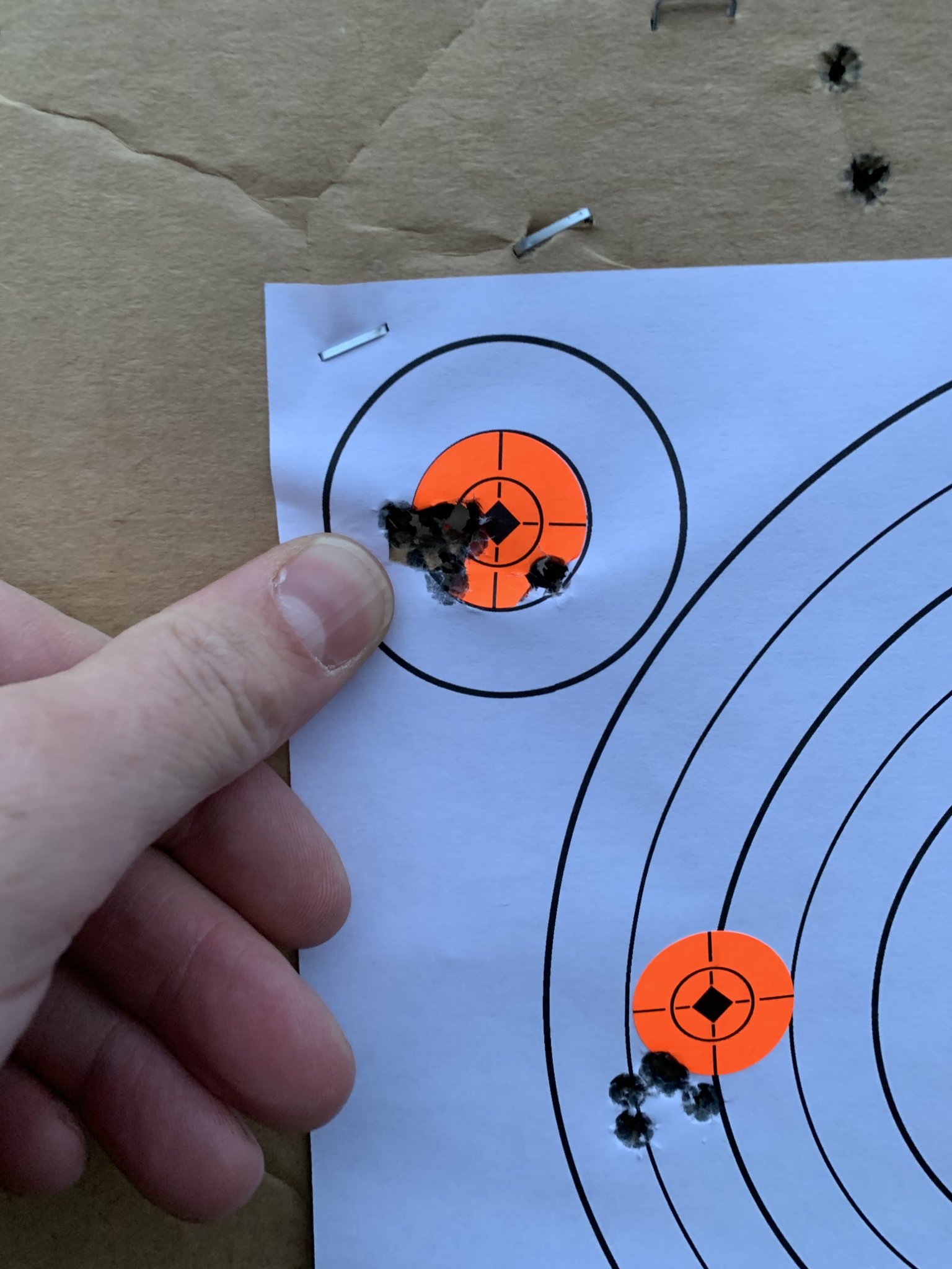

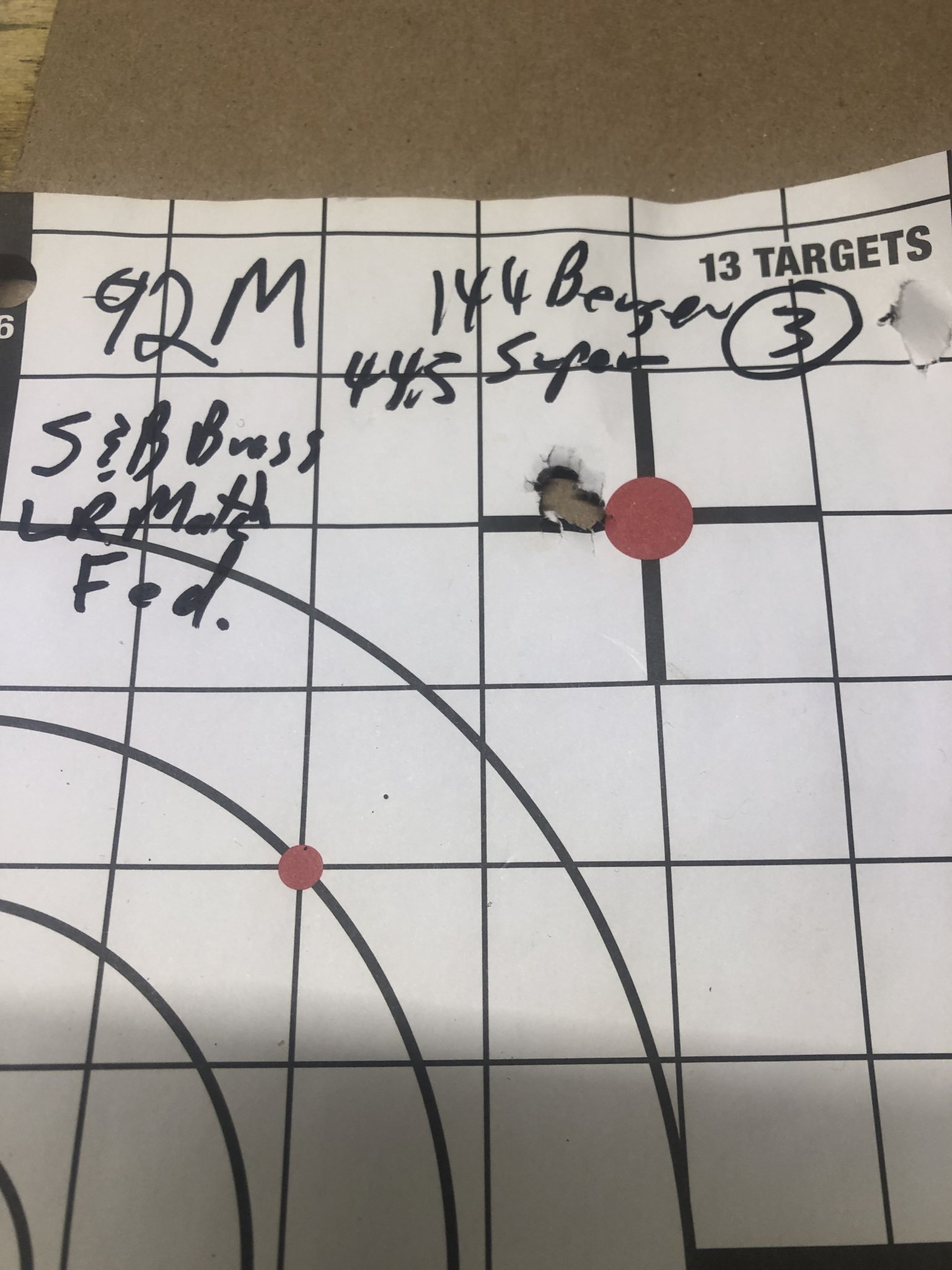

I’ve really considered hand loading but for as much as I shoot a season factory ammo is cheaper. But I was looking at either 135 or 153 Atips. But I don’t see a lot of people running either.
144 Bergers have done well for me.
