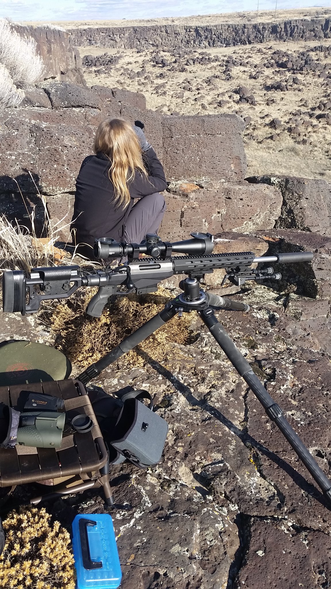

Yea…..he needs to give you that rail. Thats part of the chassis.
Ctr in tacA1 chassis….notice the rail
