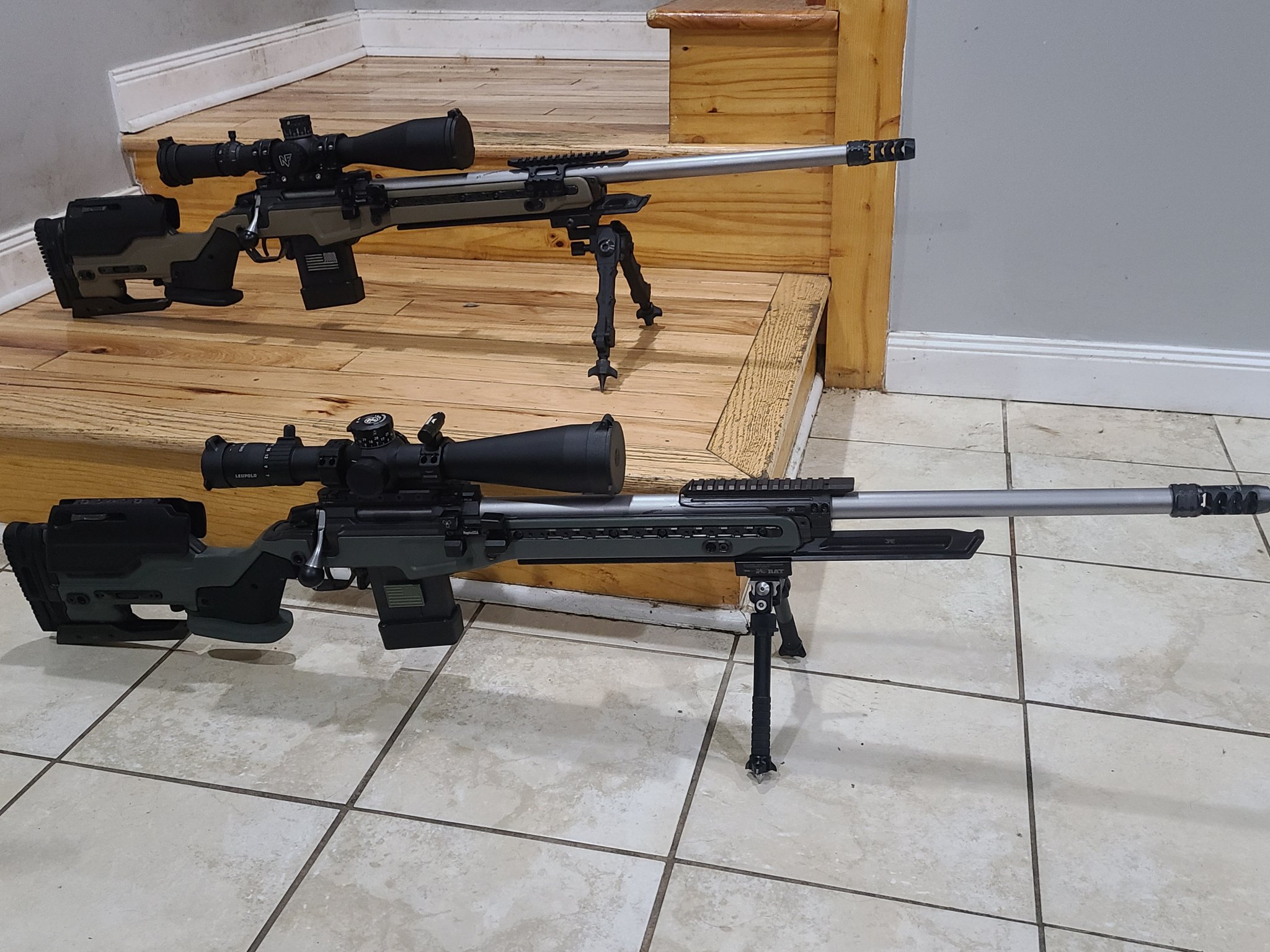

    If i could do it all over again id probably go with the mpa chassis. My buddy has one and its amazing.

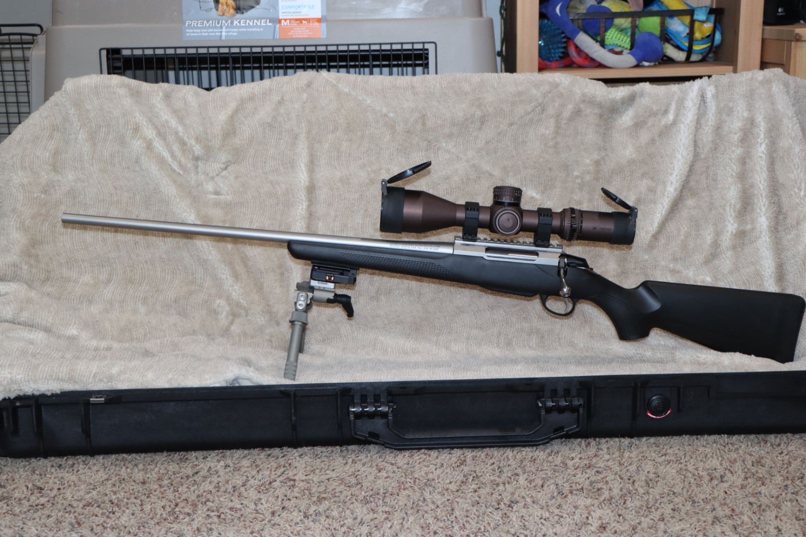

    Putting a T3X into a chassis kind of defeats the purpose IMO.
    Why?

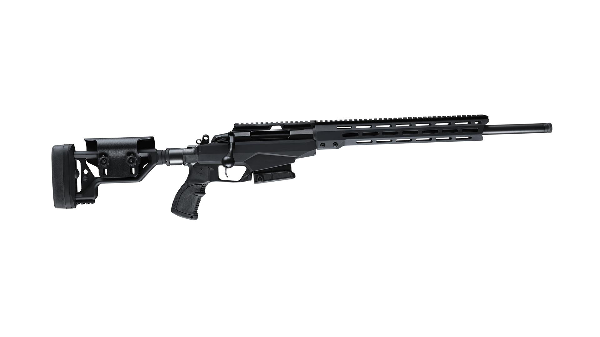

    BTW Tikka already does it themselves in case you weren't aware. tikka_t3x__t3x-tact-a1__pov__1.png
    Also why should I fight with a light flimsy stock that doesn't fit me? Especially when what I want (left handed and stainless decent weight barrel) isn't even imported into my country. With my Tikka currently I have closer to a freaking chin weld and have to have a sling stud to picatinny adapter to fit my bipod.
    I see the Tikka as a quality rifle that works great out of the box without breaking the bank that is actually useful without having to change out parts or cut on the action. Especially when it has a great trigger. There's nothing that is broken or needs fixing. You can get a good action for the same price as a custom but also get a stock, accurate barrel, and a good trigger for free.

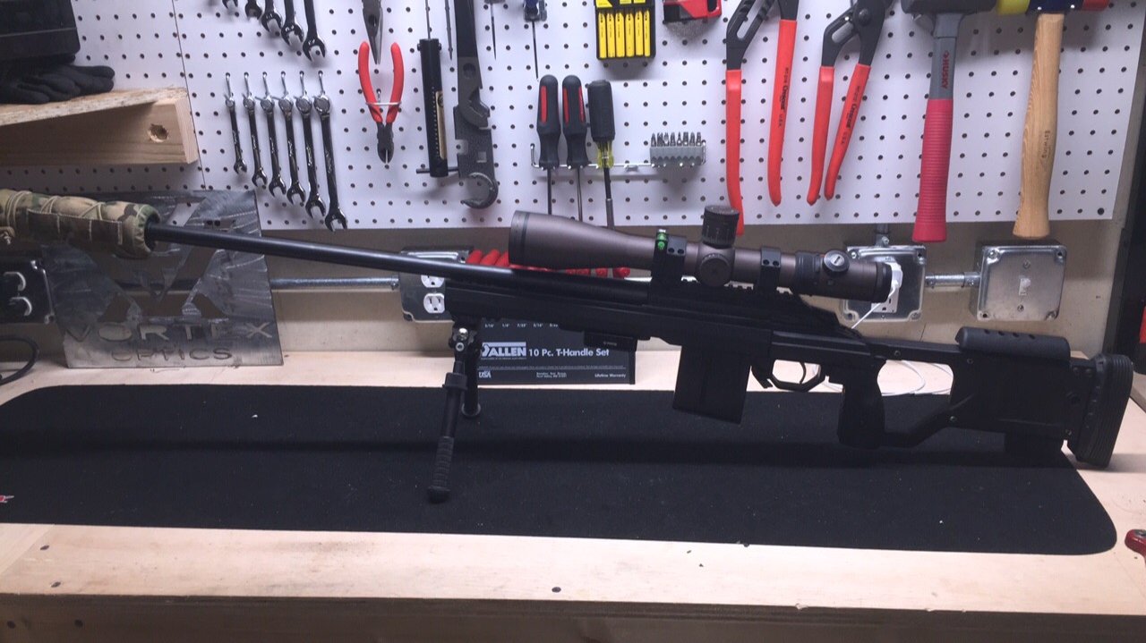

    My Tikka Super Varmint is great.
    Married with the Vortex Razor scope, it's a great combo.
    I've shot alongside the TAC A1's and CTR's, no real difference
    Roll with whatever suits you.
