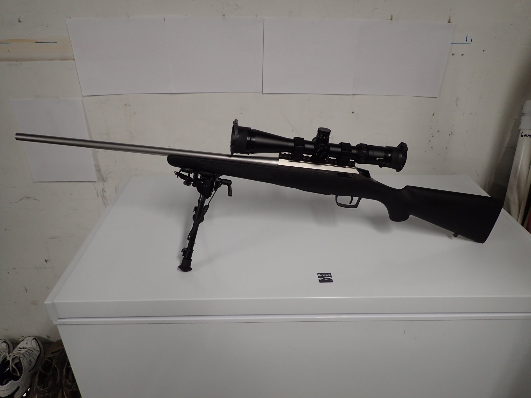

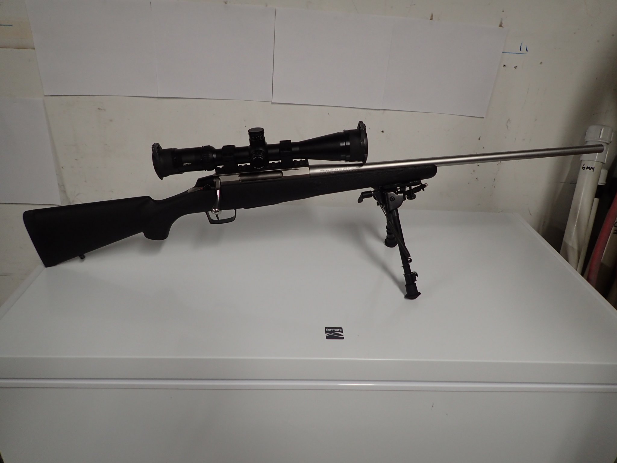

I was in the exact same boat as you... except I didn't know about buying used and ended up buying everything new ~ 10% off. Ended up with the Athlon Ares ETR instead of the Cronus, couldn't swing the extra $400 for the Cronus. The ETR is 2.5" objective diameter, and the Cronus is 2.6"? I know then Gen 2 is.
I have 1" rings, and the scope is almost touching the barrel with the scope caps on... if I end up switching to a pure bull barrel I'd probably need higher rings, so yeh I'd suggest you going 1.1" rings. Vortex PMR has 1.1" rings. I have seekins 1" rings which I really like, but they don't make a 1.1.

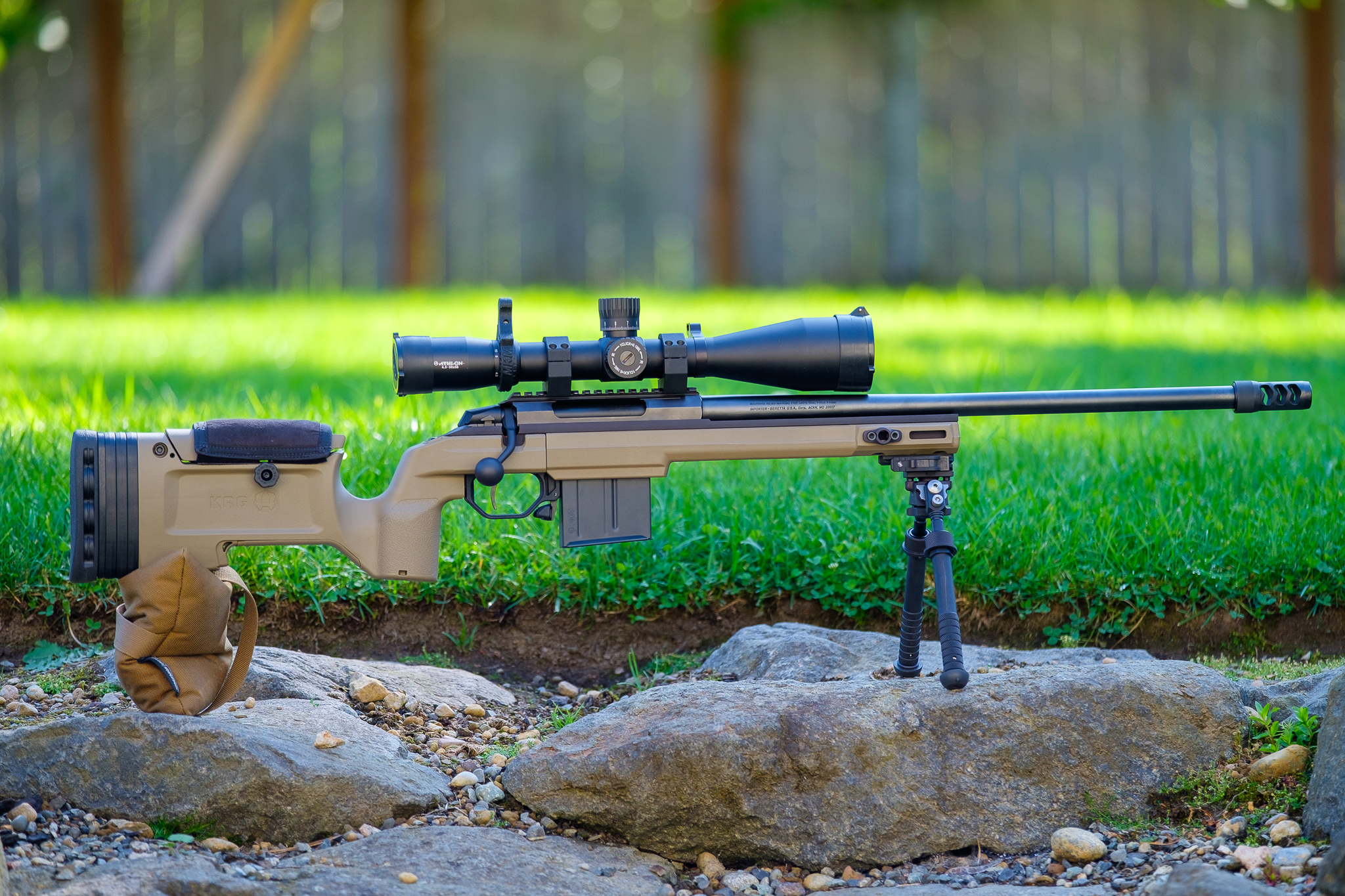

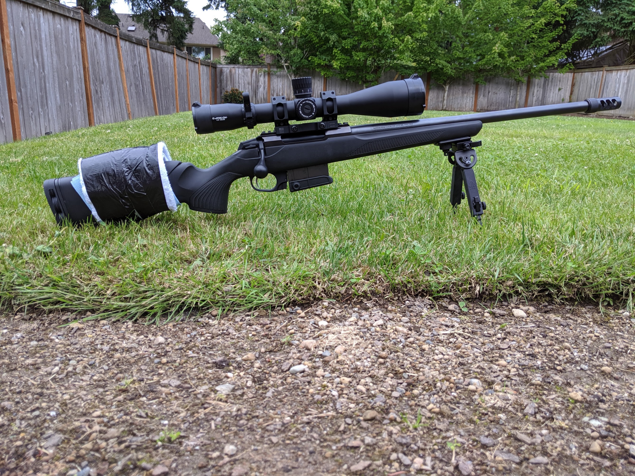

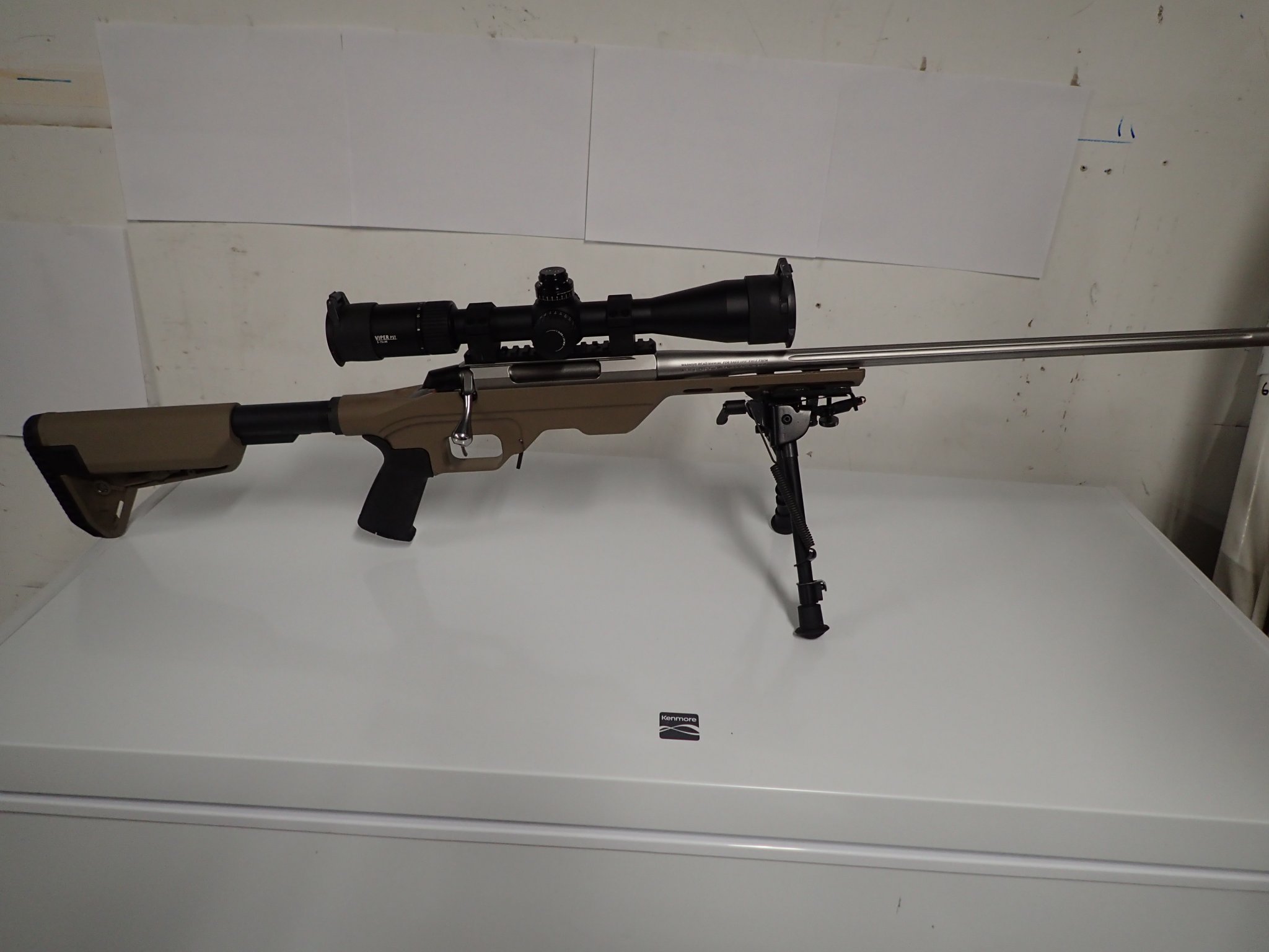

I put my rifle in a Bravo. I couldn't get enough cheek rise out of the CTR stock...
7119654
It's now in a Bravo, swept back handle, seekins 1" rings.
7119673
The CTR mags are nicer than the AICS mags a few ways. #1, the CTR 10 rounder double stack is still a bit shorter than the MDT double stack mags. Feeding, once my AICS mag was broken in was fine, at first it was hard to load that 10th round in, and it was also a bit of effort to load the first round. Once broken in everything was great. The CTR mags were smooth right off the bat. But I wanted the Bravo, and didn't want to wait another 3 months for them to build a CTR inlet. Sold the CTR Inlet, Magazine for $150 to pay off some of the cost off the Bravo and AICS mags.
The Sterk swept back handle is very nice. A huge upgrade for my Tikka T1X which had the crappy small metal knob. The CTR knob, to be very honest isn't bad. In terms of spending $100, there would be other things I possibly would buy first. The titanium shroud, has zero performance benefits so I didn't get that... maybe one day I'll spend some more $ for improved looks, but it didn't do anything functionally for me getting better as a shooter.
Other things...
- Limb Saver Air Recoil Pad... the T3X one fit my bravo. I had to double up on the little spacers to have the screw fit tight, but it worked.
- Hellfire 419 Brake... it's great, but after learning how to get behind the rifle properly and have it recoil straight back, I can shoot with or without it. With it, the recoil is barely noticeble. A lot of prone matches around here don't allow me to have a brake, so I've been doing it on/off.
- I had a 1lb using yodave, or tikka performance spring (it's just a spring, $10 from like 4 different vendors. I used Elay Precision). I then wanted to try out 2-stage, so bought a Timney Tikka trigger on sale, and have it 0.5lb stage 1, and 1lb total break, and I enjoy shooting my 2-stage more.
- Bipod, not good enough to really tell the difference between Atlas, Harris, Cheapo bipod. I can admire the quality difference, Atlas is definitely a whole lot nicer built, but they all take my load fine when in prone, and I haven't done many PRS where I need fancy spiked legs yet, I'm sure one day I'll start really enjoying the bipod more.
- Rear bag. They're not all created equal. After 2 relatively cheap rear bags, I splurged on a Precision Underground ELR bag $50. HUGE difference... I love that thing. That'd probably be my first purchased upgrade :p

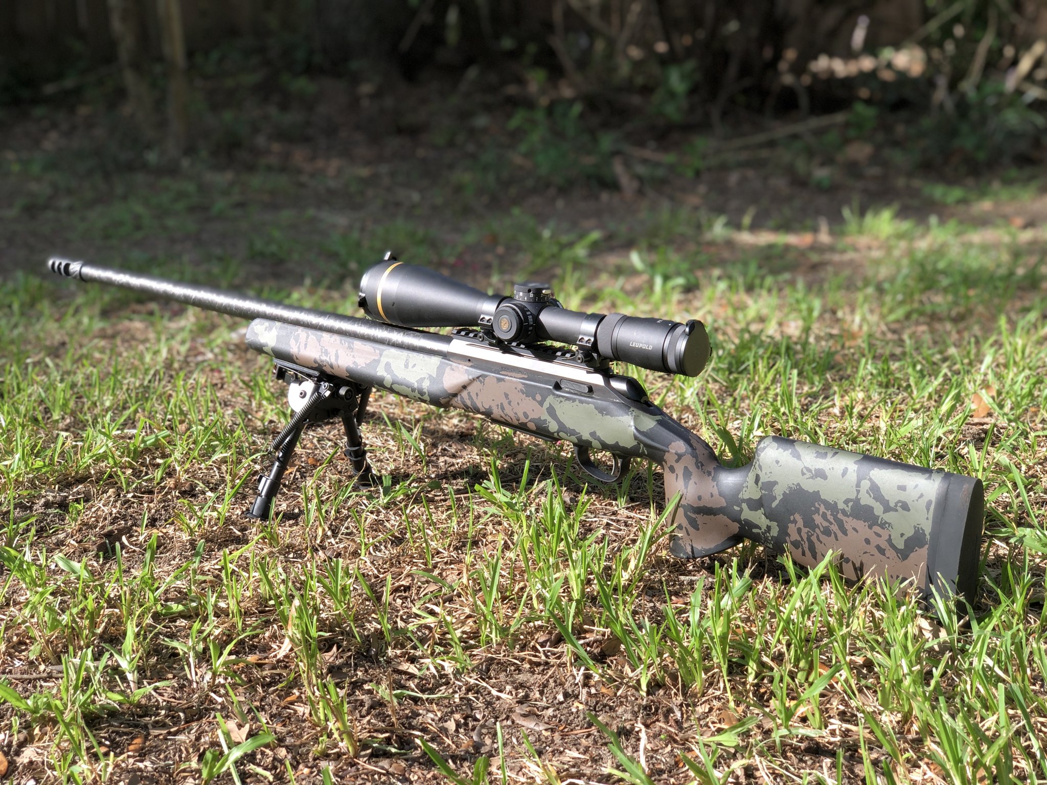

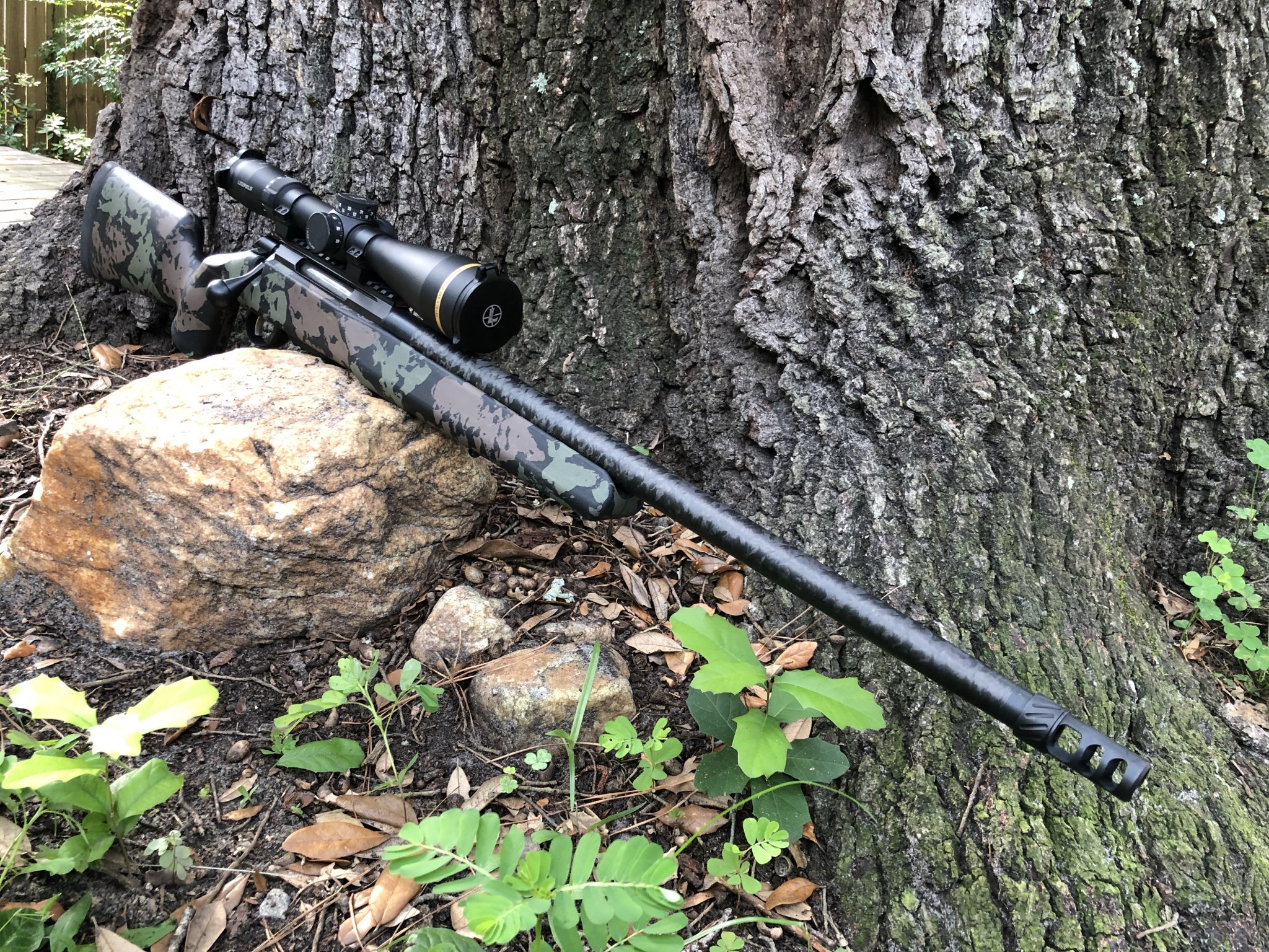

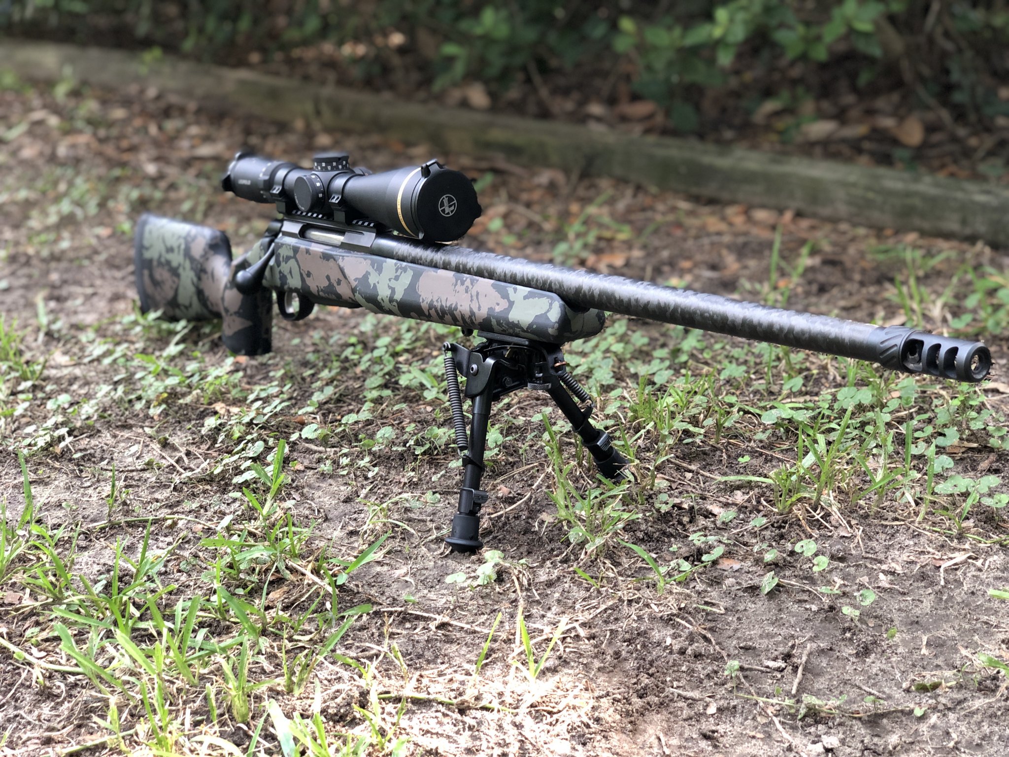

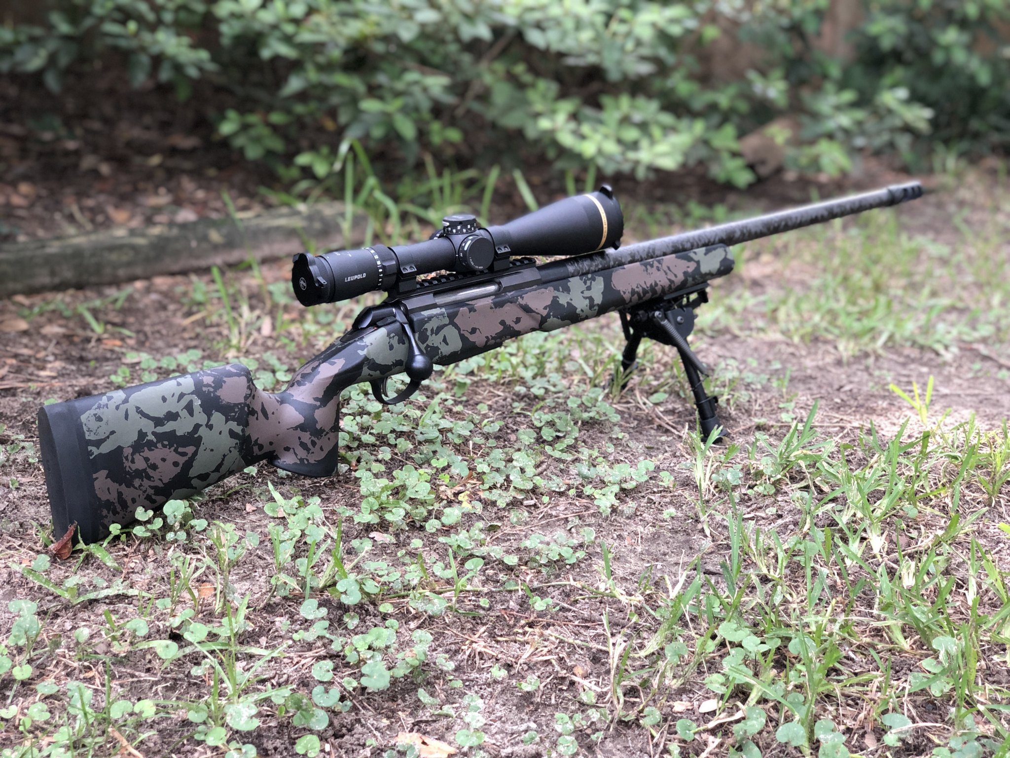

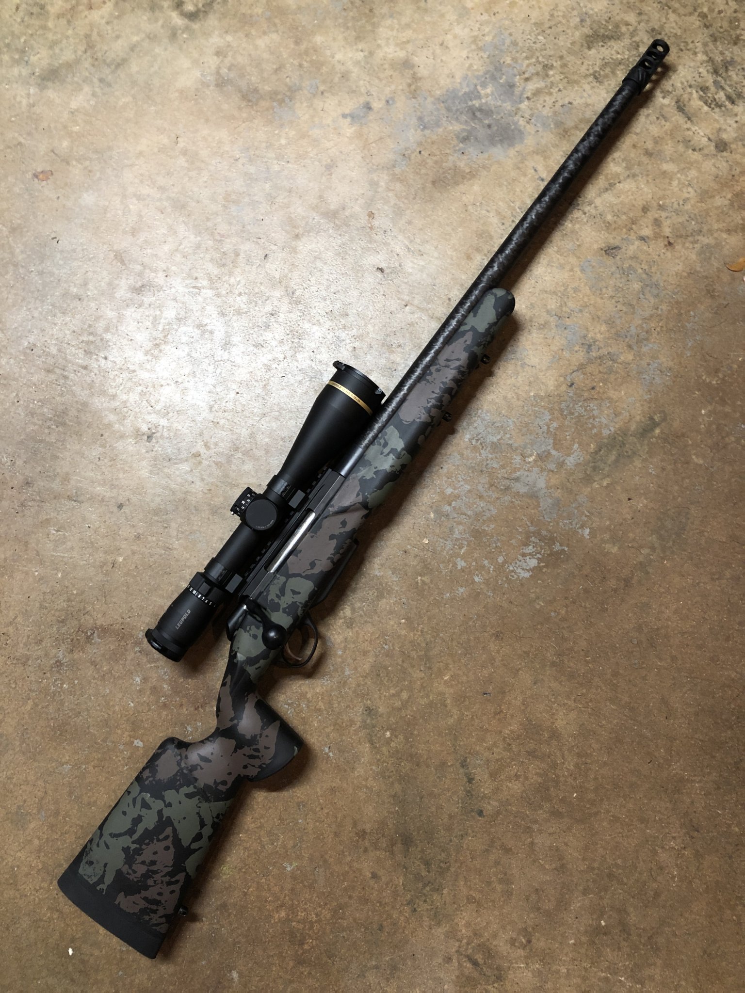

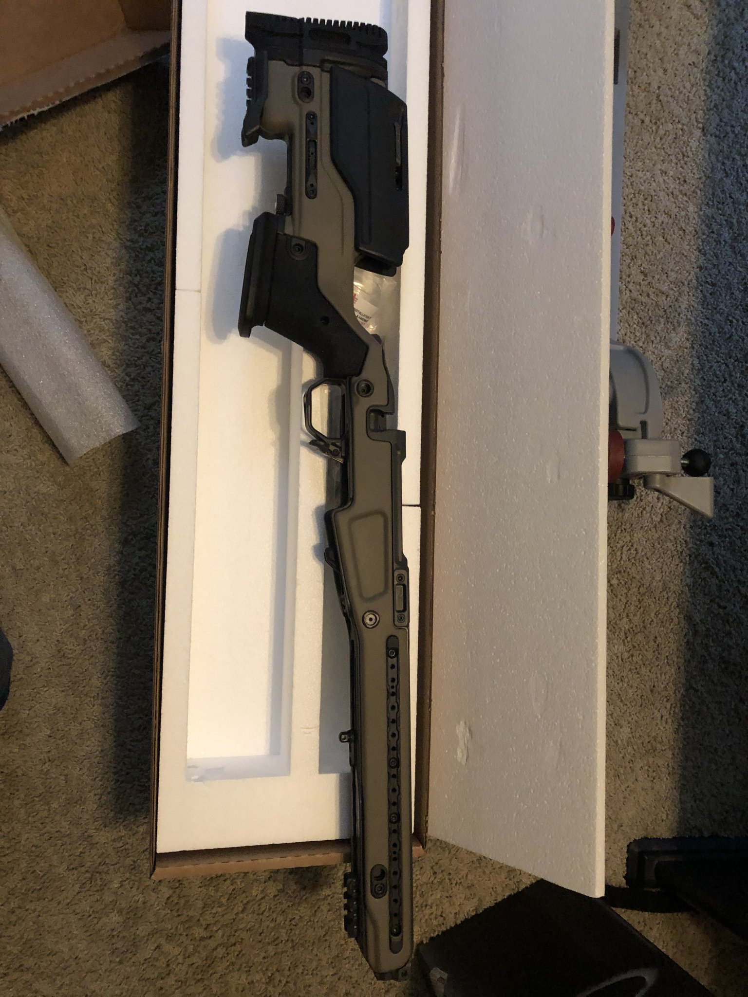

Little update on my T3 LH shorty build. Finally got my Grayboe Terrain stock in (after 4 month wait). Tikka T3 action inlet, CTR DBM inlet, Sendero barrel channel, finished in gray w/black web.
I like the Grayboe stock. It feels light, is well finished, everything fits nice and snug, the flush cups are nice. Grip and cheek weld will fit me nicely I think.

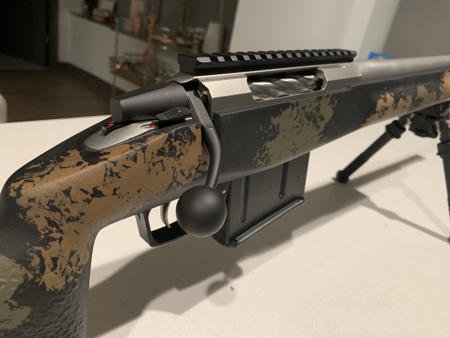

Have the action with A419 20MOA rail, CTR DBM, Mountain Tactical bolt stop (to convert to short action) metal shroud, and trigger spring. Have my optic ready (Steiner PXi 4-16), now just waiting on my 17” 6.5CM CarbonSix barrel.... should only be a couple more weeks on that one.

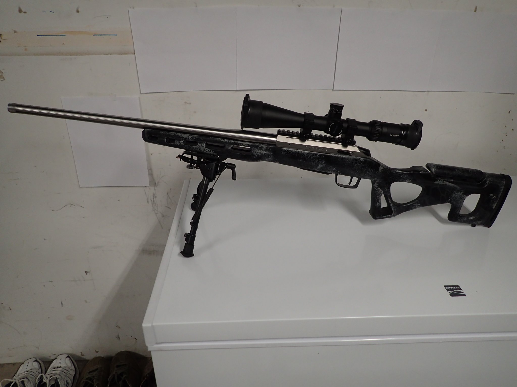

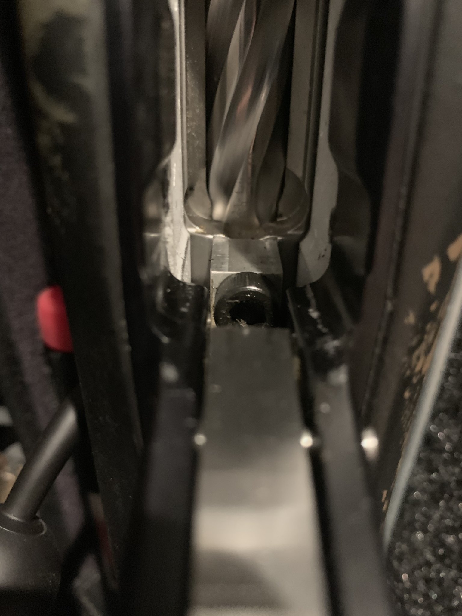

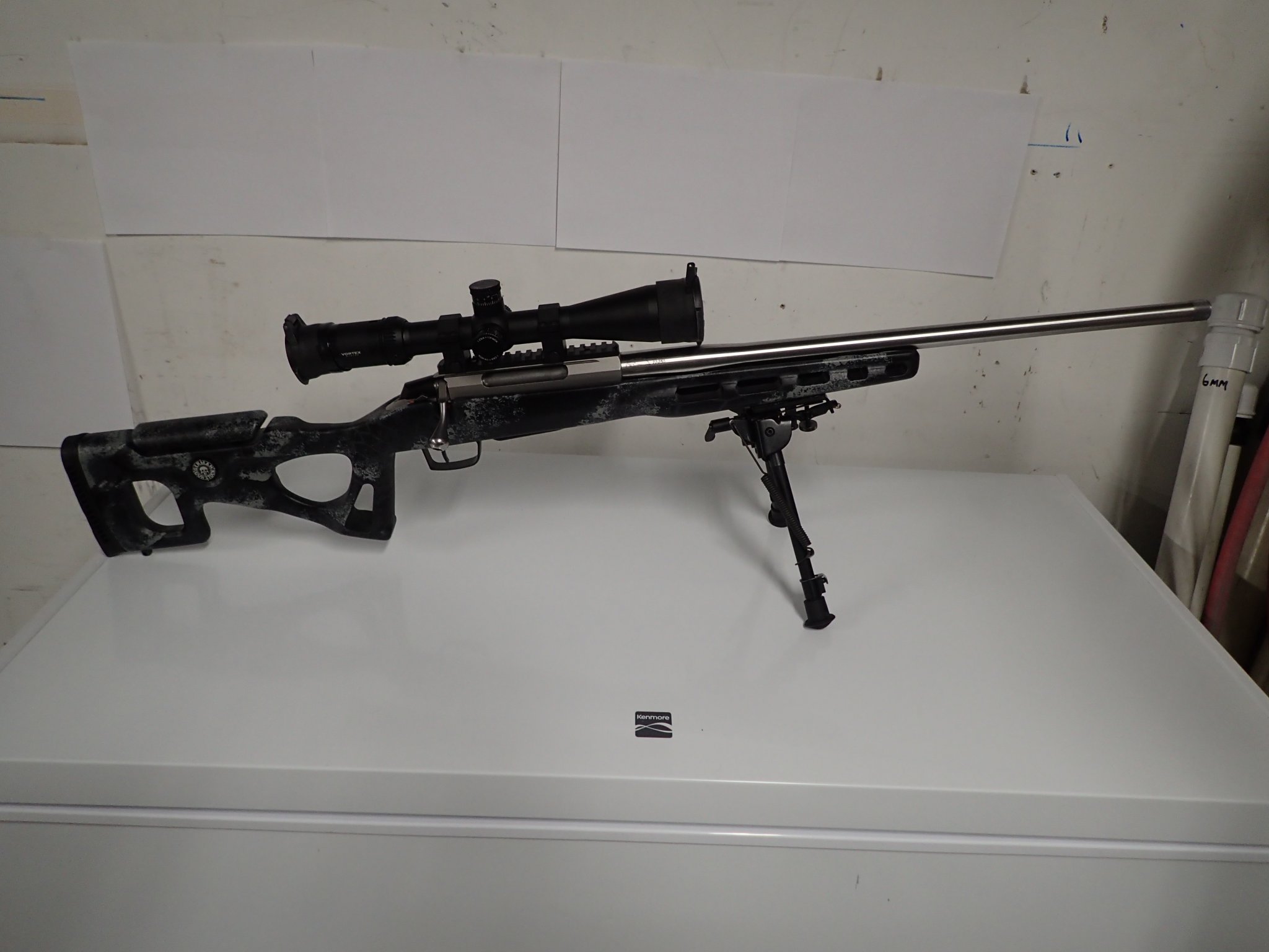

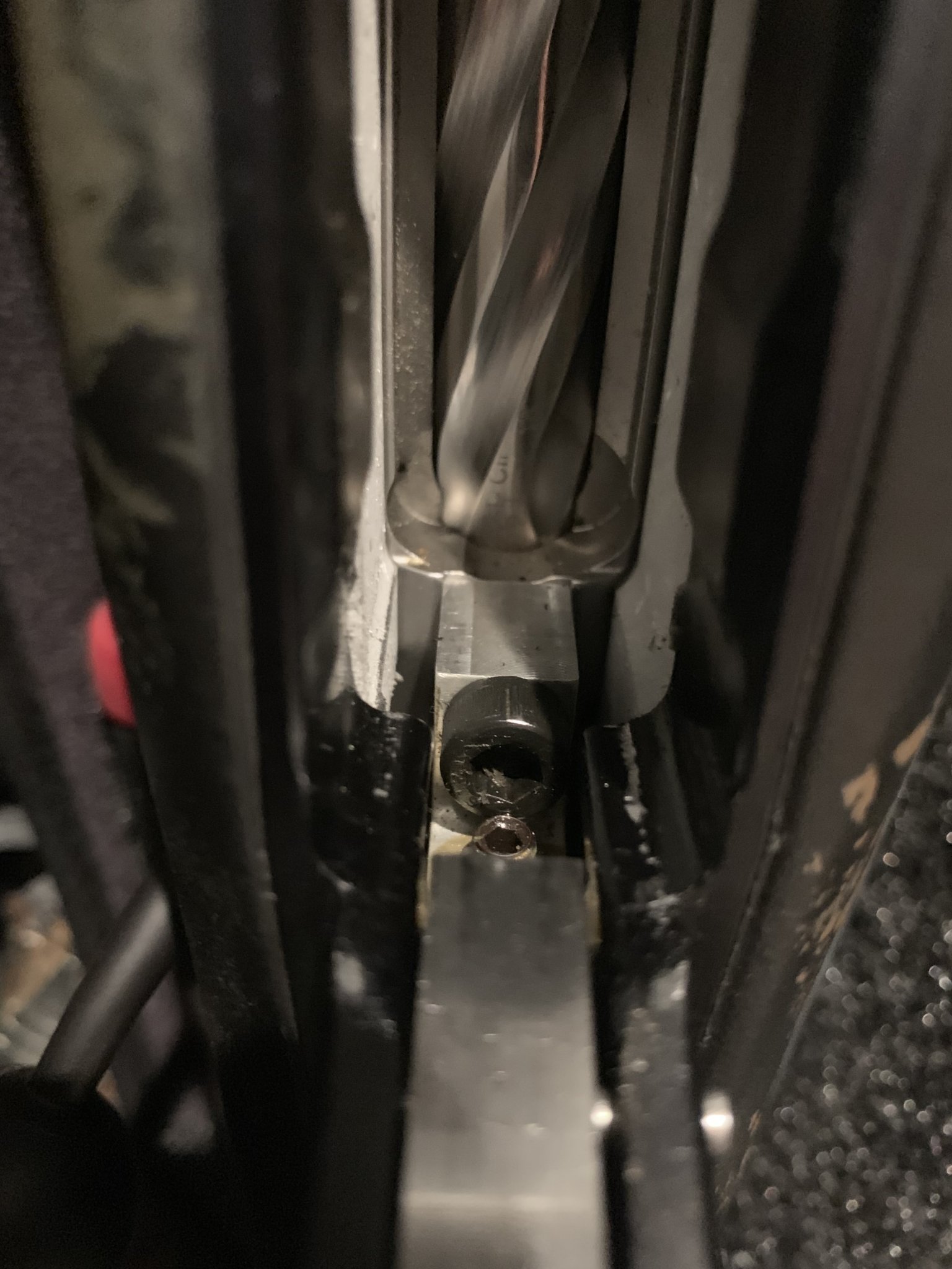

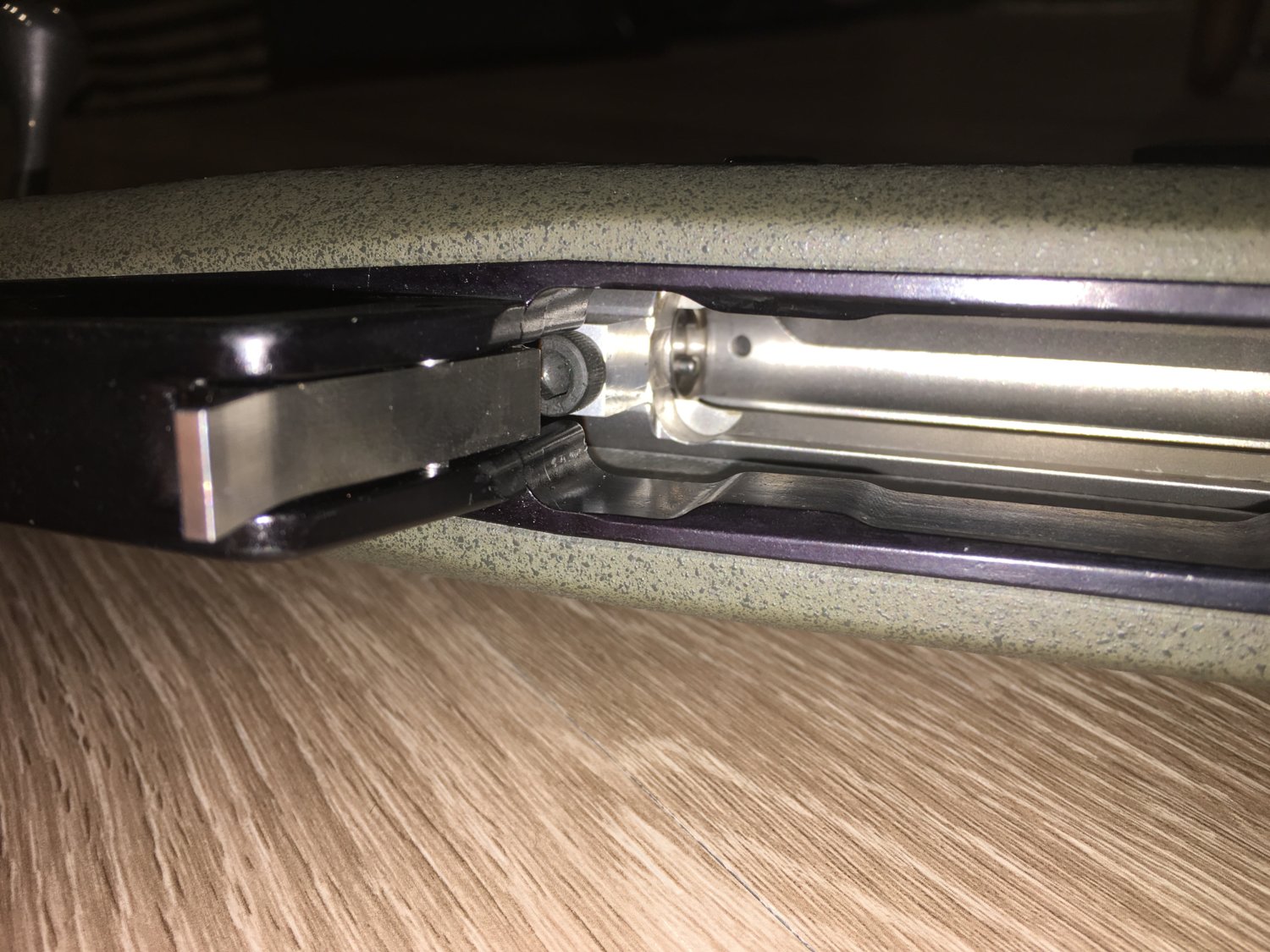

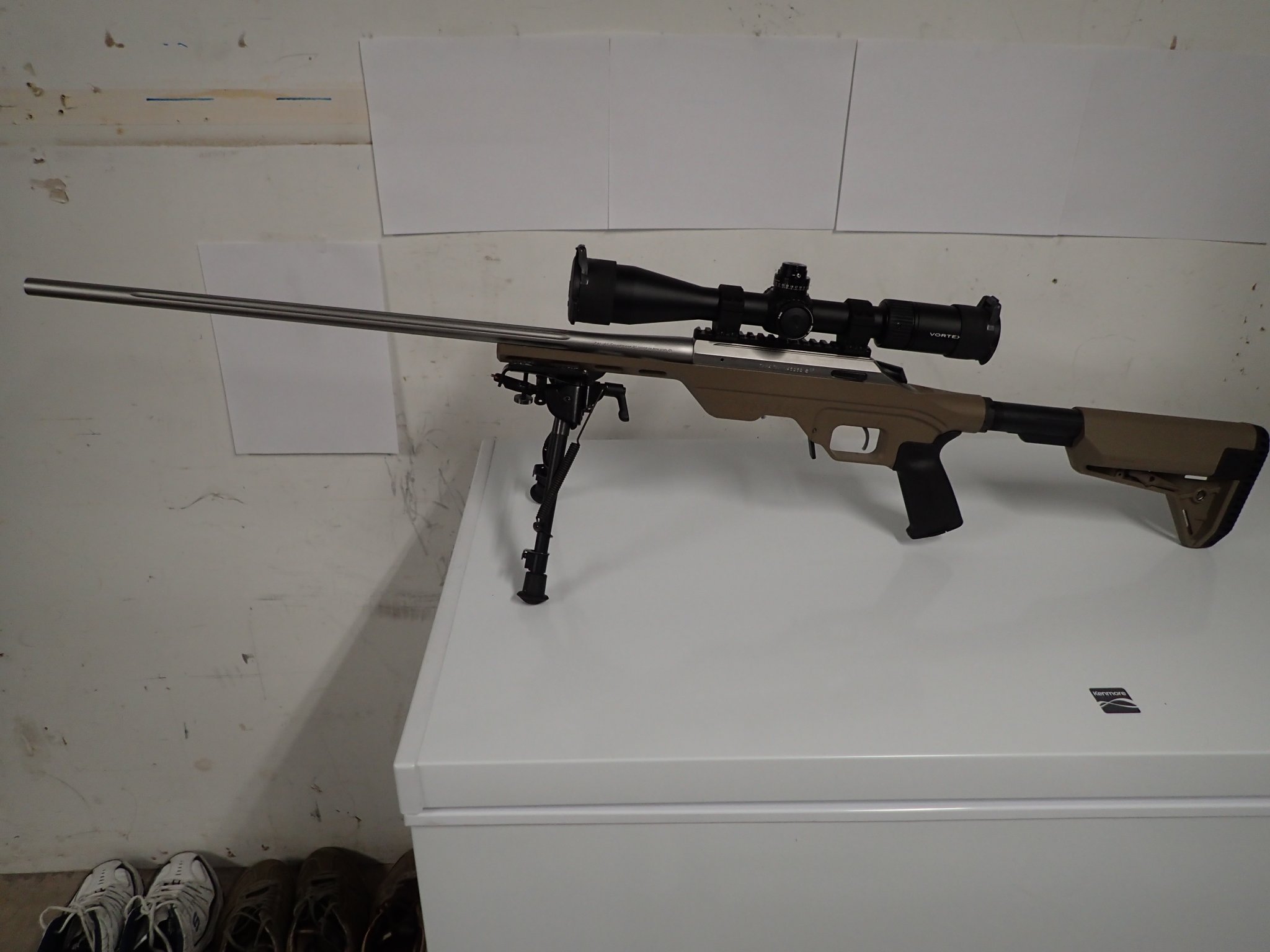

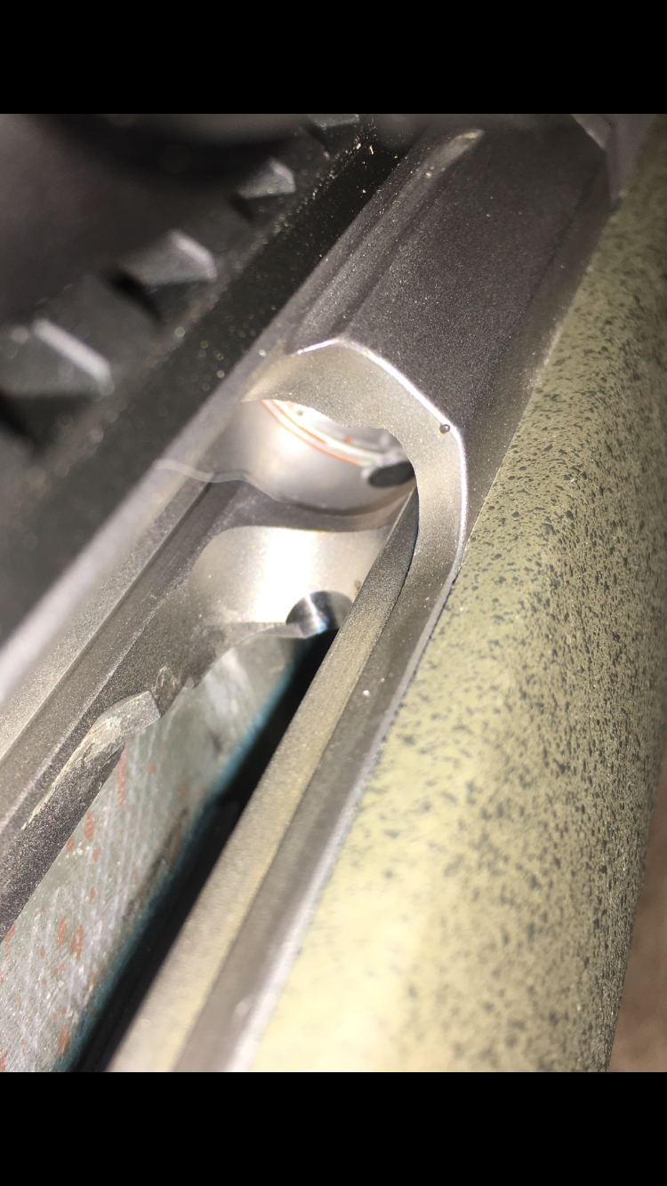

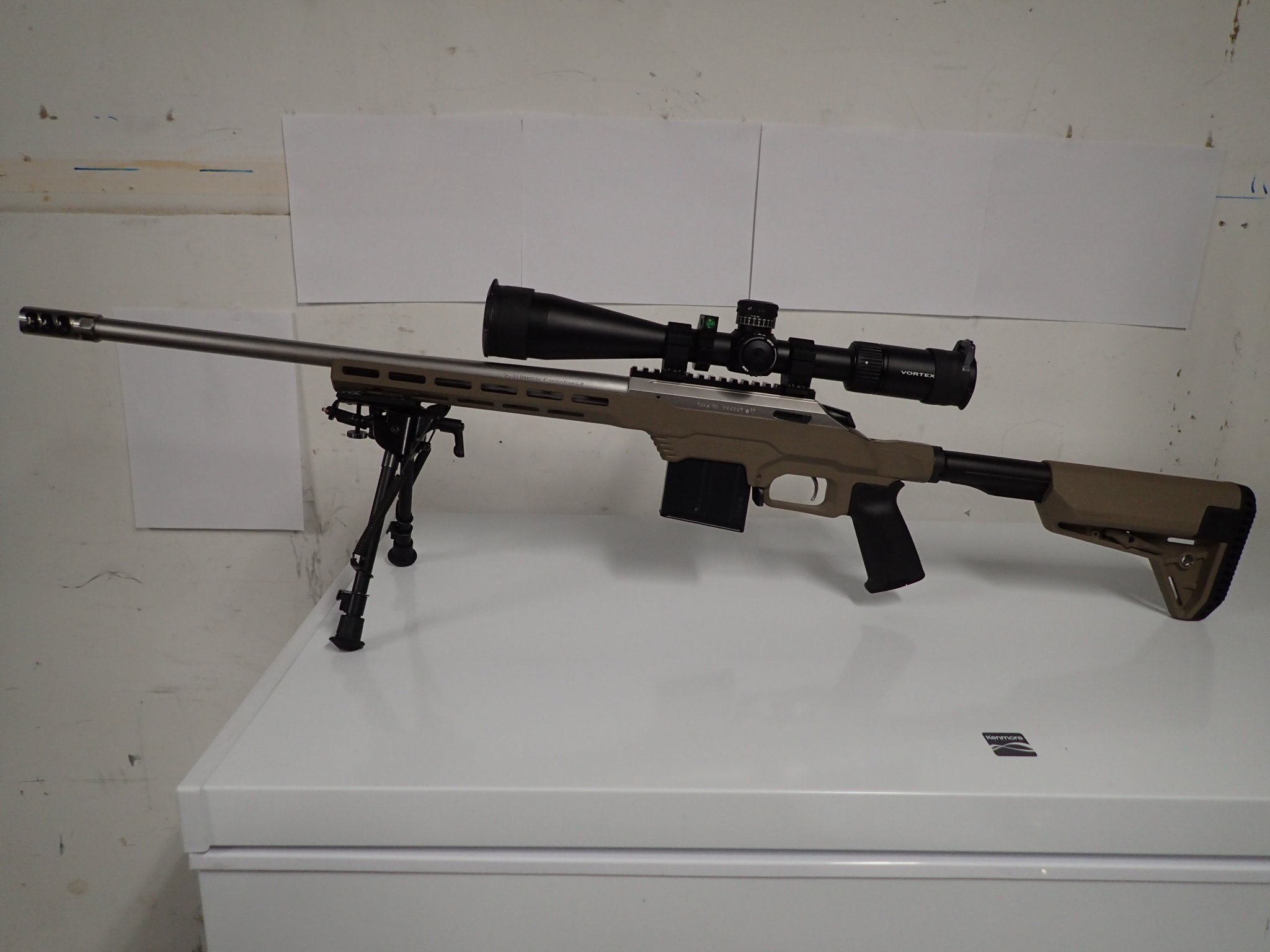

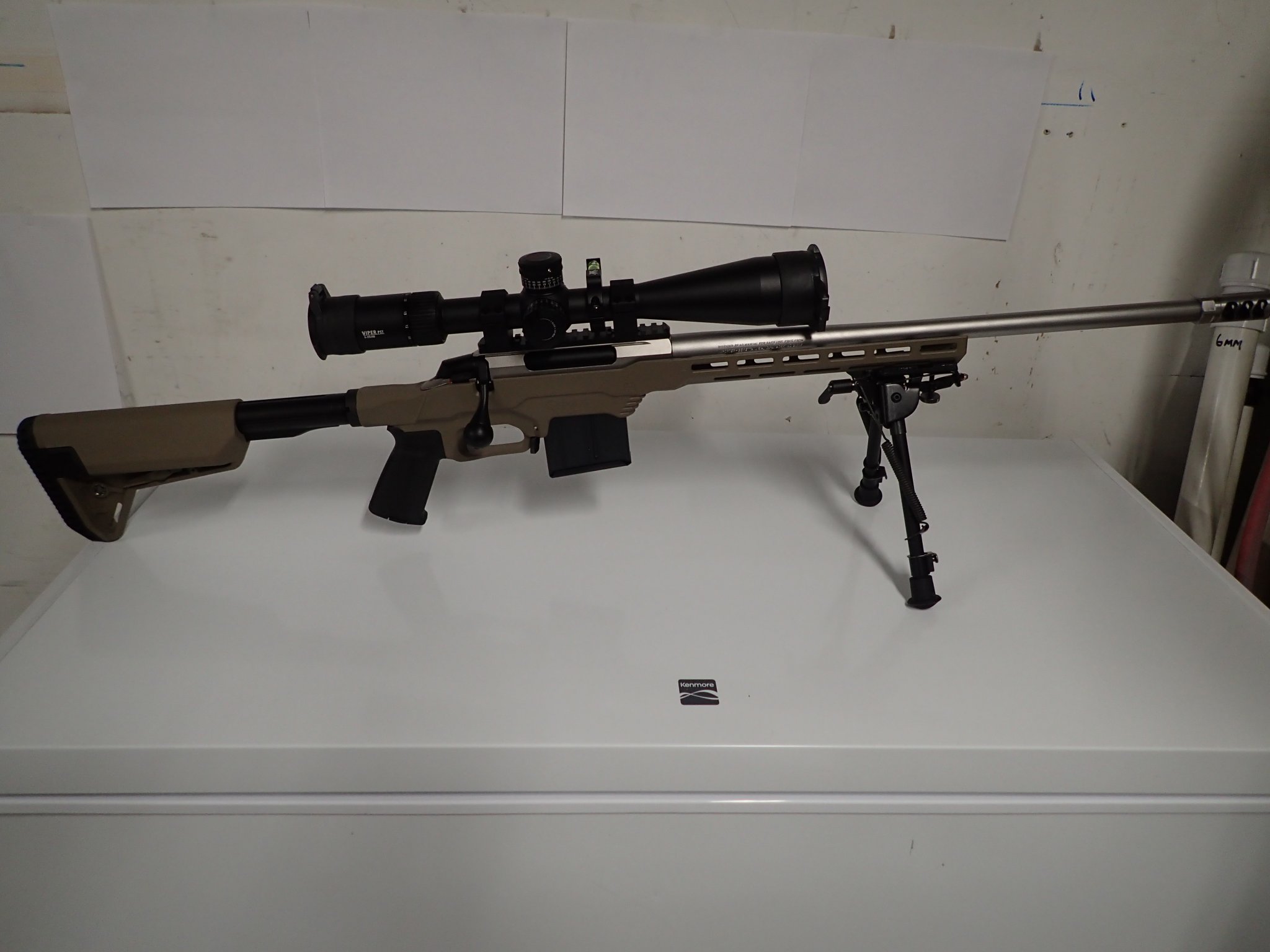

For your viewing pleasure. Tikka T3x 300 win mag - Manners T4, Mountain Tactical bottom metal, Murphy Precision 20 moa rail, Bartlein bull sporter 1/10 twist (#4 I think?), Sterk bolt handle and shroud, and Remington style recoil lug. Didn't really know what I was getting myself into when I decided to buy a Tikka in 300WM w/ the magazine limitations and 1/11 twist rate so I just went all out. The bottom metal allows me to use an AICS style magazine (Accurate Mag) that will hold a round chambered up to around 3.7" COAL, but required a slight trimming of the trigger housing and notching the feed ramp. The different colored stock is a grayboe terrain I had to ditch because the LOP wasn't enough for me. Might get Manners to install an adjustable cheek piece like they have on their CS2 stock. Just getting to the point where accuracy is starting to improve after breaking it in, have not handloaded for it yet but getting around 3/4" 5 round groups w/ factory Nosler 190 grain ammo (tighter groups shooting just 3 rounds). Doesn't seem to like Hornady 200 gr ELDX as much, those are closer to 1" groups. I do have a box of Hornady's 200gr eldx bullets, and I measure an OAL of around 3.65" to the lands so factory ammo is jumping quite a bit. Bought some berger 215 grain factory loaded ammo to test as well as Nosler's match grade 210 gr so testing to resume once those arrive. Initial impressions are good though the magazine has slop/play I don't care for and need to figure out if I can tighten it up. Looks good at least!
You’re a savage dude. That gun is awesome. The 215 grain Berger ammo shoots awesome out of my Desert Tech (SAC chambered Bartlein Barrel). It seems like great stuff.
Nice work! That looks very tidy on the notching of the feed ramp. Do you have any more photos of the area in front of the trigger? I've been thinking about putting together a 300 PRC and If these mods give enough room for close to a 3.7" OAL it's looking like a Tikka will be the go.
Unfortunately that's all I took, and I'm not apt to pull the bottom metal off and change any of the torque settings my gunsmith set. I'll see if I can take a better photo but check out the manufacturer's video on youtube and scroll to about 8 minutes in where they explain the process. Now I have to inform you, I like my rifle, but I dumped a ton of money into it. In fact, I bought the thing before I realized the limiting factors of the 300wm in a tikka platform. Many other tikka lovers would disagree with my sentiment, but I would not do it again - I'd much rather pony a few more hundred for a custom action. This is my feeling on a large caliber rifle like the 300wm only, I think a short action tikka build is absolutely worth it. The reason being, my magazine is sloppy and as you noticed, I had to trim parts of the action down to make the modification work properly. I contacted Mountain Tactical about this once and their disclaimer was that this kit was meant for a factory tikka stock. If you try to find this bottom metal on Mountain Tactical's website, you'll be sorely disappointed as it doesn't appear to be for sale anymore for reasons unknown to me. It was a fun project, but it's an uncomfortable feeling to have a limited number of options to really get the most out of your rifle.
Thanks for the extra info. I have a machine shop so it's not an issue around getting the work done by someone else. Being in Australia and left handed kind of limits the availability of actions to easily build on. I make my own stocks so I can fit the magazine wherever it needs to be, just seeing the magic 3.7" number pop up has got the brain ticking over, I might knock up a dummy round and have a bit of a play. (y)
Awesome man, I’m sure that’ll help get things figured out and you won’t spend half the money on gunsmithing. I need to take my rifle back to my gunsmith to get this magazine slop figured out and I think it’ll be gtg. The other thing is is the mountain tactical mag release spring (at least the one in mine) was pretty weak and I had to get a stiffer spring for it. Recoil would cause the mag to drop. Anyway good luck, would love to see you work something up

We fit Atlasworx LA T3 mag systems. They are not made for a particular stock which has it's good point because the 300wm is a bit tricky. The angle & position must be just right. No need to mill off the trigger housing. I think the trick with the little cut out in the front of the action is the way to go.
Best is to bed action first then free float bottom metal with mag inserted into it's natural position sitting in the action … and bed bottom metal in that position.

I received my 215gr Berger ammo recently and it comes loaded at a COAL of 3.6" as advertised. I took my calibers out and started measuring things. With my feedramp notched, the ammo is able to load properly but I don't think there's much room left. I realized I may have misquoted some information - the internal box dimensions on my accurate mag AICS magazine are at about 3.64" w/ an OD of 3.715", so that ammo just fits. I am also not sure if these 215s are pushing up into the lands - I took my hornady oal guage and the hollowed out cartridge and w/ the hornady 200 grain eldx bullets, was touching lands at ~3.58". These berger bullets are .02" longer than what the hornadys allow me but I'm not sure how the ogive plays into this so I might be ok.
Regarding Mtn Tactical's update, would love to see what they come out with. Tried posting a video of the wobble but I don't think the website allows the file type.
Took some screenshots of the video at each extreme left to right. Hard to tell how much this thing swings but it's not insignificant. I use a very reputable gunsmith and have little doubt this was user error. The trigger guard creates an optical illusion, the bottom metal is very much centered in the stock without any weird inletting.
