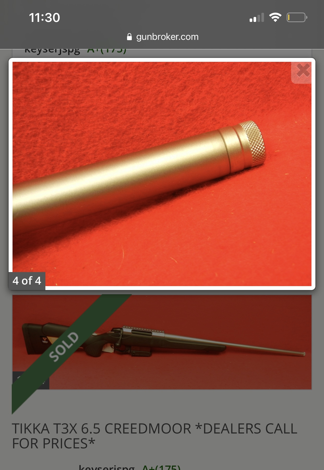

Well fellas, I just joined the club... was listed as a t3x only, Not as a ctr. Been looking for a little bit now. Glad I finally pulled the trigger.
Congrats! Looks like a jrtxb382. Mine is the same just mirrored.
I’m 99% positive it’s a CTR. Based on the stock and it’s a threaded barrel, regular t3x lites don’t come threaded, or have the raised stock.
also, the bolt handle, scope base, mag, bottom metal, mag release, grip... It's 100% a ctr. what'd you give for it?

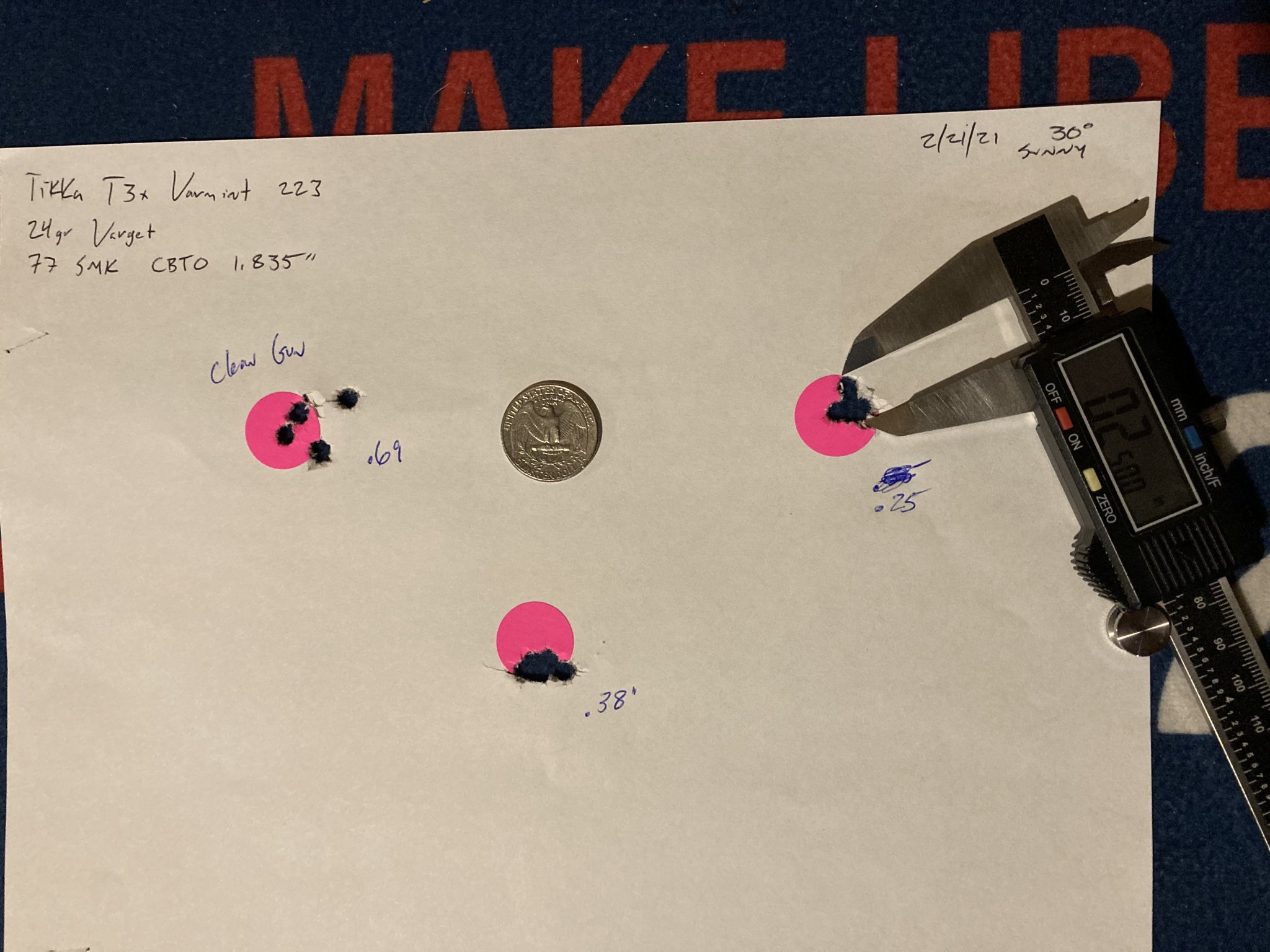

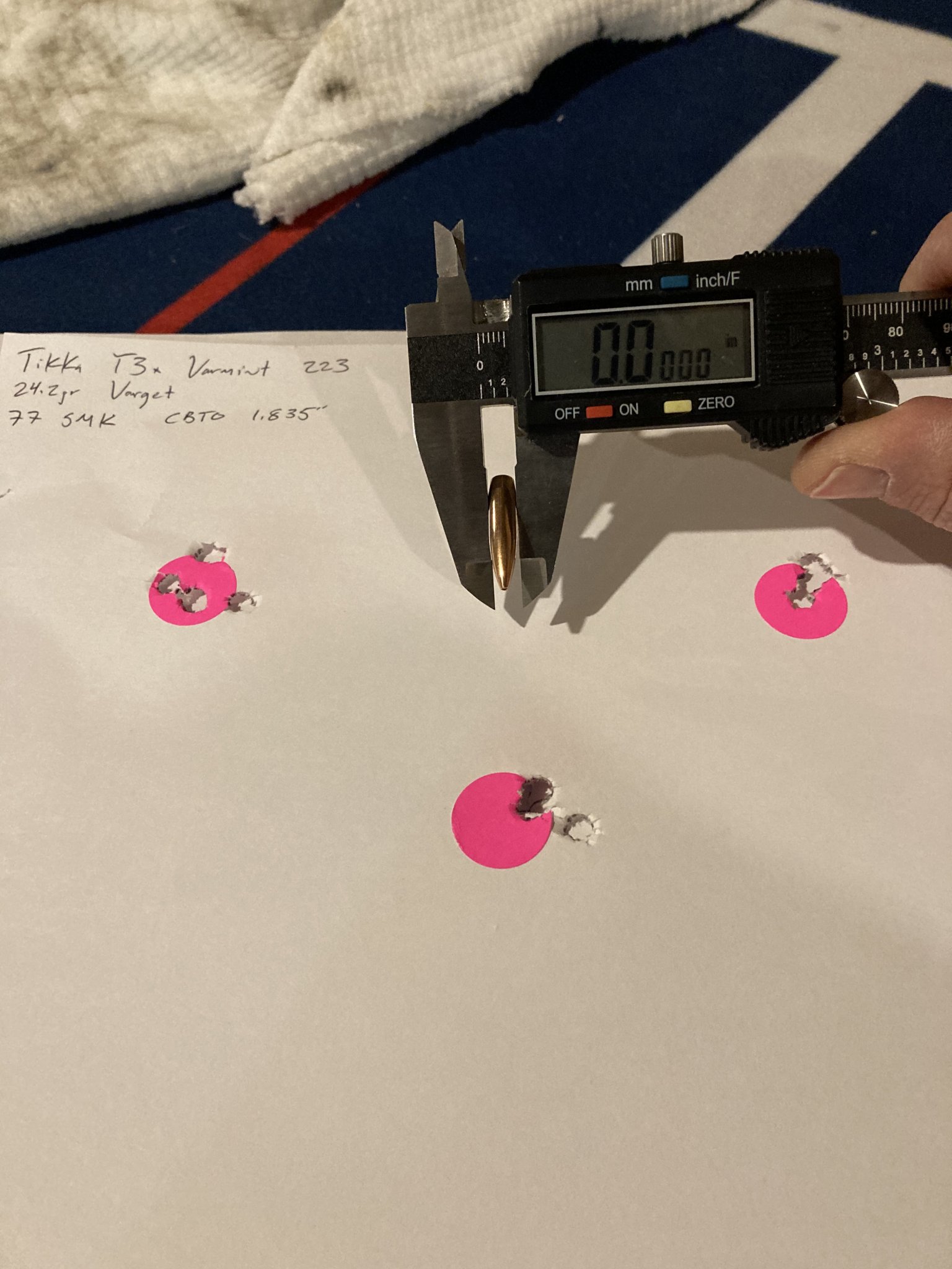

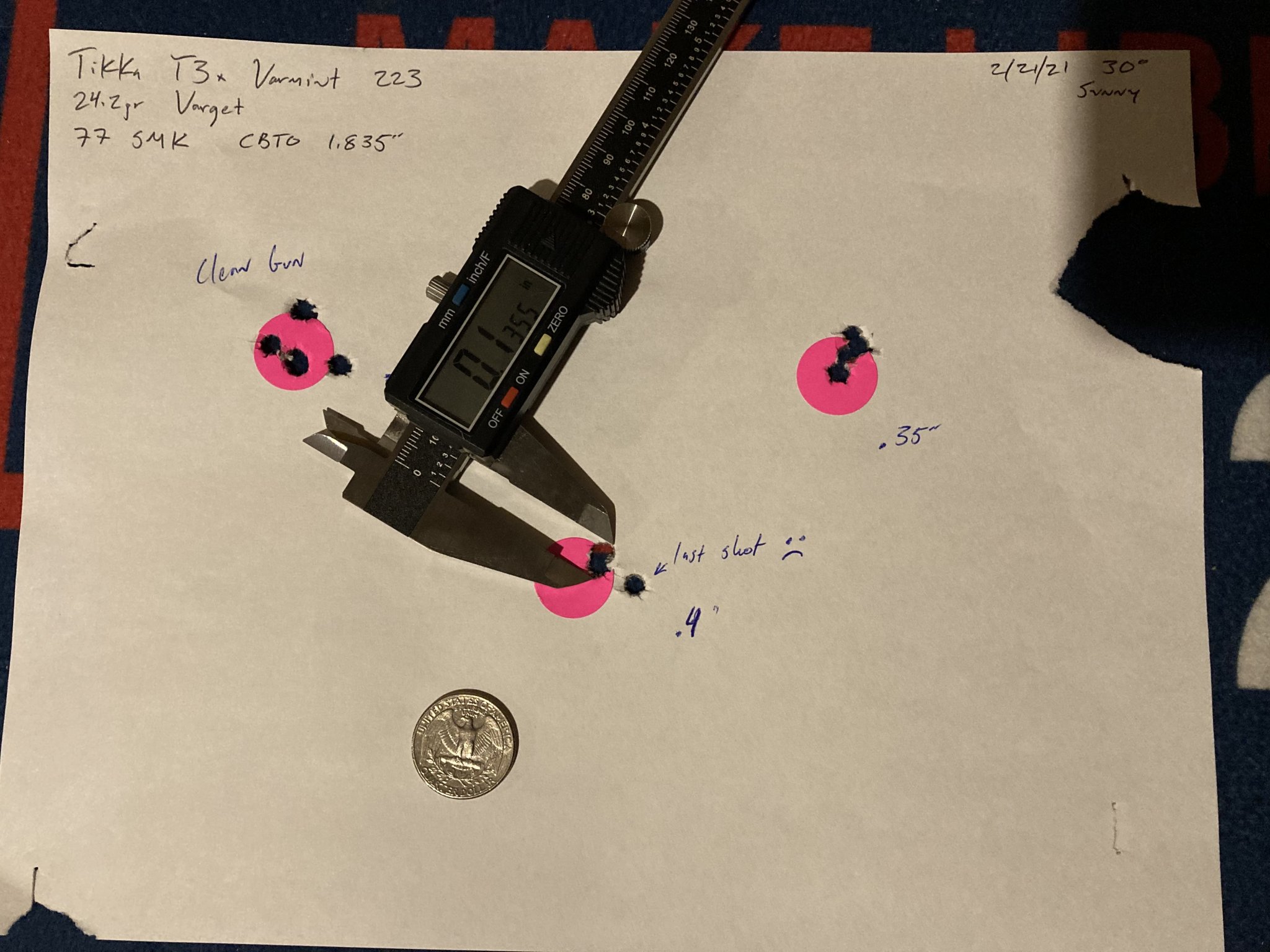

Think I’ve dialed in my load for the varmint. First finished load development for me and I hope they all go this easy haha. Started with an OCW test to dial in a cpl charge weights than went to seating depth. Went back and checked two best charge weights with everything else constant. I dunno if was me or load on the final group but it woulda coulda been my best to date lol.
i gotta get off my ass and send him my varmint profile 223 20" for the creedmoor magic

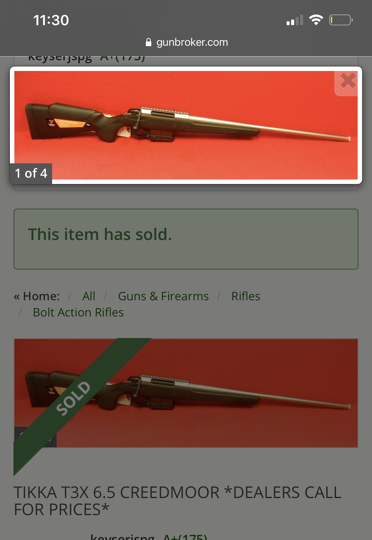

Anyone know where I can find a T3x TAC A1 Left handed in 308 or 6.5 20 or 24" anyone? anywhere? I have looked for a couple days now and if I could just find one I would pull the trigger, per say! Thanks for anyone's help in advance. Please point me in the right direction.
Just saw a bunch of tacs on gunbroker this morning but not sure if any were lh.

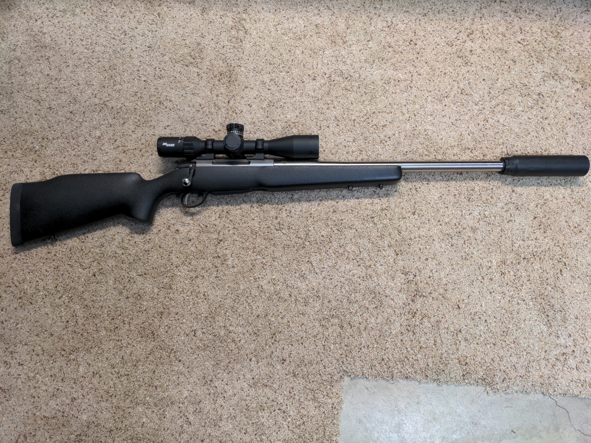

My first Tikka, chambered in 6.5 Creed by Radix Precision in Omaha. Barrel is a Broughton 5.5 profile that I picked up off the PX here and cut to 20". Sig Tango 4 and B&C M40.
I plan to do a DIY sponge camo paint job on the stock and then it'll be done

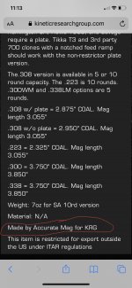

Has anybody run the 223 krg mags in a krg chassis? Do they feed well? It seems like the consensus is MDT polymer 223 mags feed well. I’m curious about the keg branded mag. Is it an accurate mag?
I was correct the KRG mags are basically accurate mags branded for KRG. Does anybody run those with a 223? How does it feed? What is the preferred 223 mag for a bravo?
Im guessing if krg sells krg branded 223 mags they should work fine in a KRG chassis.
