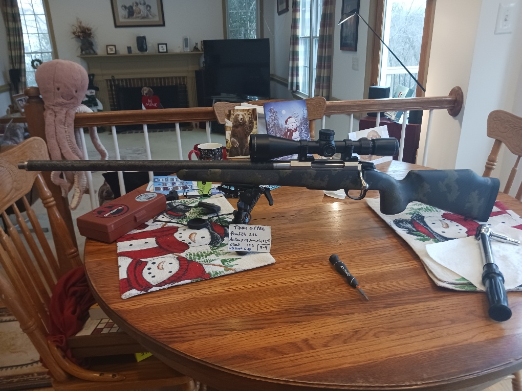

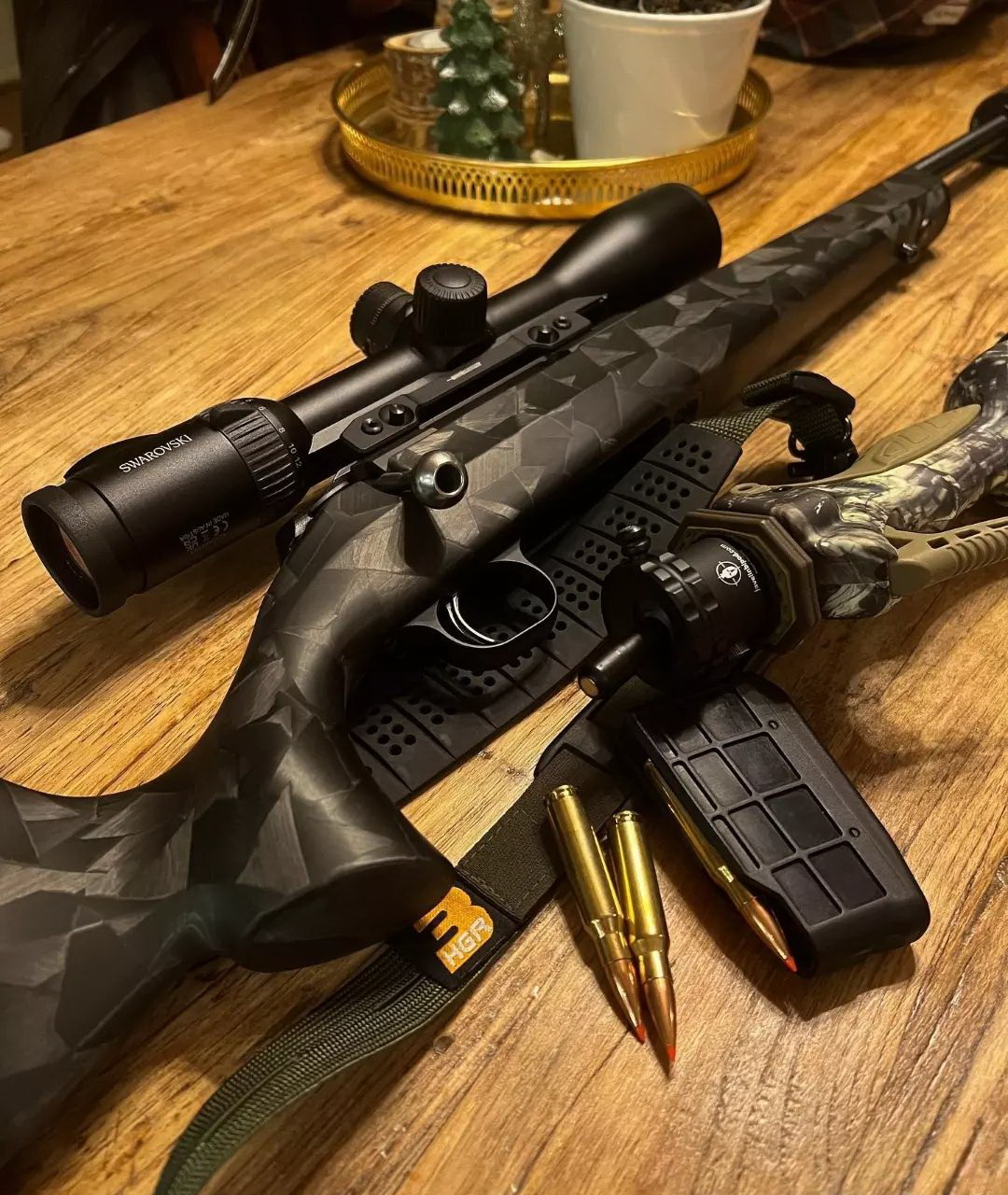

Thanks, this stock is a bit of a test bed since quite a few years, had a 3 month stint with the Irish Rangers, was handed around and tested in Germany and one of my main hunting stocks. Just received a fresh coat of paint.

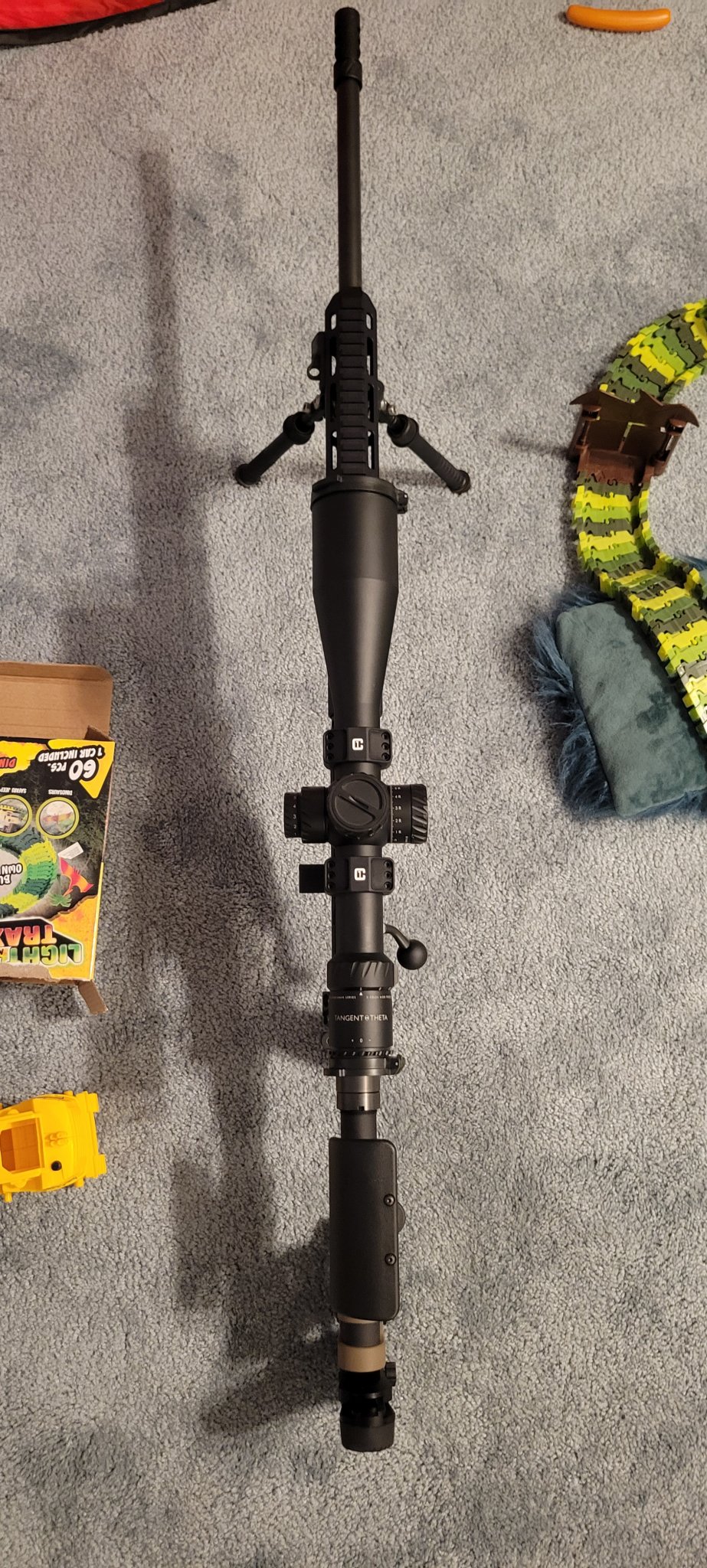

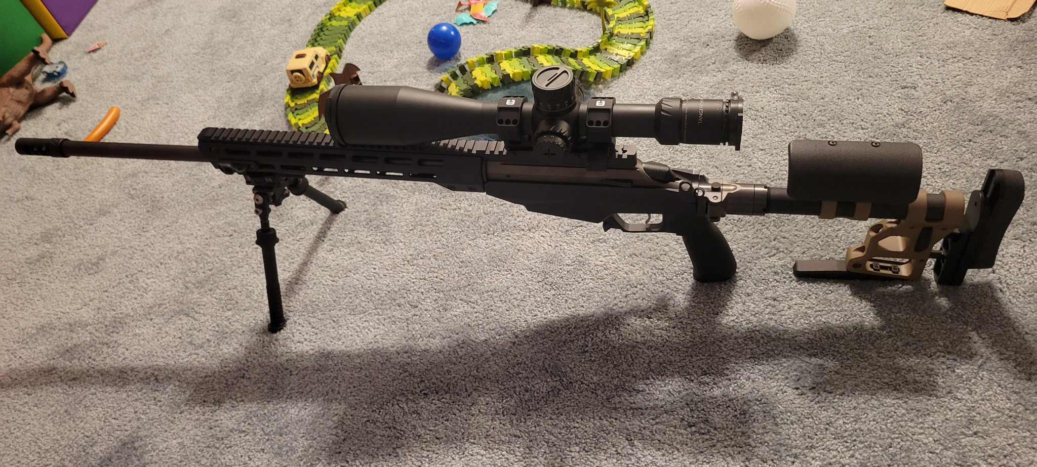

Probably should've posted my stock swap nightmare in this thread but oh well...
After some emails, photos, and measurements were shared, Wiebad has a cheek pad coming my way for the MDT SCS... pretty stoked!
Except for the cheek pad, she's all dressed up for her first trip (with me) to the range this Friday.

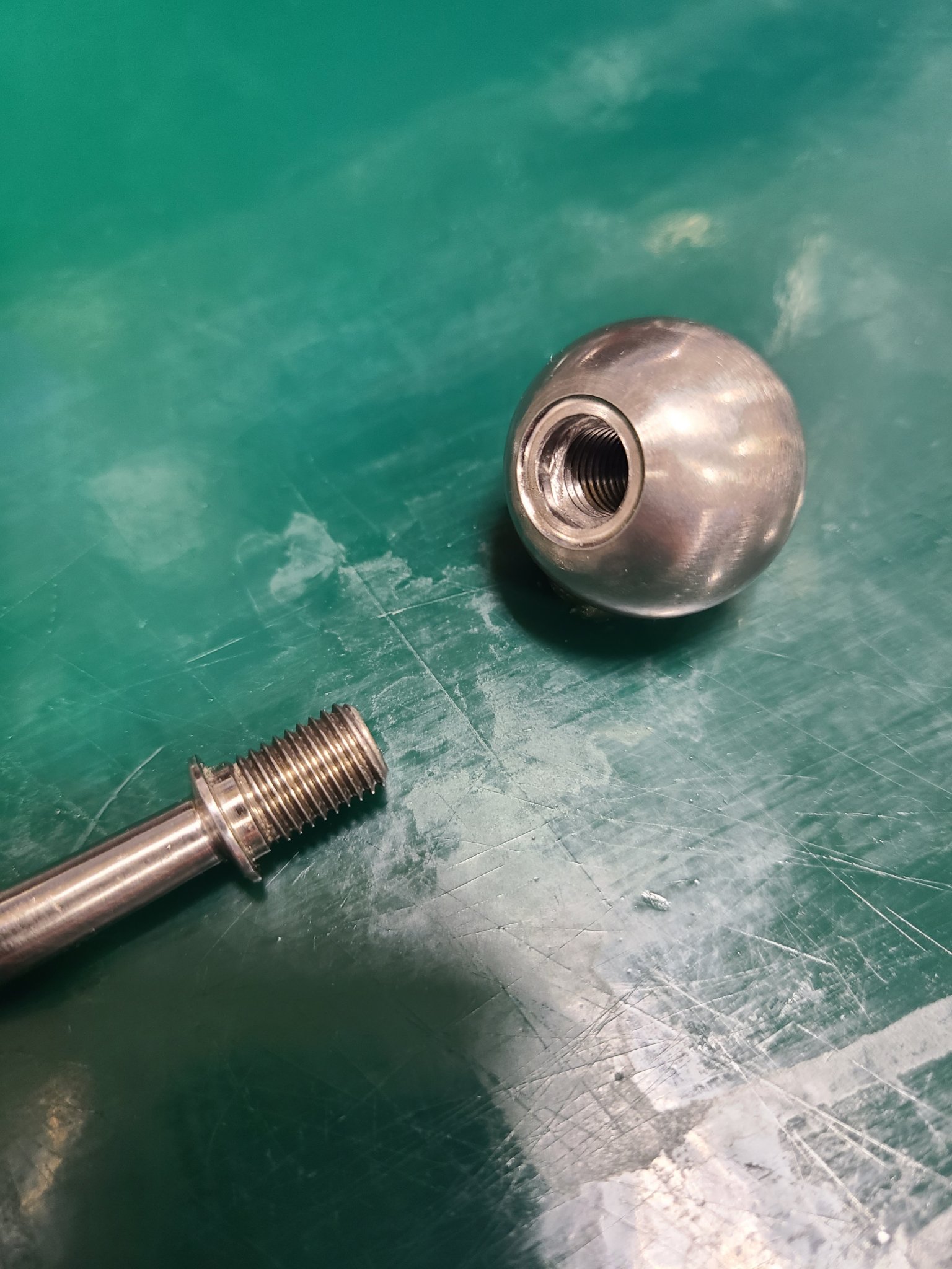

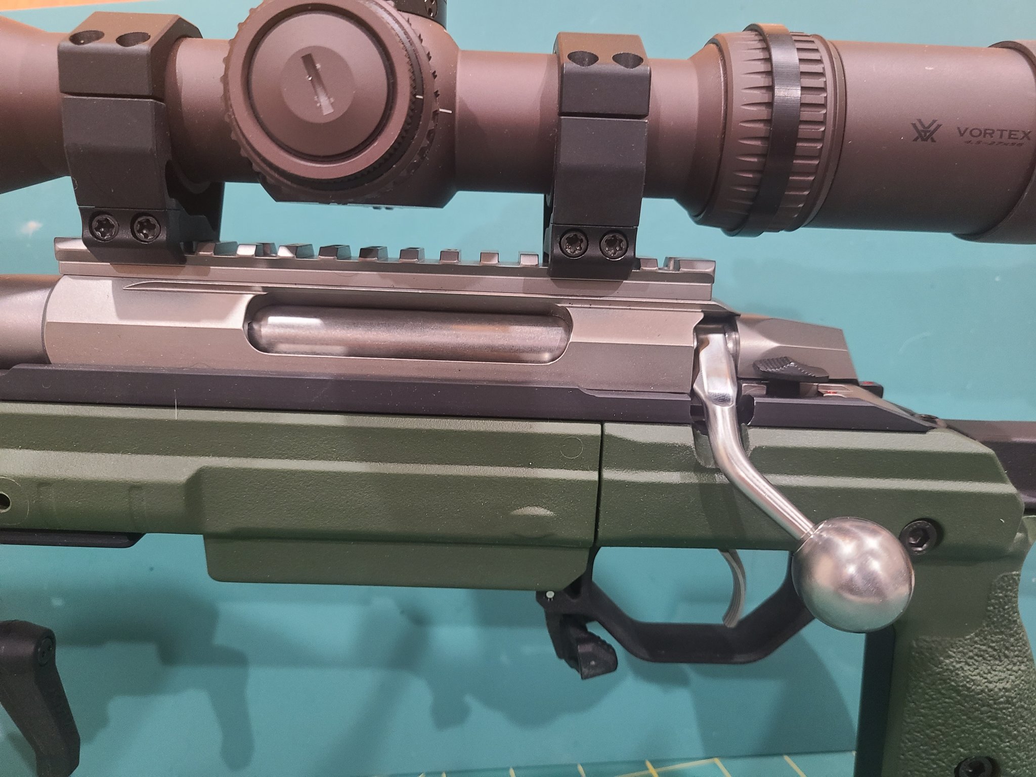

Shroud and handle are Sterk. The ball I switched. Slightly modified anarchy outdoors titanium ball. Wanting to titanium anodize the shroud, ball, and Murphy Precision titanium rail.
I added the shallow counterbore and carbide burr higbee'd the beginning of the thread to accommodate the small unthreaded section.
Any specific reasoning for this? Larger ball I’m assuming? I would be interested in making a similar modification to get it closer to AI match.
Wanted it for aesthetics. Size is the same. It's was all I could find in 6al4v titanium. Even trying to find anything close size wise pre-made in any alloy of titanium was hard. I was prepared to drill and tap a solid sphere if that was all I could find. Trying to keep it the same alloy as the other 2 parts should all anodize pretty much the same color.
If you wanted a different size other materials are much easier to find.
The modifications to the ball is so it would fit properly to the handle.

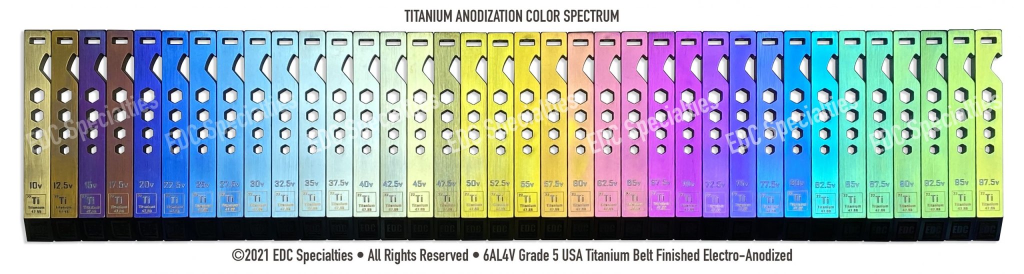

Some of the possible titanium anodizing colors. I'm thinking something closer to the left side of the chart.

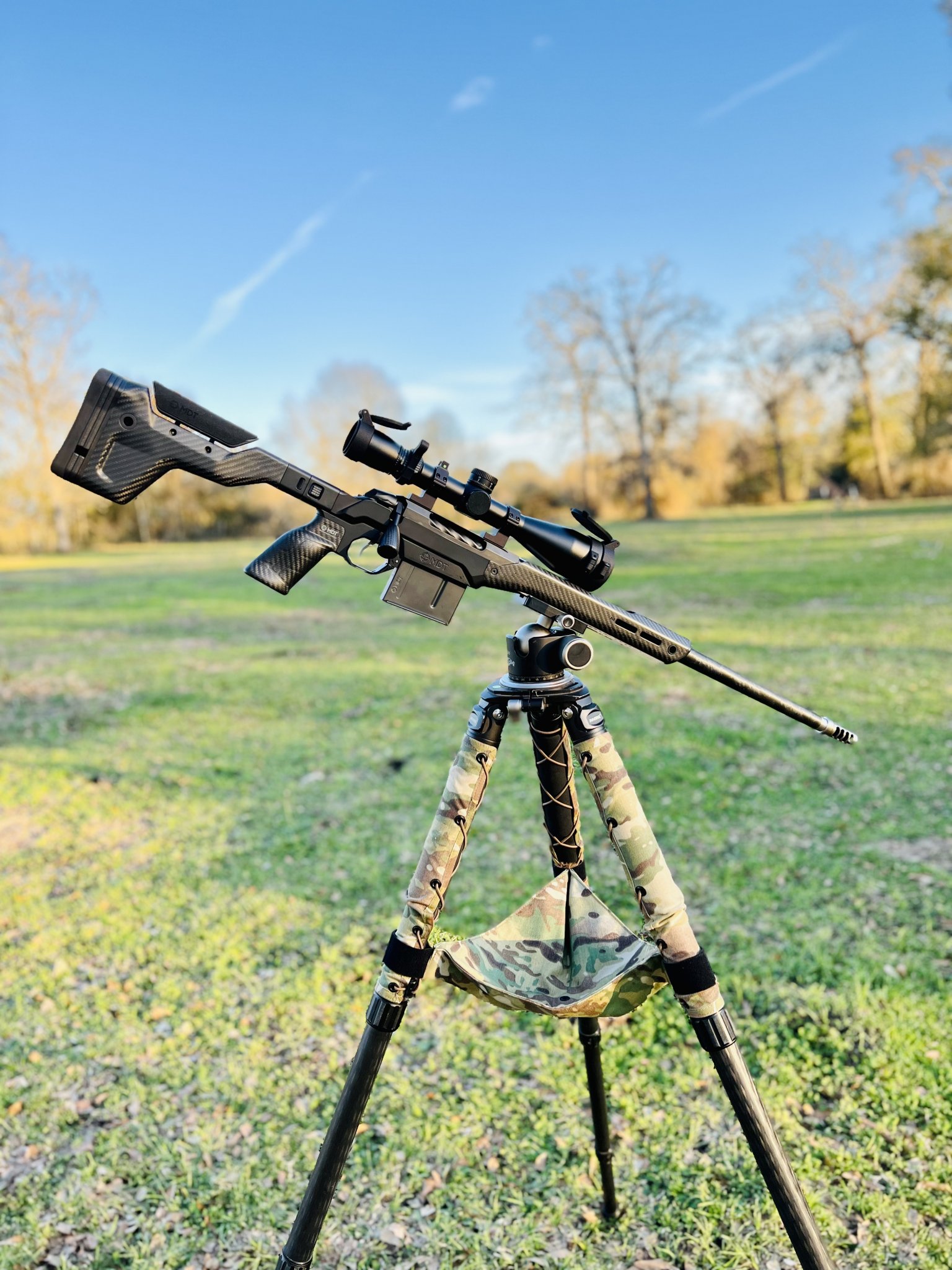

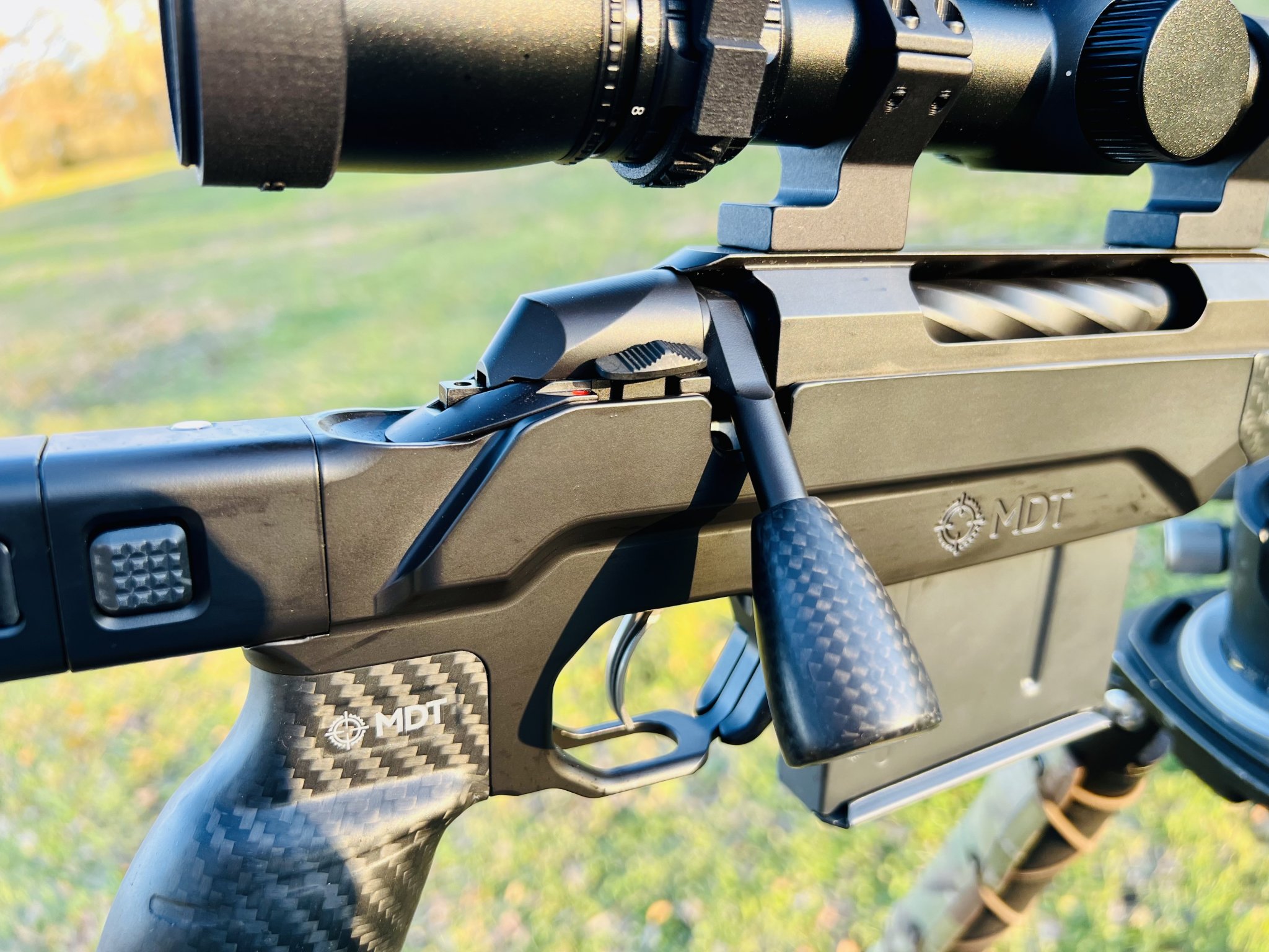

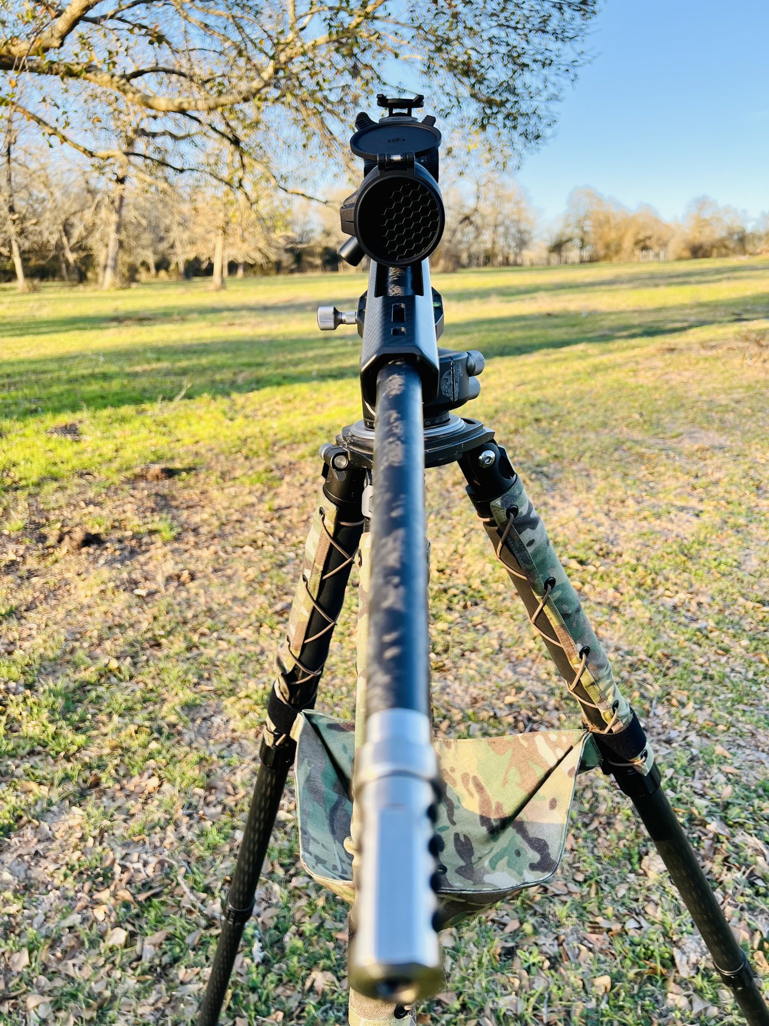

The products for t3x.
Tikka 7mm PRC
LRI fluted bolt
MDT HNT26 chassis
CarbonSix 22” 1:8
SRS Ti Pro 2 ST brake
Vortex Razor LHT 4.5-22
Rifle weighs 8.5 lbs with loaded mag.
Getting 2835 fps with 175gr ELD-X but only 15 rds fired so far.

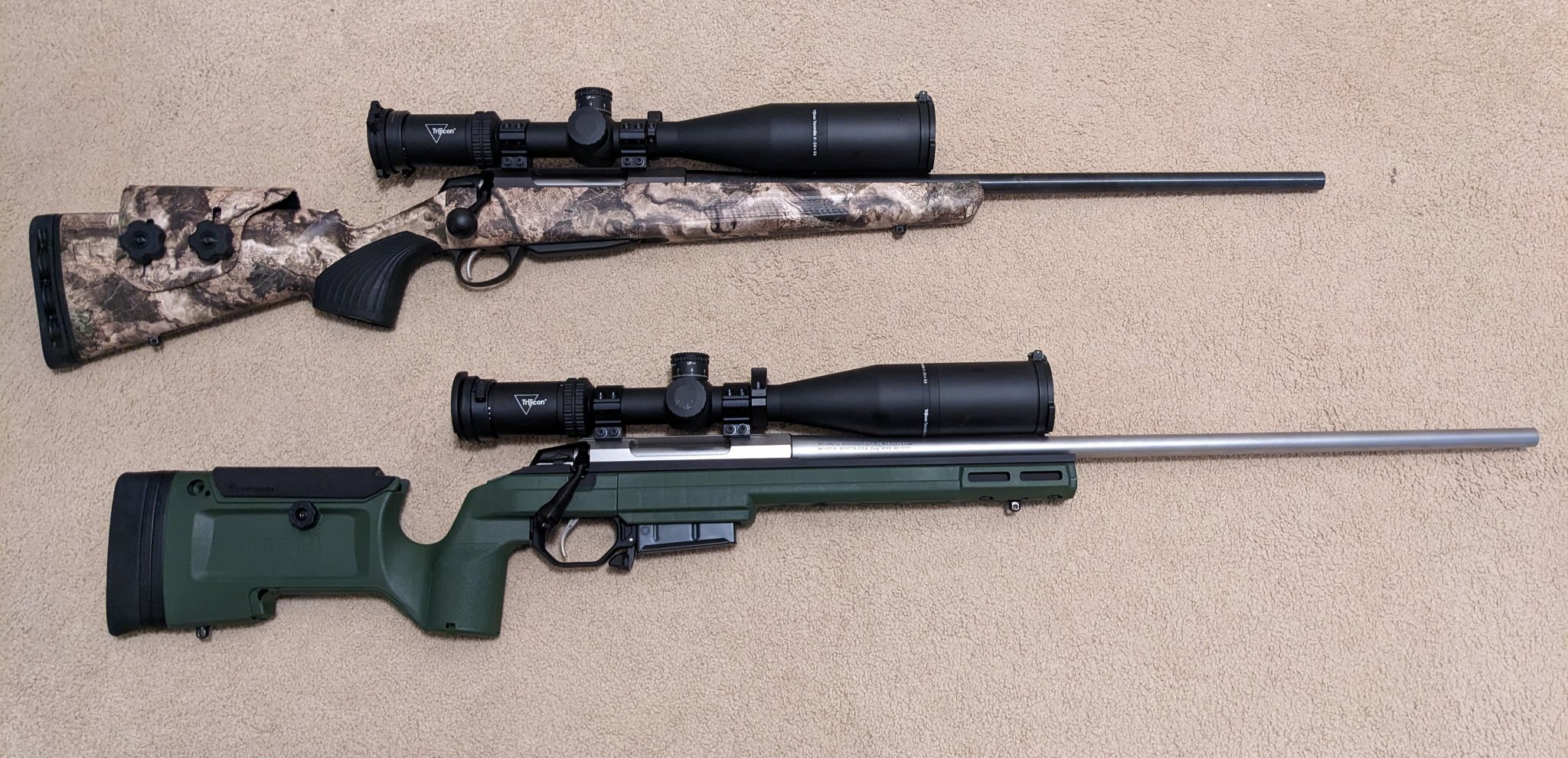

t3x lite 30-06 8 lbs 12 oz
t3x lite stainless 6.5 cm 10 lbs 1 oz
