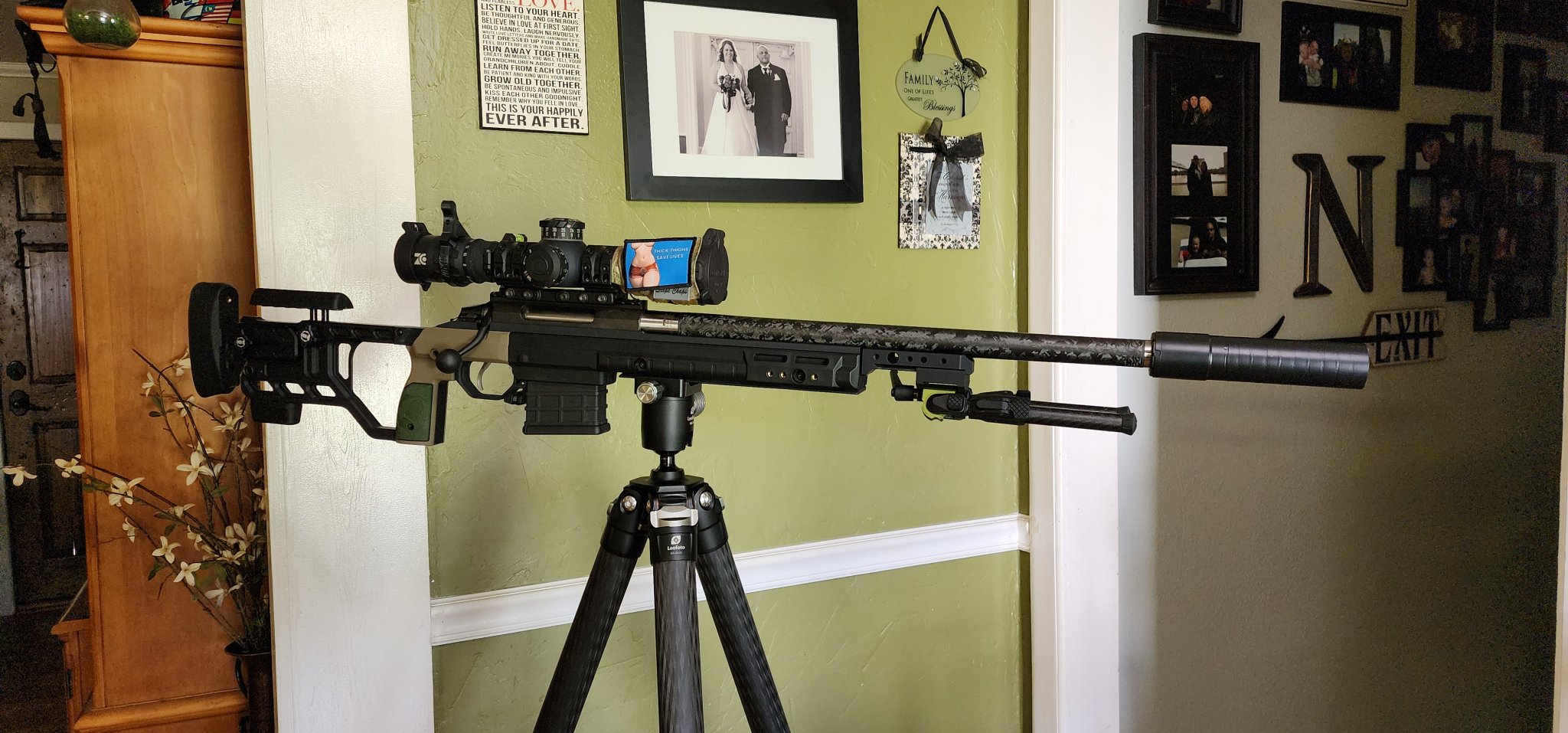

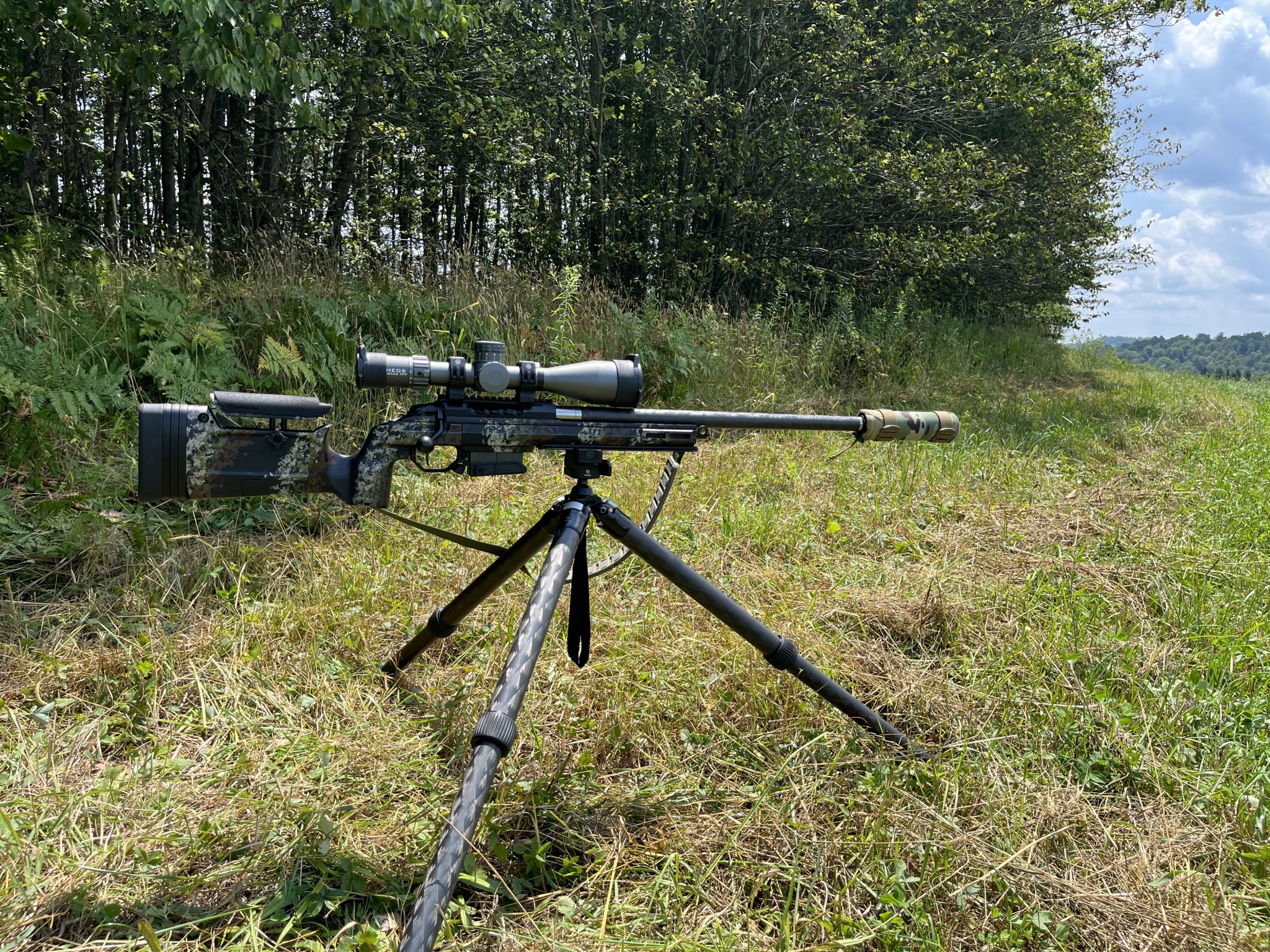

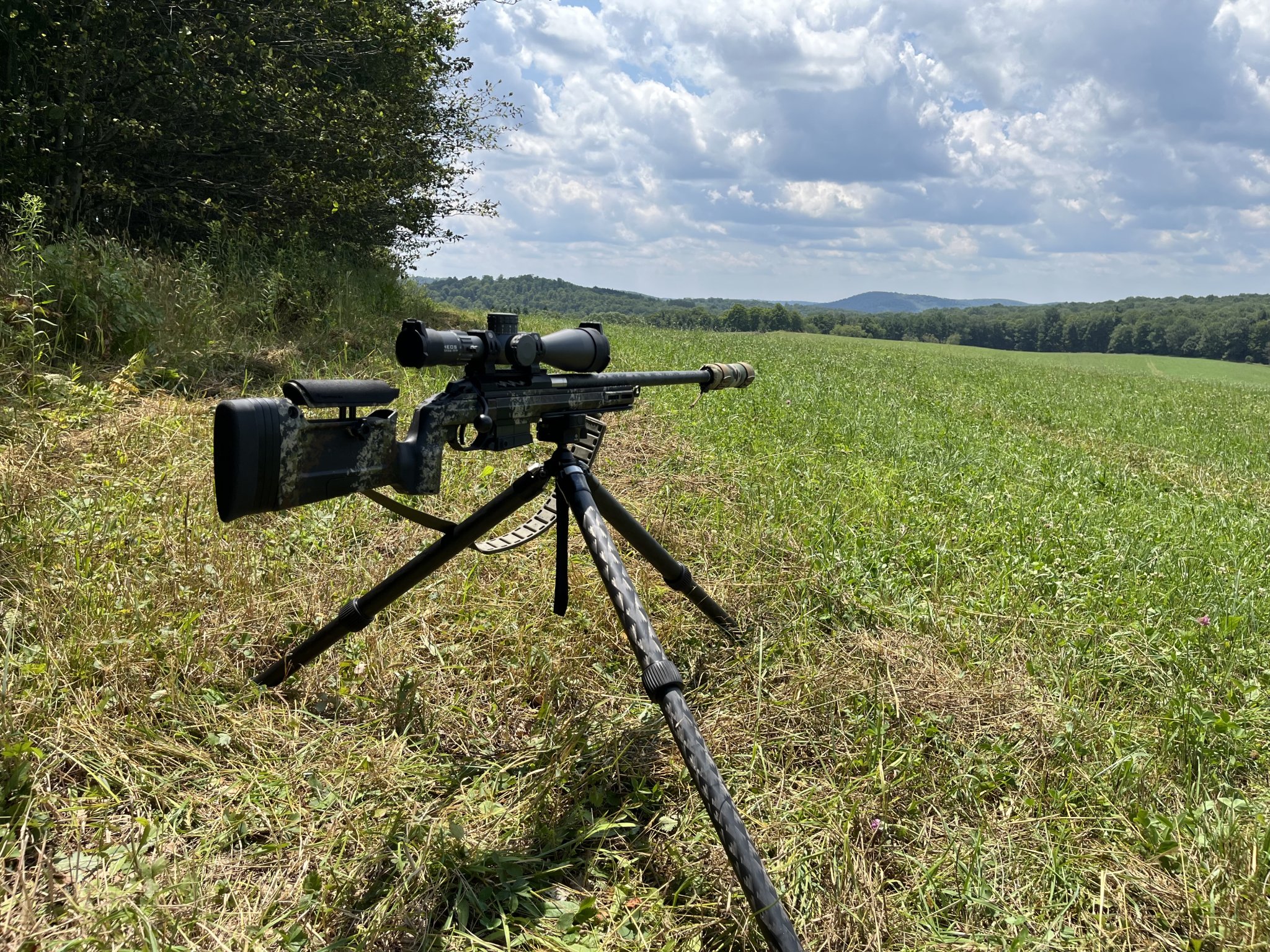

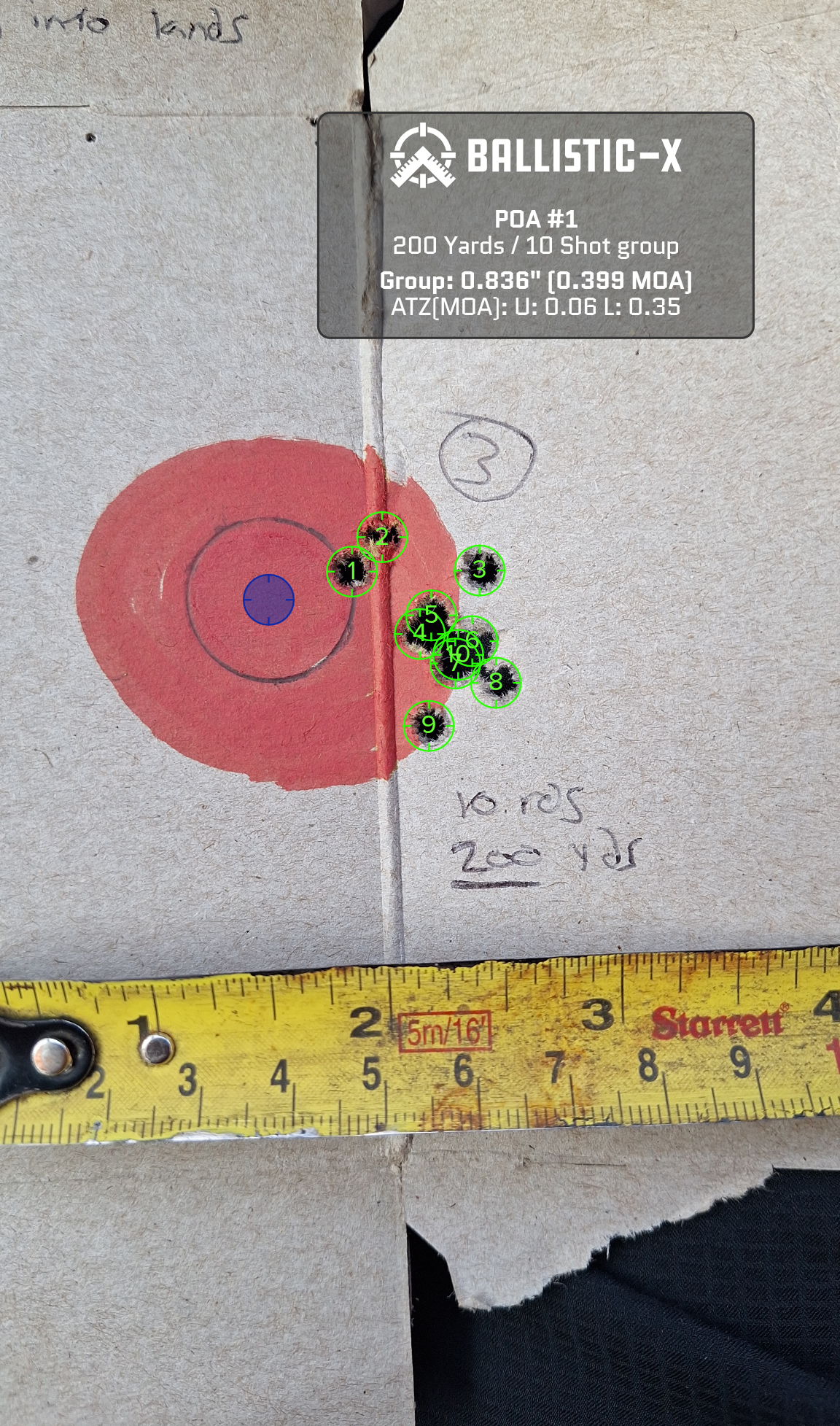

Current iteration of my T3x build
Specs:
223ai 8 twist 28" Krieger Heavy Varmint by PR Precision w/ Heathen brake
PSE Composites Etac w/aics dbm and Tactical Evo adjustable buttpad
MDT 20 MOA rail bonded to receiver
MDT 30mm Elite rings NXS 5.5-22X50
Shooting the 52 smk. Who needs bc if you launch them at ~3700fps? Shooting at or under half moa for 10rd groups to boot.
@ejg represent 🙌 😎 great stock
Specs:
I bet that rifle is fun to shoot. The more you shoot that stock the more hooked you get. I know we designed the E-Tac but even so it puts a smile on my face every time I get behind one. Ever tried 75ELDM's for longer range in her? My T3 and 22-250 loves them.

I was worried this barrel wouldn't clear but it does it fine. It's too easy to shoot honestly. It's all I can do to slow down and not rattle through all my ammo. Therefore I load only 40 at a time for each session.
I need to work with the heavies more. The only issue is they are much more expensive compared to the lighter varminting bullets. I only have access to 200yds at my range. I've shot some of the 75eldm but not enough to form a solid conclusion on them. They are a wicked pill and I bet 3200fps is attainable in this rifle with them.
The hand loaded 223ai can get real close to a factory loaded 22 250. With a lot less powder and small primers to boot. Brass is free basically. You also rarely have to trim the cases. Shoots standard 223 accurately as well so fire forming isn't a hassle either. I shot multiple groups under half moa today with this rifle. Smallest so far measured .349 moa for 5 at 200 yds.

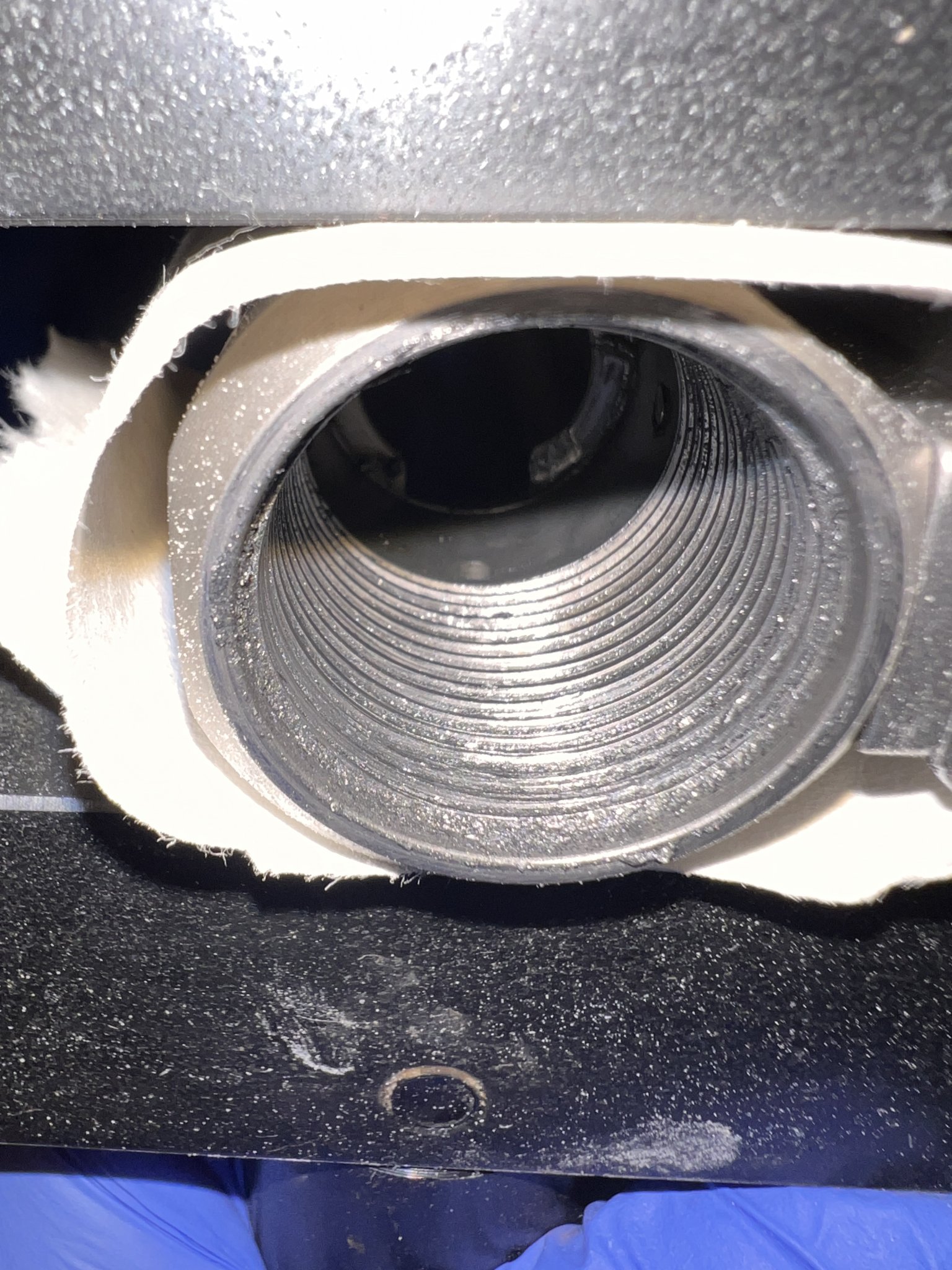

Here’s some pics of the uncleaned action immediately after barrel removal. I think I had only wiped it out the best I could with a paper towel at this point.
Perhaps this will help the post-mortem.
View attachment 8439533View attachment 8439534View attachment 8439536View attachment 8439535
Looks nasty. I have to say I haven't seen galling as excessively spread along the threads as that example.
There is something you could try though.
Years ago, I worked in a factory where everything was either 304 or 316 SS. Was a real PITA working on anything & everything with a thread. What we worked out was that you can apply too much ant-seize. After speaking to a Stainless Steel guru about the issues we were having with galling threads with anti-seize on them, he told us that there can be too much anti-seize from the perspective of heat retention & pressure, (more heat created). Heat is the main enemy of 316 SS & too much anti-seize creates a situation whereby the heat of friction is retained & in some cases amplified in small surface areas.
What we ended up doing was to heat the male threads, where possible, to 100 to 200 c. Just hot enough to make the anti-seize melt instantaneously & smoke a little on contact. This causes the anti-seize to spread very thinly & evenly over the surface of the threads with no build-up. Just a beautiful even, thin coating. Allow the part to cool completely before assembly.
I won't say this stopped 100% of issues but, our lives became a lot easier & frustration free, for the most part.

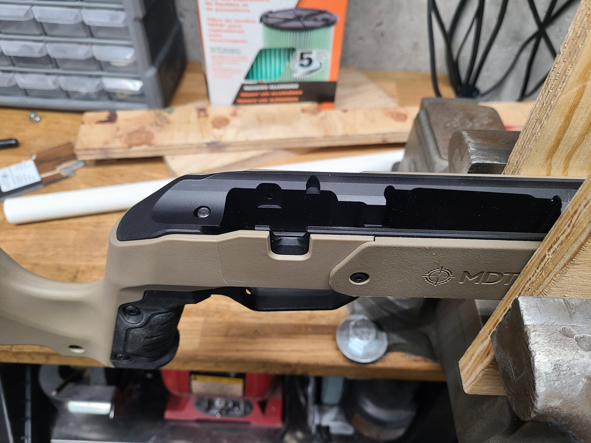

I recently received my Tikka T3x Super Varmint. I’m planning to build a 1,000m rifle with a MDT ESS chassi. I bought the lower chassi part and stock, and also a couple of the hand guard .
I tried to remove the picatinny rail from the rifle, since the MDT rail is needed with the full rail hand guard. But it seems impossible the loosen.
I’ve read about rails that need some heat to remove. But I wanted to ask if it’s possible to remove the rail at all on the Super Varmint, since someone said it’s integrated (milled) into/with the received.
But if it’s part of the milled receiver,
It’s seems a bit unnecessary having the screws on the rail…
Interesting! Good tip.
When I grease things, less is more, for sure!
Someone put some sort of grease on those threads. Maybe that added to my probs. After speaking to a gunsmith on SH, he agreed with me that I probably am to blame by clamping the external action wrench on too hard.
Was hoping there were some additional, not-me factors but probably not. Funny thing is, the vids I watched didn’t mention to clamp the wrench snug but not too tight. When trying a new thing, I usually over-prepare!
Learnin’ the hard way…

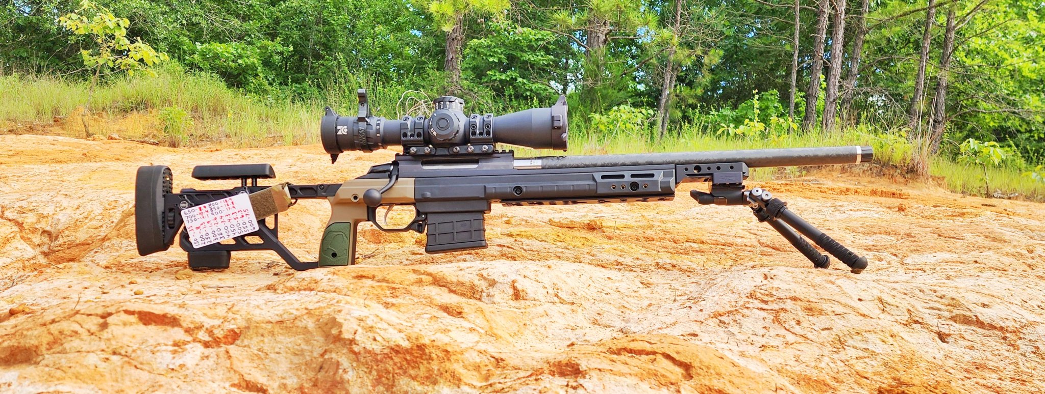

Taking the trusty 6.5 CM CTR out today on some steel. Been using the 140 ELD for years but just grabbed some Berger 144 LRHT to try out.
Been thinking of converting to 25 creed next barrel but probably just going to build another gun on a solus action. This is still my favorite gun

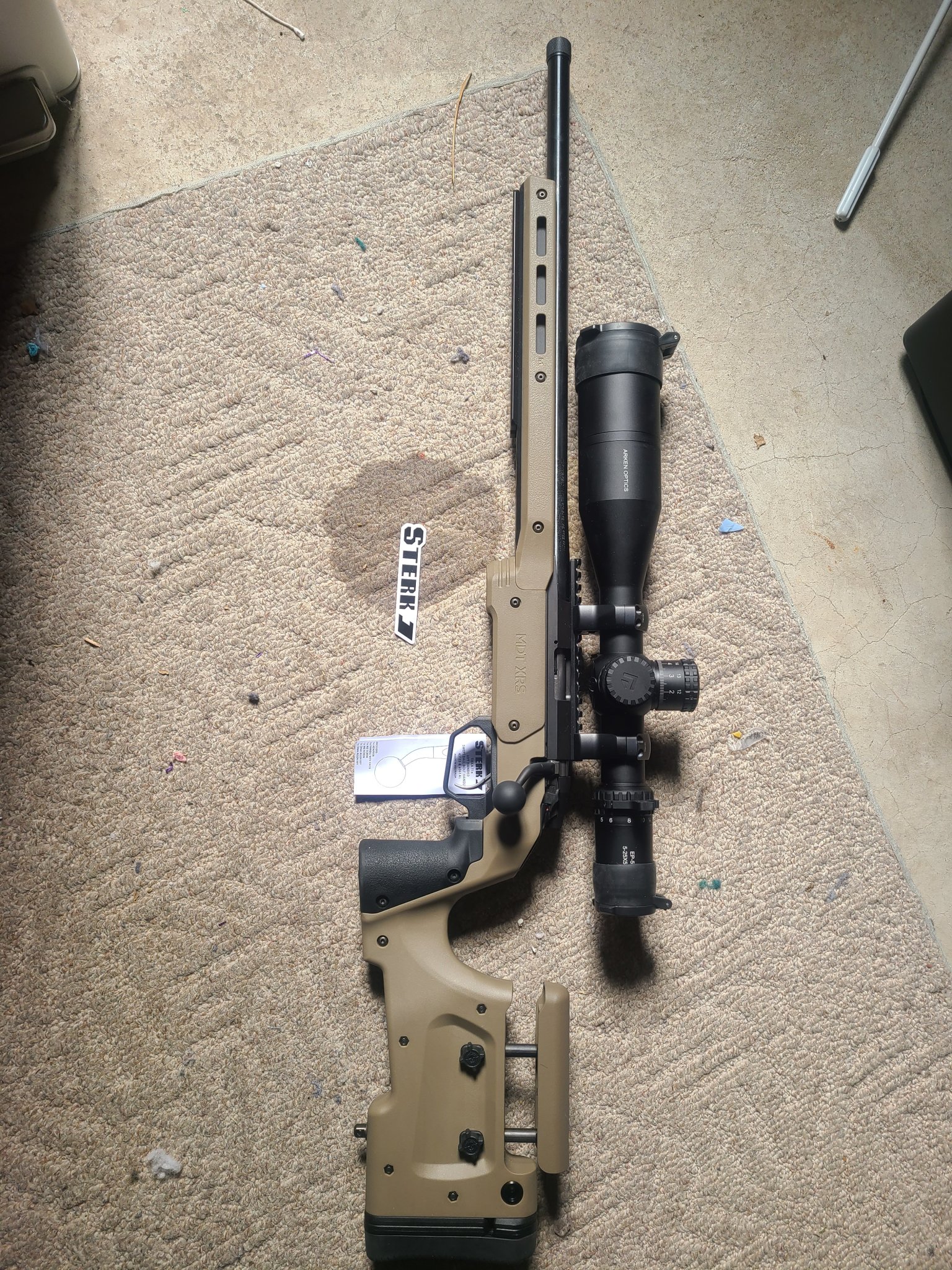

got a 20 MOA NF base for the tikka. Old one came off easy with a slight tightening of the mirage band screw followed by a torch to the top. It lifted off easy. I looked at the old base and new and decided I could poke a couple holes to reuse the recoil lug pins. Just clamped the two together, lined up the screw holes with a tight fitting Allen key and drill bit and popped the other two holes.
It’s sits down on the two pins very nice and snug. Old locktite was removed with a dremel and wire wheel.

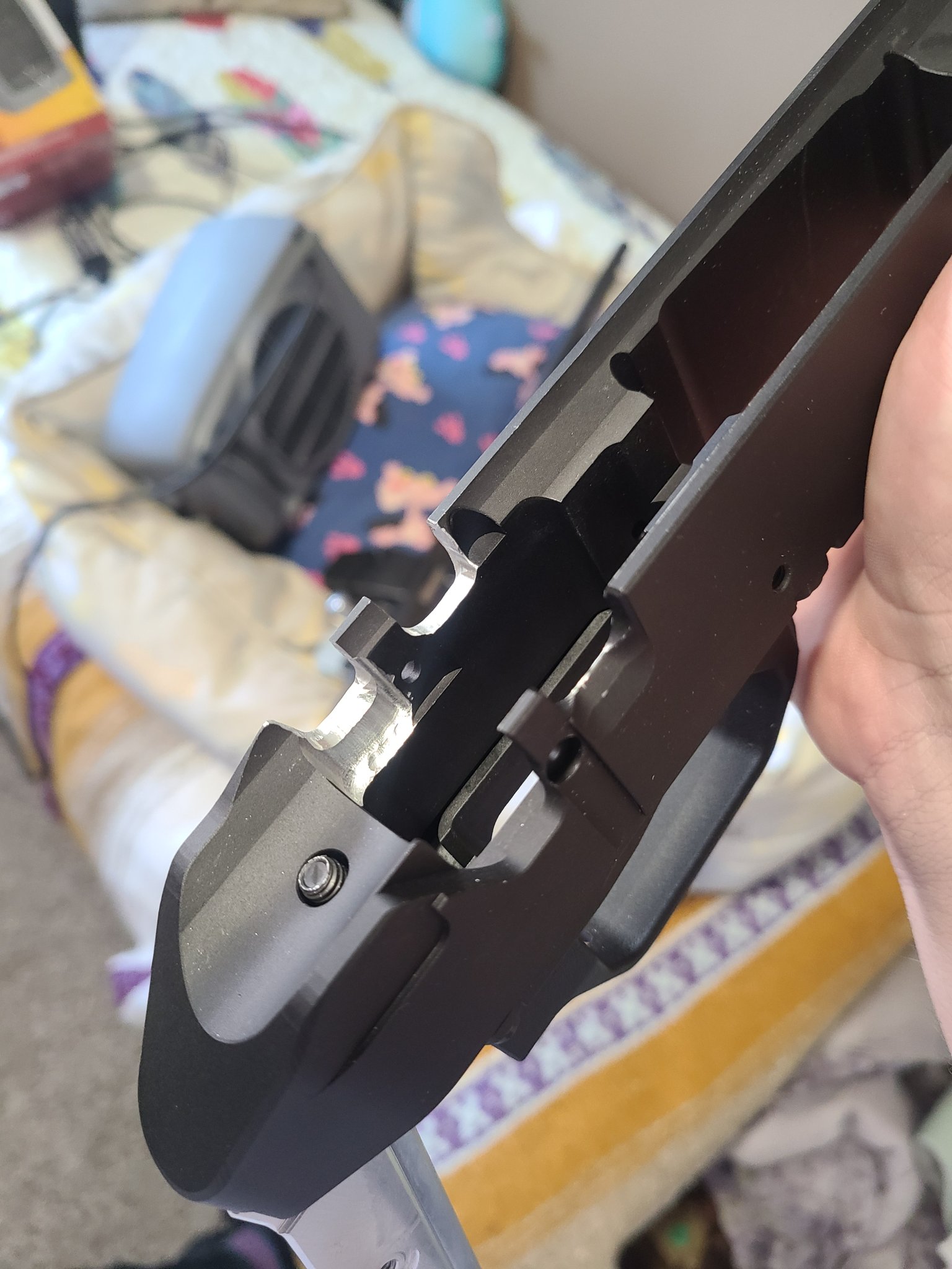

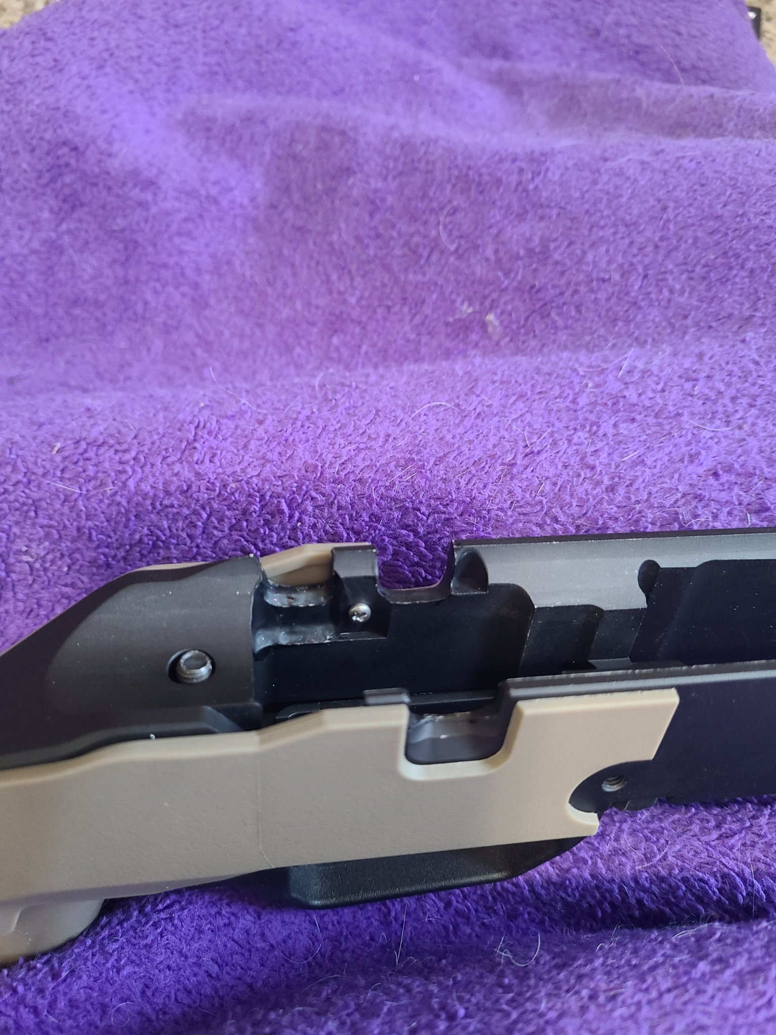

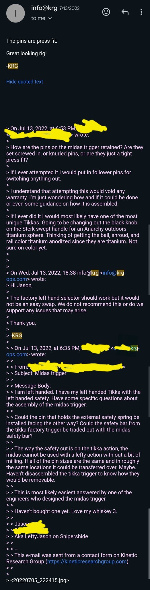

Lefty, once again a Co. figures it's not worth the investment costs to offer a LH version . And did you catch the note, may only work with our $$$ chassis's ?
I'm getting tired of pussing the the OME trigger with the spring replacement on my TAC 1, come cooler weather I'll probable offer it for sale to my club and start from scratch w/ a LH custom action that takes 700 style triggers.
What are you trying to accomplish with changing the trigger? You already have a 2 stage trigger.
Per the other thread that you have posted in and I have linked to you before, per krg you can change the safety lever (that you already have) over to the midas. What more do you want?
You've been into left handed guns. Having anything left handed at all is great. So what if you have to modify it yourself? That's common. Find any chassis that is left handed for a tikka from anybody. They don't really exist.
If you would rather have a single stage I will straight trade you for the one you have.
So what 700 trigger are you going to go with?
Btw modifying a chassis to fit a lefty isn't hard at all.
My Mdt Xrs that I modified to lefty.
Little too thick on the nail polish but it's covered.
Minus the tbac 22td that is normally attached.
