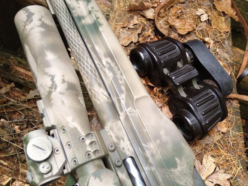

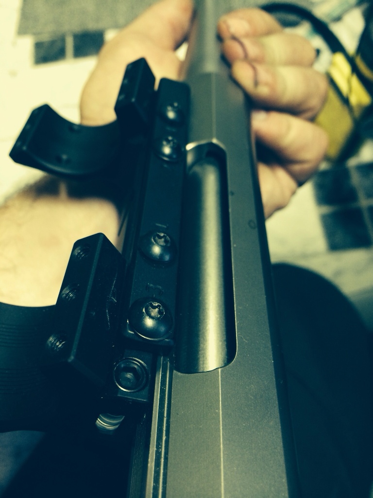

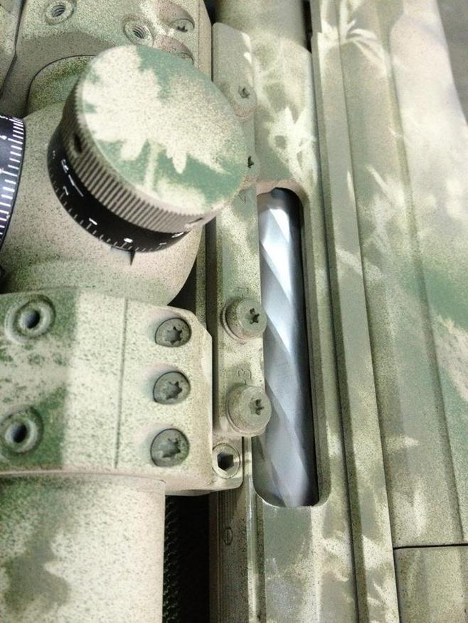

Here is a few Pictures of my T3 in 6,5 with the ejectionport opened 2,5mm or 1/10".
I am using the ST-4701
Håkan

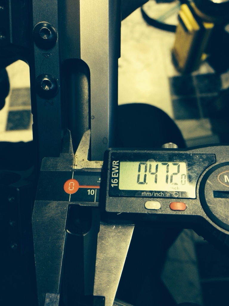

Thanks for the photos. I haven't got my new scope yet, but I tested the mount, and the ejection port definitely needs lowering. It looks like you've also flared it a little at the front. Is that correct? How did you go about the lowering? What kind of tool did you use?
No the mod is only if you're using the Spuhr mount. The T3 runs fine with traditional rail/rings setups. A little work on the ejection port wouldn't hurt though, I personally like to be able to get my grubby fingers in there if necessary.

I addition to lowering the port .100" on .308 sized actions, I also bevel the bottom of the clamp (directly above the ejection port) on the Spuhr mount (sorry Hakan, you make a very fine product, I have many!).
On the .223 size action, the bevel on the clamp is all that's needed, no port lowering is necessary.
