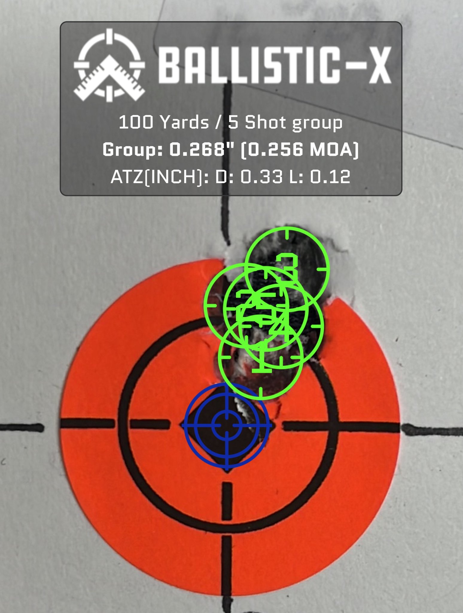

Just wanted to share a magical load I’ve developed with my T3X CTR (24”) in 6.5 Creedmoor.
Proof is in the pudding. .256 MOA at 100 yards. See below.
40.9g of H4350 under Hornady ELD Match 140g. Starline small primer brass. 2.2540 Ojive measurement.
Pure magic.
Yes, what was the bullet jump, and velocity? I have the T3x Tac A1 in 6.5CM, which is the same weapon but in a chassis. Your ogive is 0.036" greater than mine of 2.29 (.02 jump). My load is 41.9gr of H4350 in Lapua brass with CCI BR4 primers, average 2707fps. Of course, your precision is better than mine - five, five-round groups averaged .344"
