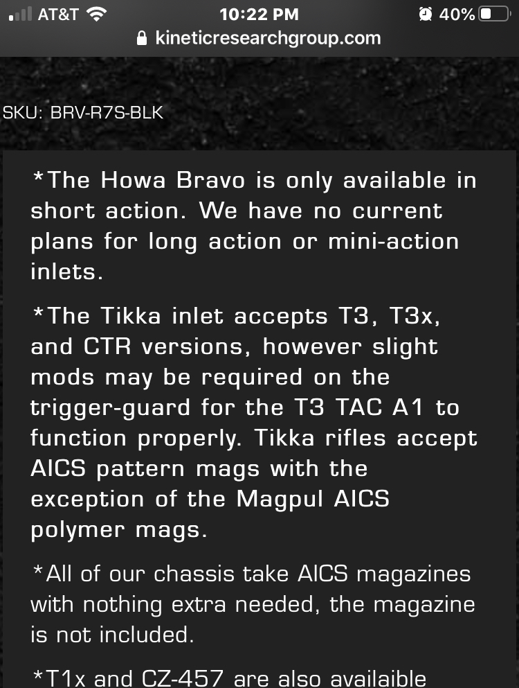

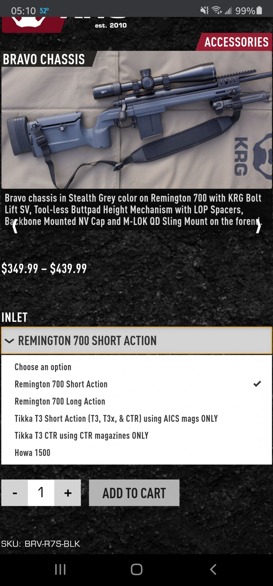

KRG Bravo for Tikkas use AICS mags, not Tikka Mags.
You can get a Bravo for the Tikka that will use just the CTR mags not sure if that is the version he has or not. If he does have the AICS only chassis that could well be his problem.
