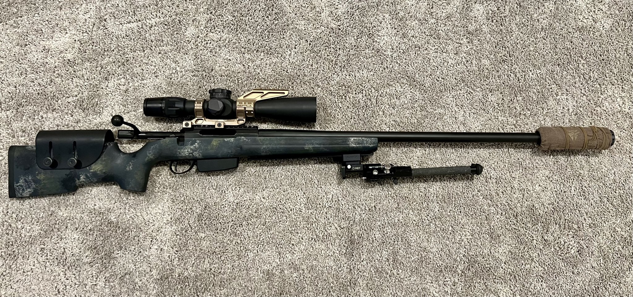

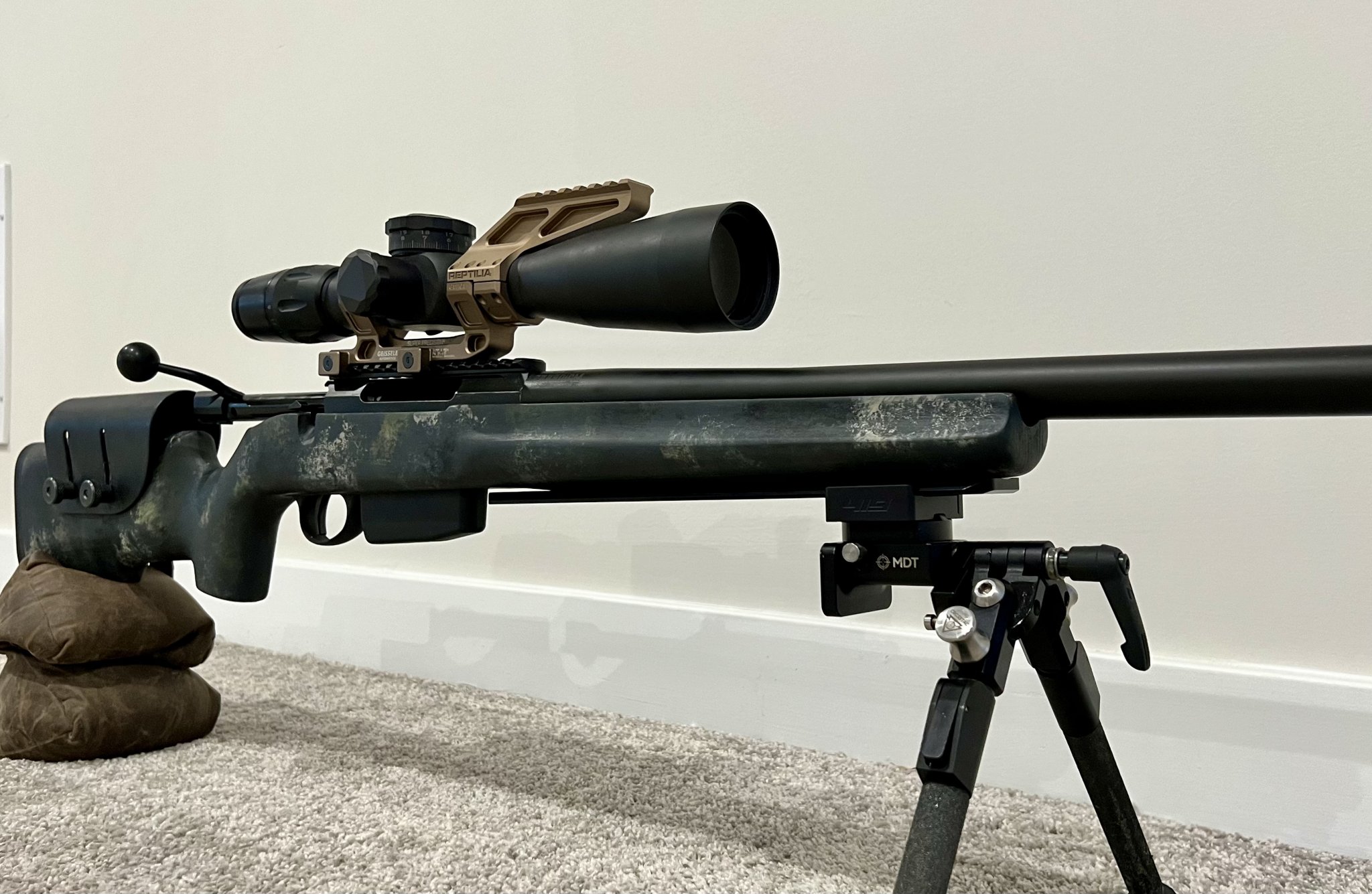

Had a .223 barreled action sitting around so I picked up a cheap Boyd’s stock and decided to do my own take on a Super Varmint. Completely bedded and refinished.
Have since added Waters Rifleman 10-round mags and an SRS full length Arca rail. 75 ELDs around 2950 🤌🏻🤌🏻
Nice. That sorta looks like a Pro Varmint stock, although maybe the forend is different. I have a walnut PV and it’s super comfy. Having a CZ 17 Hornet installed in it and just got word that it’s done.
Noce paint job too. 👍

Yes you are correct - it’s a pro varmint. Picked it up as a project stock needing a lot of work… drilled out and installed pillars, cleaned up the inlet and recoil lug area, and opened up the barrel channel. Bedded the bottom metal and action with MarineTex, and then new paint on top of all that.
Works great now but it was a labor of love for sure. The SRS full length Arca fits great on the PV forend if you need something for it. Slightly radiused on the top so it sits nice and flush. Only spot it doesn’t is back by the magwell where it kinda steps down, but overall it’s impossible to tell.

Was that rail installed in that pic you posted? I can’t see it…maybe it’s is countersunk (term?) down in there?
I had a Henderson or SRS 3-4” rail installed right in front of the magwell as I sorta hate a full-length rail. I want some wood to grab onto, ya know?

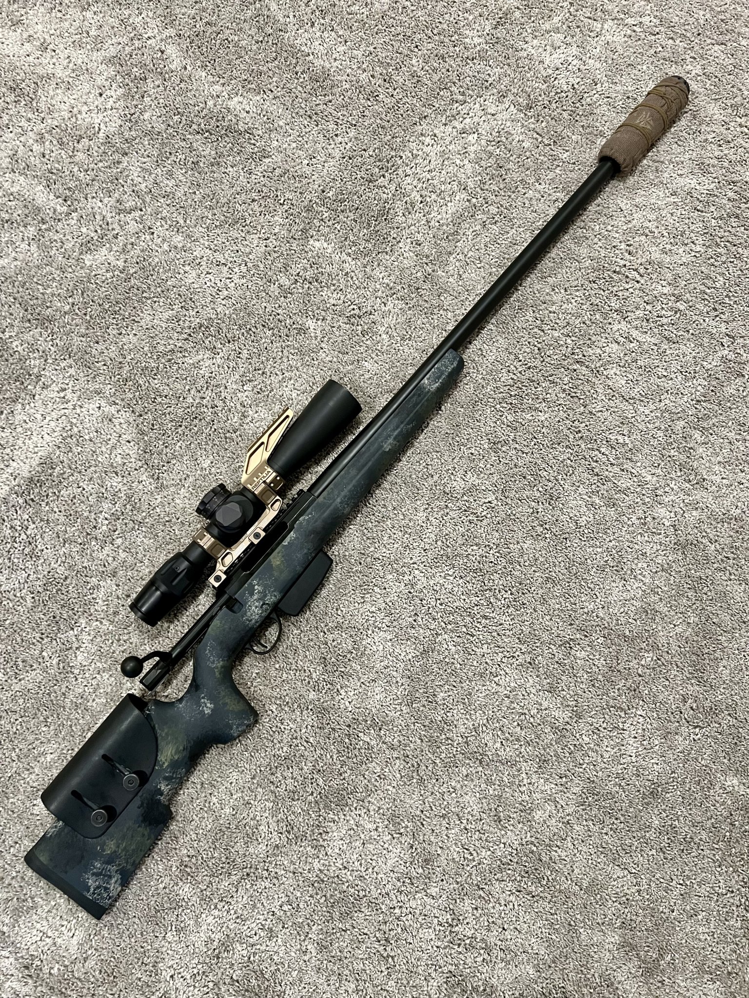

No that was before I had the rail installed. Here it is with the rail. Kinda shows you what I was talking about in front of the magwell… there’s a little step-down that creates a small gap.
You could remedy that entirely by pushing the rail out further towards the muzzle. I just wanted the flat surface for bag stability.
Yeah, that little step down bit is where I snuck in that short rail. Thx for the pics!
