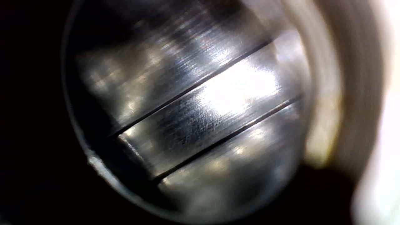

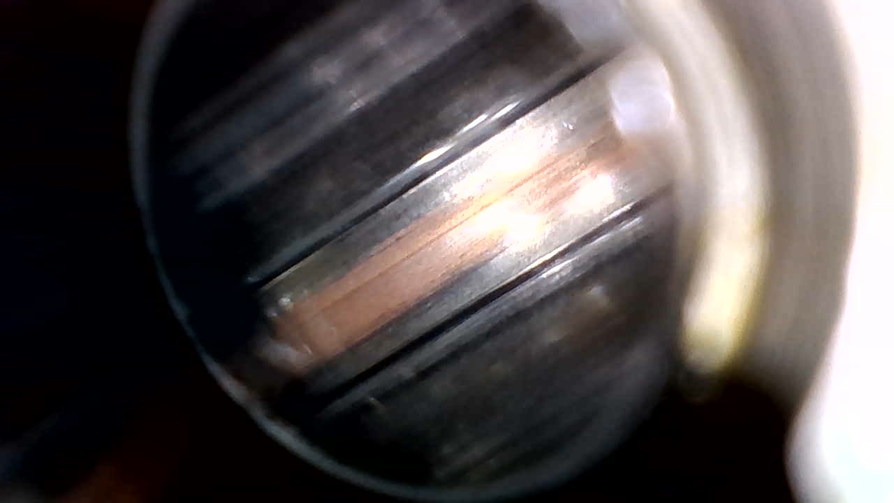

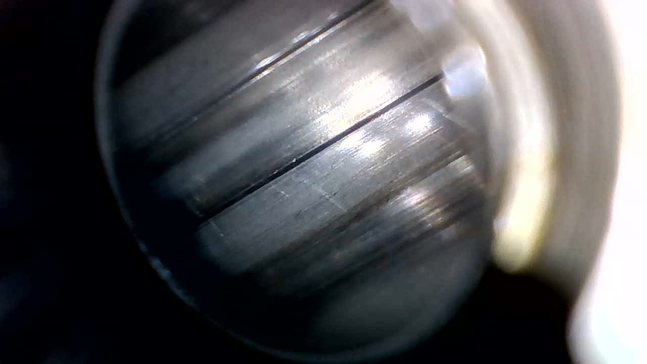

Prior to firing the weapon I soaked the bore with BoreTech by plugging the chamber and soaking it for 24 hours.
I then rescrubbed it with a plastic brush, and then ran patches until no blue showed up.
I then took some CLR and a bronze brush with a drill, and cleaned the chamber / throat to remove and carbon buildup.

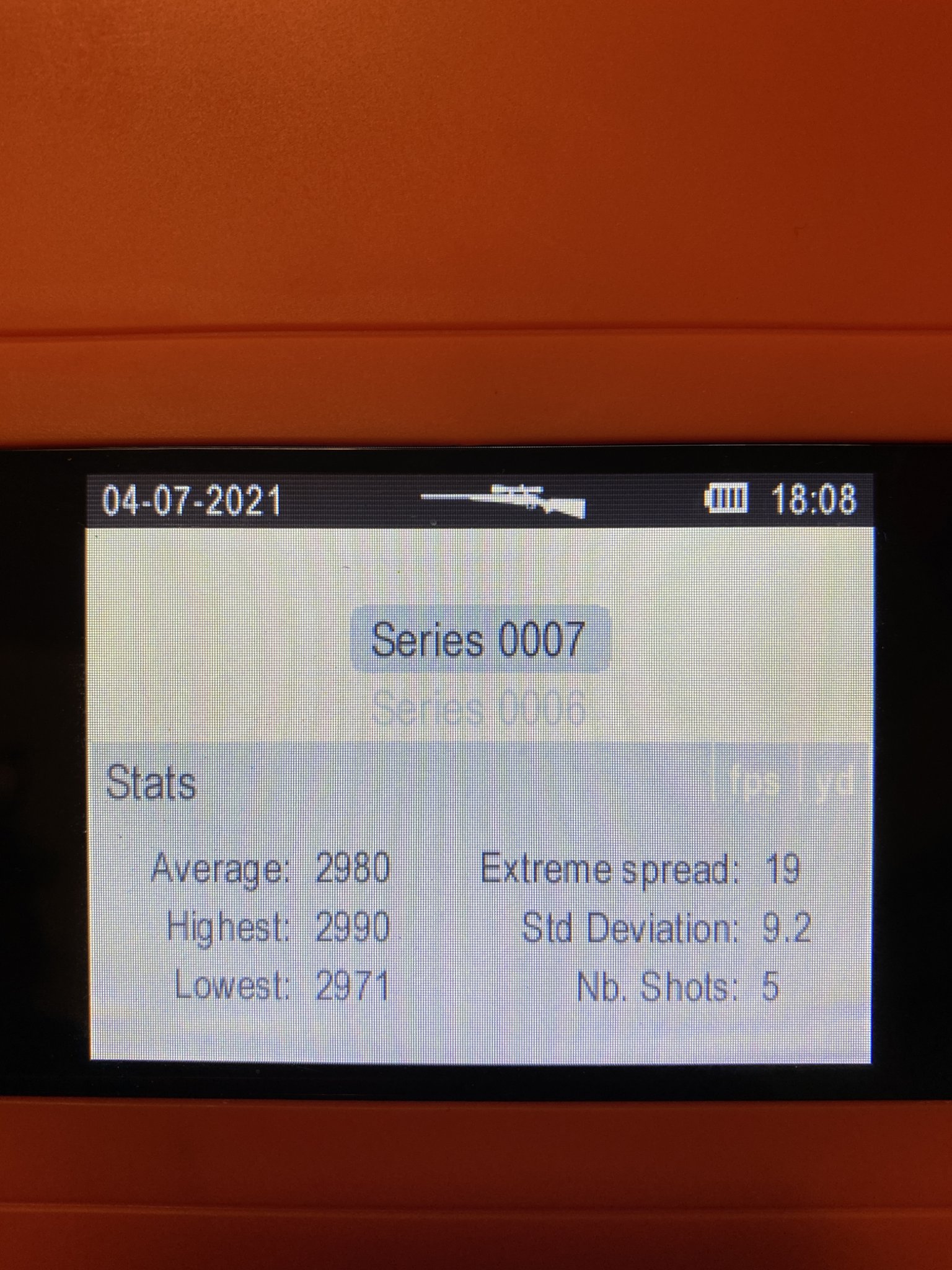

I was able to test fire the weapon with several different types of ammunition:
- S&B 140 BTHP (shoots sub MOA)
- Prime 130gr
- Hornady 147gr ELD M
- Sparks 135 Berger
- Sparks 121 Lehigh
The boxes indicate that the 2 Sparks ammo types should be moving at 2850 and 3100 FPS respectively.
While they are definitely hot, they are definitely not moving quite that fast.

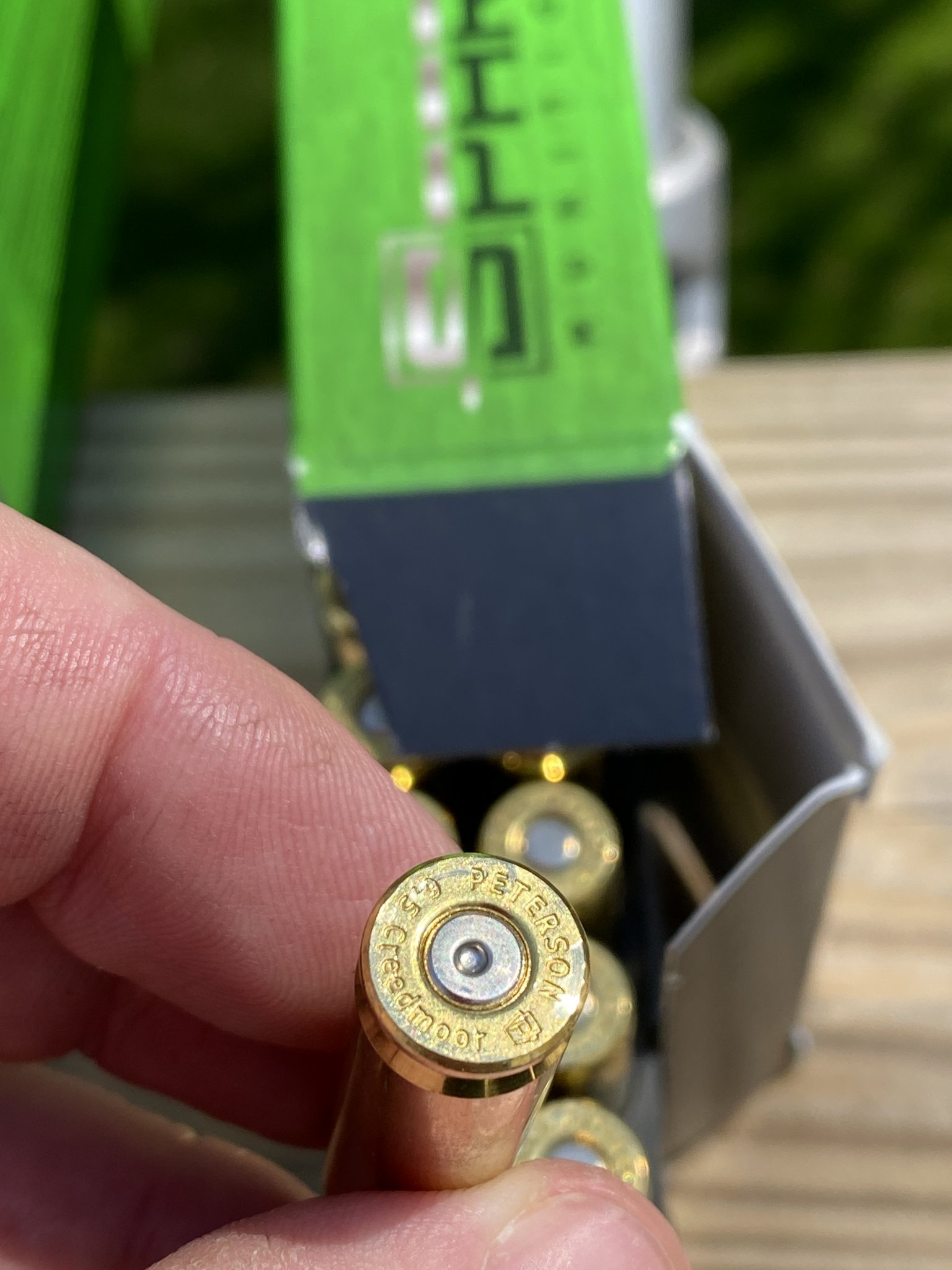

What I found was that with a thorough chamber cleaning and shooting the firearm without a suppressor the bolt still sticks with the 121gr Lehigh load.
Conversely, the bolt was not as obviously sticking with the 135 grain Bergers.
It did not appear to matter whether or not I used a suppressor.
So that means the Teaka doesn’t like really hot sparks ammo...

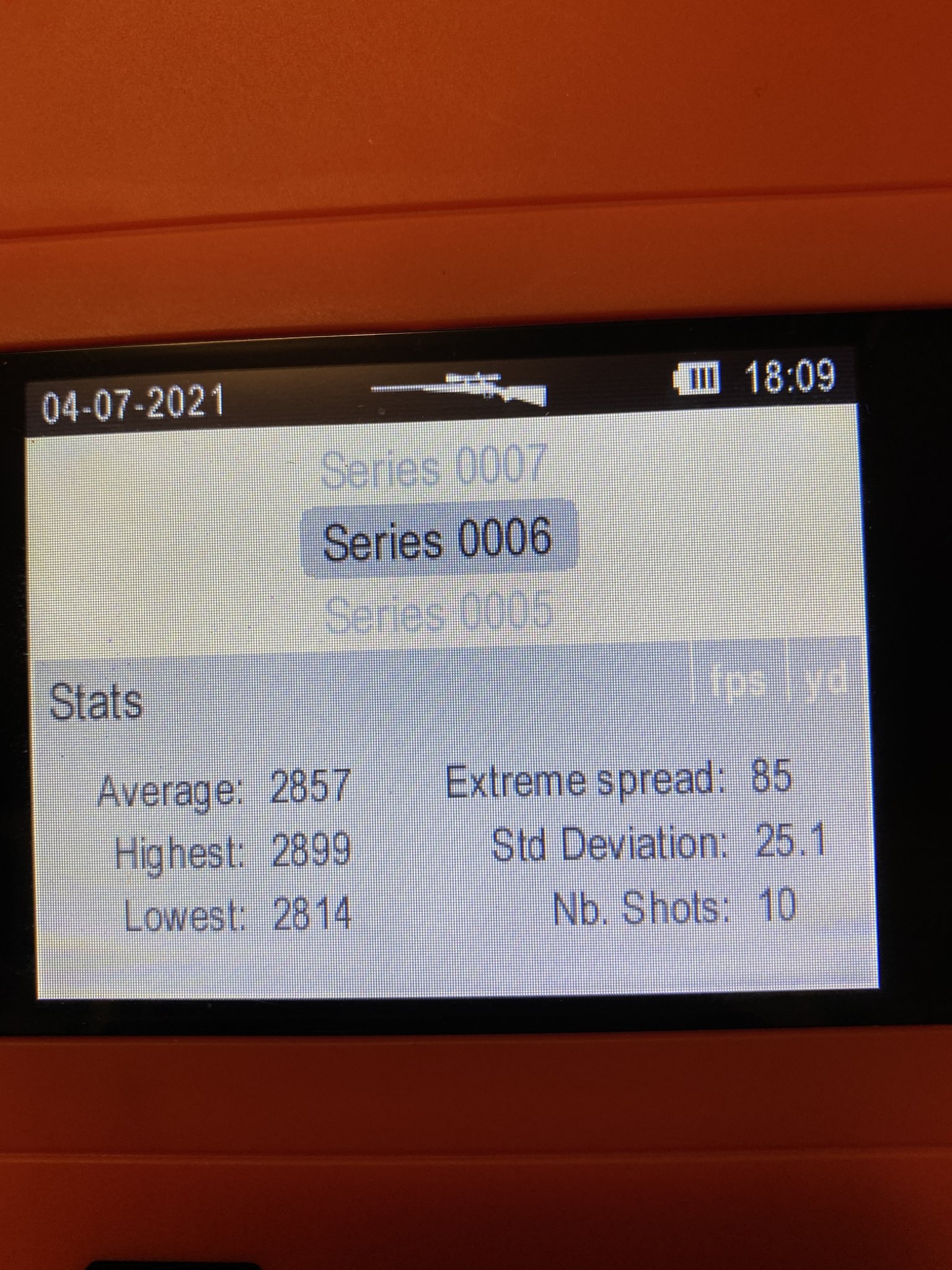

121s:
The 135s:

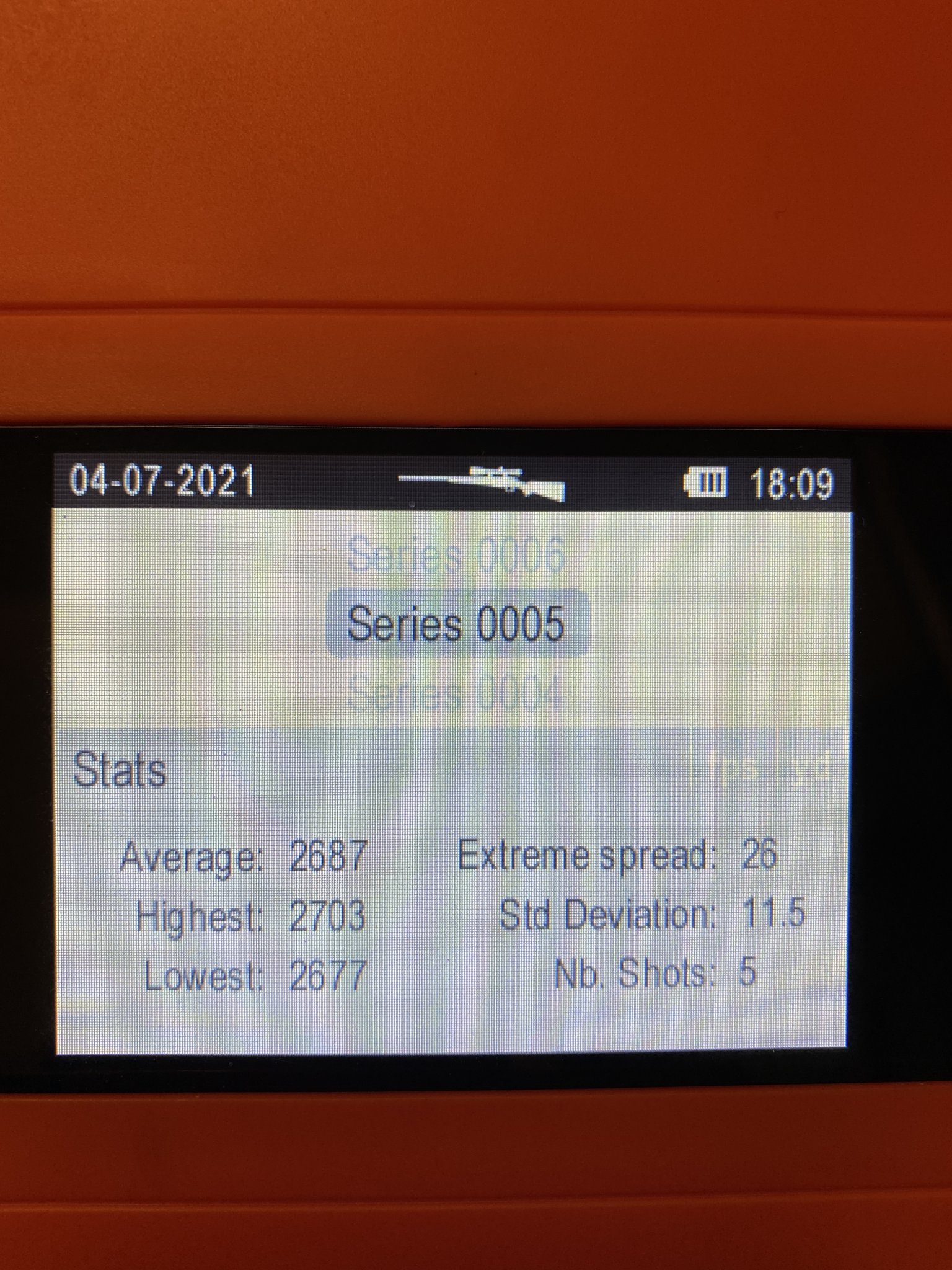

The shocker... Serb ammo (S&B):
