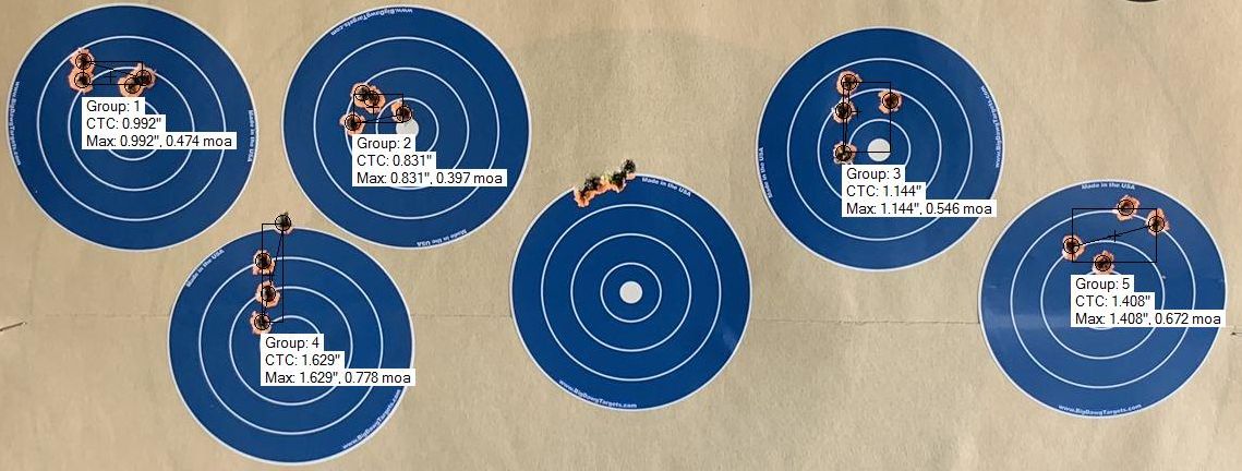

I'd gotten some 120g SMK for break-in sight-in but really wanted to try some Hornady 140 ELD-M with RL-16. This was my range day Friday.
center group (no data) was a test to see maximum load. 5 shots total at 100 yds. loads were 40.0-42.5 (.5g increment). I think a very interesting result. no significant pressure signs
next 5 groups (with data) are seating depth test using a fixed load of 40g for all. L to R and T to B, 4 shot groups at 200 yd starting at .005 off the lands with a .010" increment.
It looks like I'm going to love this bullet. Next week I'll try some jammed and will do a ladder test at .015" jump. At .005" jump I had all the case neck filled up and the rounds easily fit in the MDT magazine.
