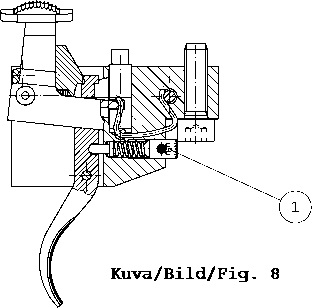

I found this diagram online. It was labelled as an M558 trigger but looks similar to the T3/T3x trigger.
Does this look like an accurate representation of the T3/T3x trigger to you? I thought the contact surfaces on the trigger and sear looked quite narrow and potentially difficult to polish.
Did you have any problems disassembling and reassembling the trigger. All the pins in my trigger are staked.
Thanks. I saw that post but was hoping to squeeze you for a little more info if possible. I have a Tikka trigger that adjusts down to 2.8ilbs with the factory spring and 2.1lbs with a Yodave spring.
Did you just polish the contact surfaces between trigger and sear? What was your polishing process?
It's pretty accurate.
Taking apart the trigger I took a dremel and removed the staking on one side. The safety holds a spring and it is kinda hard to put back together (needs a pick).
My process was to stick wet/dry to a good square machined edge using pressure sensitive adhesive. I worked up from like P800-P2500 keeping the paper wet with soapy water. I just polished/squared the edges. I adjusted the amount of engagement by taking the nub that the trigger sits on to increase the length of pull before the break slightly because of personal preference.

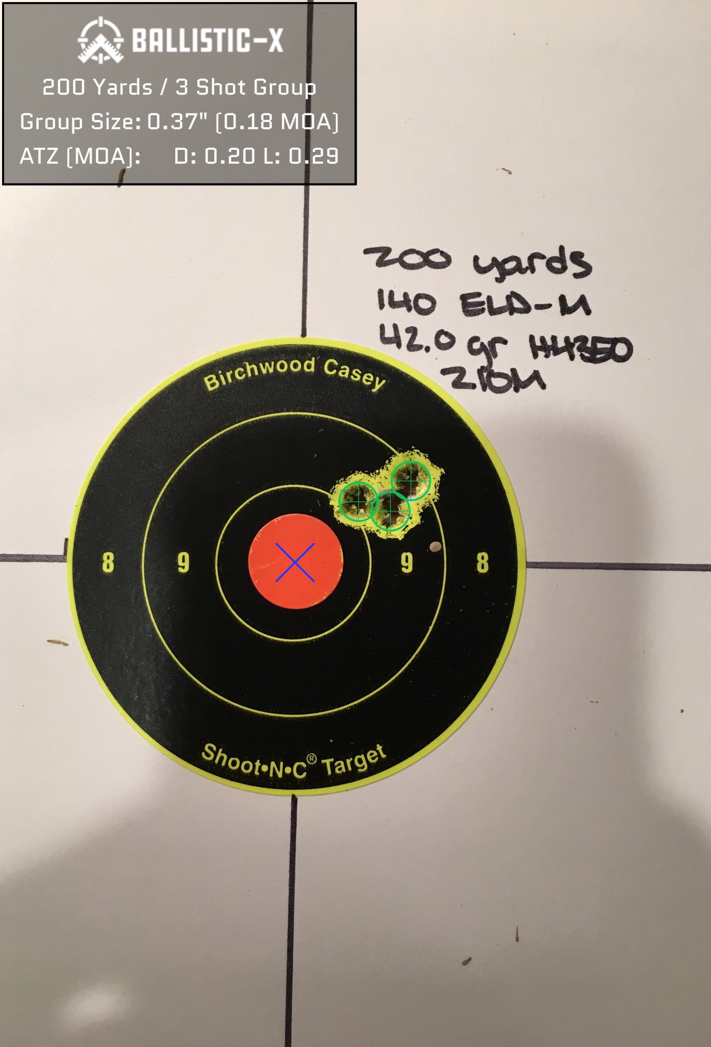

I pefer 2 stage on field working rifles. At the time I wanted to up grade my Tikka, Timney was only choice. . 22 months of shooting without cleaning this trigger. 2-3 day matches. 15 1 day matches a 3 day class with frank and lots of training. 3,000 ish rounds and not one failure. All shot in colorado with lots of fine dust blowing around and in action, At franks alone class lots of issues and folks needing to use ronsin to clean triggers. I did clean trigger as it was a bit crunchy last week. It’s great to have confidence in gear.

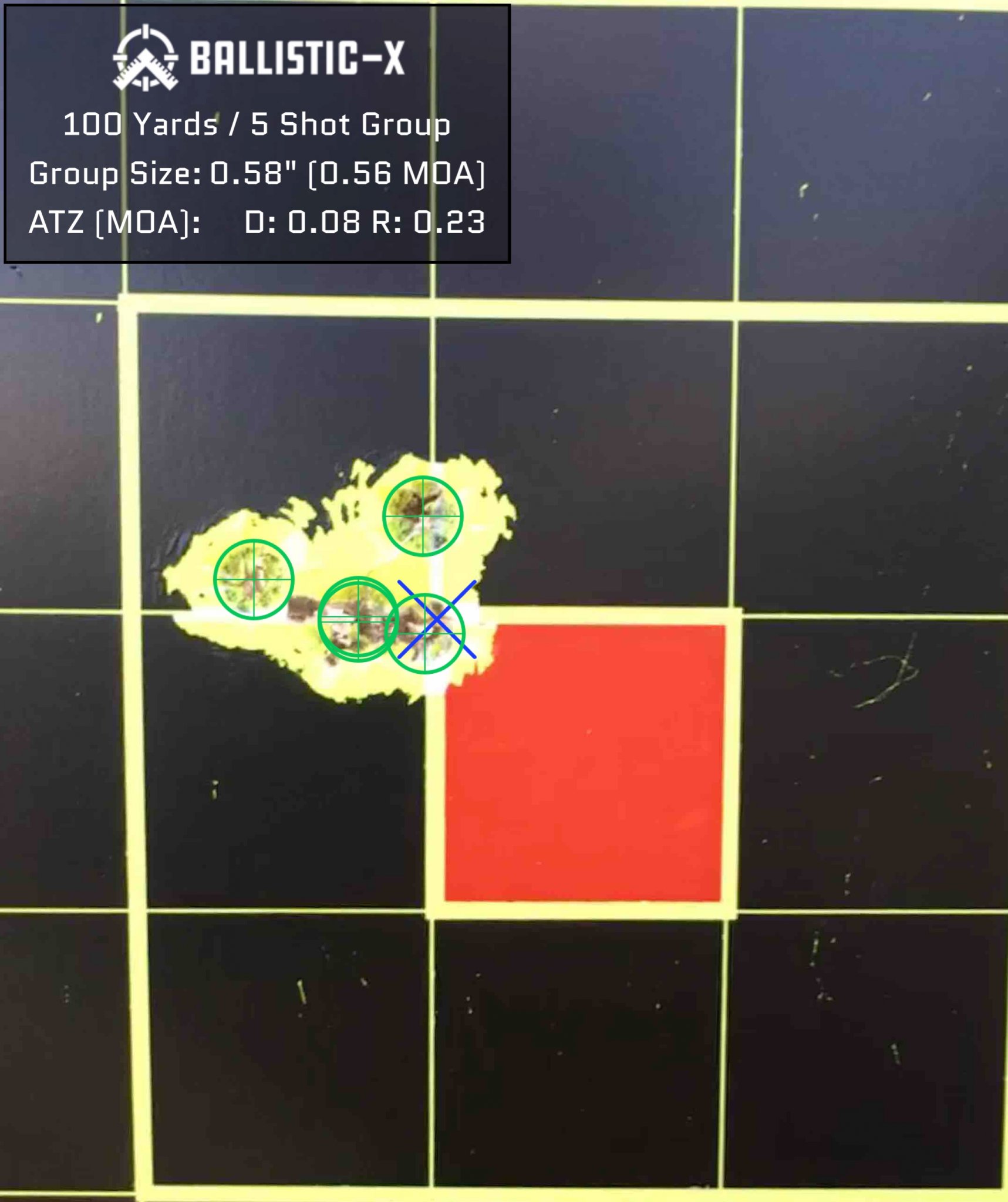

Shot a night time match up in Racine, Wi with the Timney 2-stage in my Tikka. It's definitely what I was looking for. First 2 groups I printed were pretty good. I chickened out on a 5 shot group that day ?
