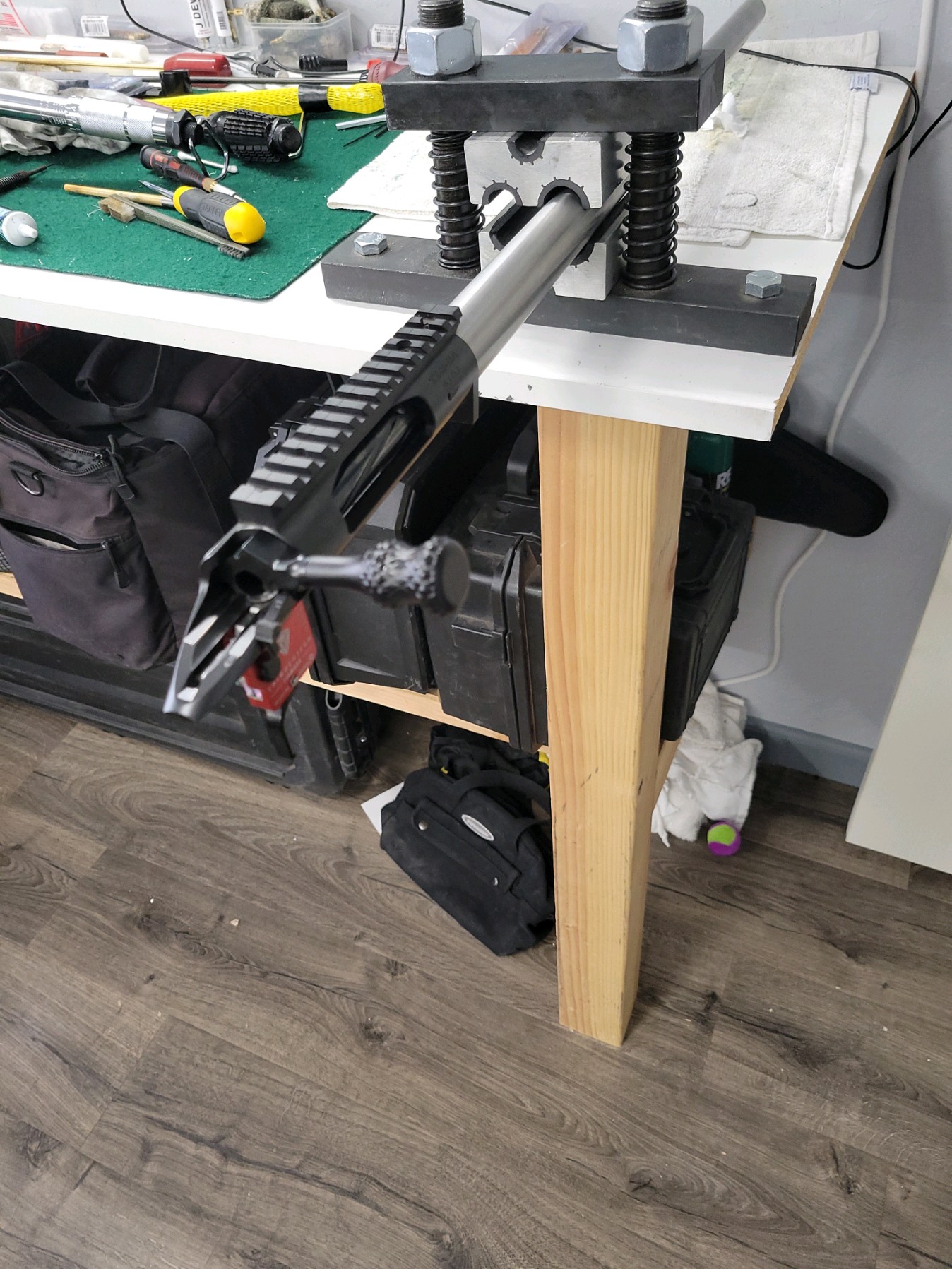

@spife7980 .003 was enough that new OCD brass would not close either. I even backed off the torque to 50 foot pounds and it still would not close. Went hand tight and it would close but was snug. Only .004 between go and nogo on my GT gages. I don't like tight headspace. I use to run that way but they seem to run better with a bit more room. The OCD brass measured same as go gage too.
The point is, check it. I have had 12+ barrels on this action. 2 shouldered prefits did not headspace. One was chamber the other was not enough thread. I have a barrel smith I trust. He does all my barrels now and no issues. But I still check before I go shoot it. And I don't get barrels from the other places anymore. Preferred Barrels is one I had issues with. Tried to save some $$, lesson learned. Never again.
Sizing die. Bump the shoulders. Your headspace is just a relationship between your chamber and dies. The brass will form to it
LOL. You do you. And not sure you understand what we were talking about. Go gage and bolt won't close, shouldered barrel on TL3 hand tight.

How would you, the user, know if you just screw it on your self and never check it with a gauge? What you're looking at is the earliest form of prefit. Gunsmith chambers barrel without the action in hand, gives it to customer, who installs it himself. And the headspace can vary a couple of thou depending how much torque you use. How much torque is he using in that video? Do you think he cares about 2 thou headspace?
When he stated " Our gunsmith knows this rifle inside and out " , I took that to mean the smith had the action in hand at some point. Wouldn't that mean the smith had the exact bolt face to receiver face measurement and could chamber successive barrels based on that info? I'm not saying prefits don't work. They obviously do. My point is, why not check headspace?
