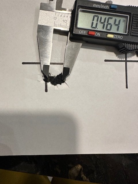

This was the 100 y group I shot using berger

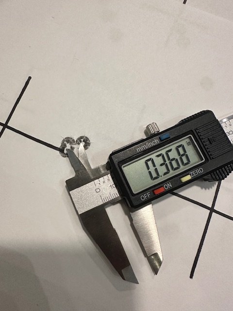

This was just meant to be my control group that I would test the RDF against. Of all the seating depths I ran, the below picture is best I could achieve.
I worked hard trying to get these RDF's to shoot and spent a lot of brain capacity getting there. The Berger is just a better bullet though for my barrel. Especially since I made those bergers maybe 6 months ago when I had a tenth of the reloading practice I have now.
That being said, I'm still going to finish shooting these RDF's. I'm alright with that performance. It will get the job done for these matches coming up. at 500 yards the Nosler group was even 2 tenths of an inch tighter. That distance has a few more variables at play though, and I'm sure with more dedication I could get the groups tighter on the berger. Both 500 yards group were sub MOA anyways.
