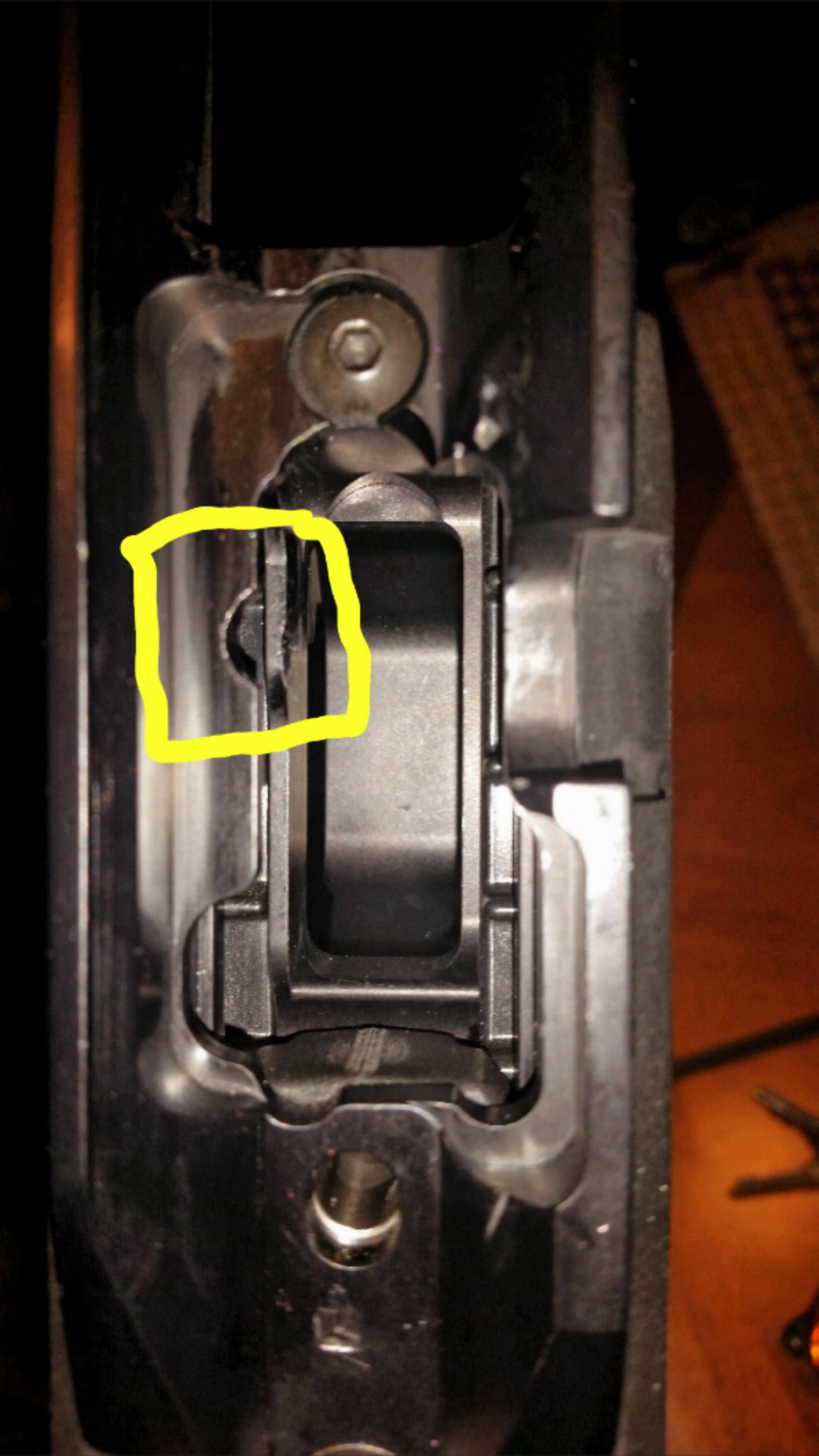

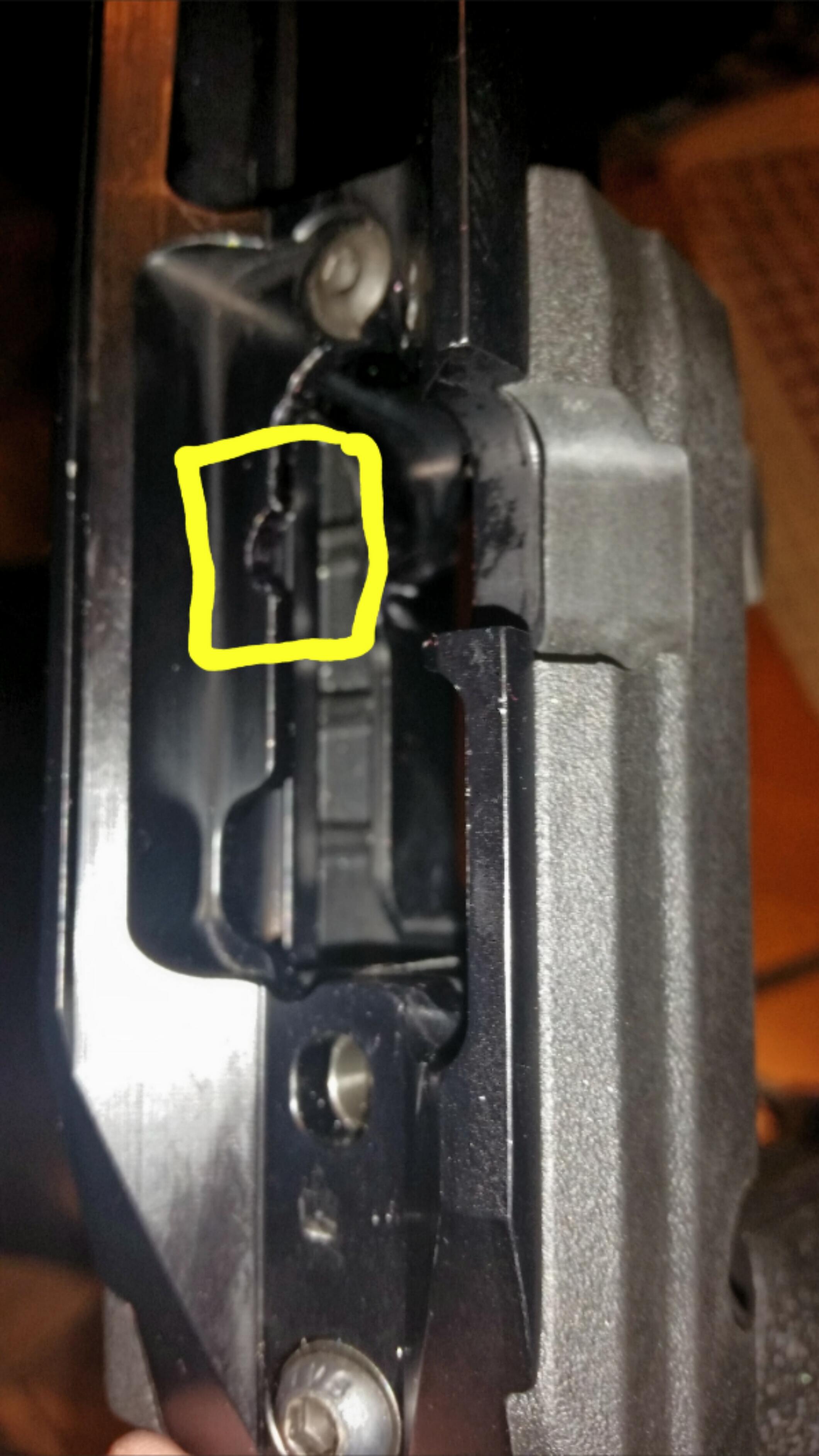

I installed a timney calvin elite trigger in my Krg x-ray chassis and once its all torqued down I could not put the gun on safe due to the pin that actuates on the left side when you put the trigger on safe. I had to use a round file to make a groove on the aluminum frame to allow room for the safety pin. I used some grease to put on the end of the pin then put the gun in the rifle and tried to actuate the safey to show where it was hitting then I filed it and painted it now it looks like it was suppose to be like that.
