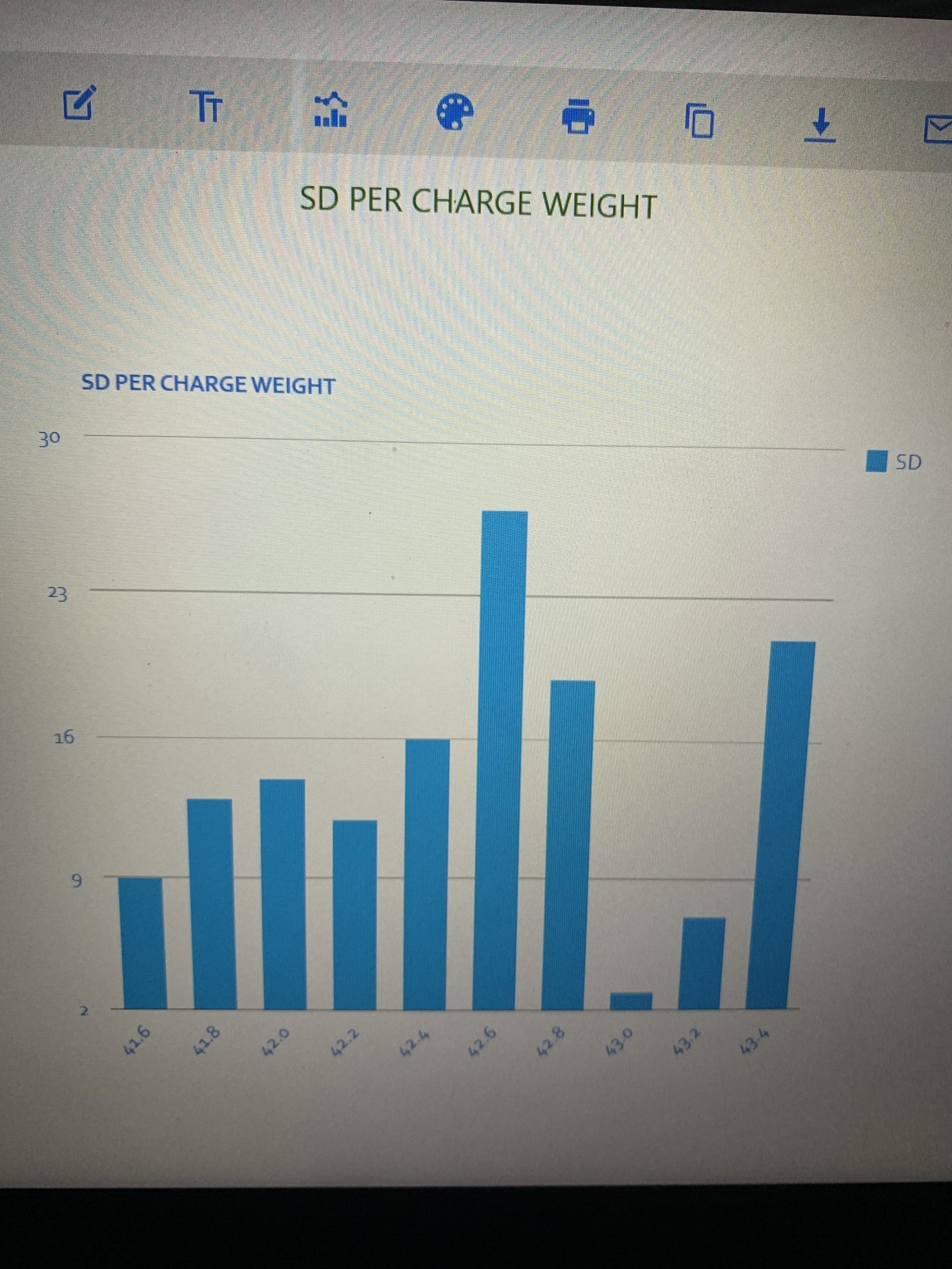

    I gave this a try again for my 308. Worked pretty well this time. Said my Charge was 43.2 and it lined up with my OCW. I might put a lil more weight into this going forward. My time limited lately and two my ranges are doing this social distance/time limit on 100 yards bullshit.
