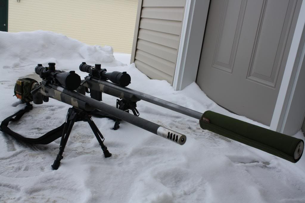

Re: Titanium muzzle brake
heres my titanium break its sweet. its half the weight. you can see there is a slight color differance from the break and abs stainless barrel cap.

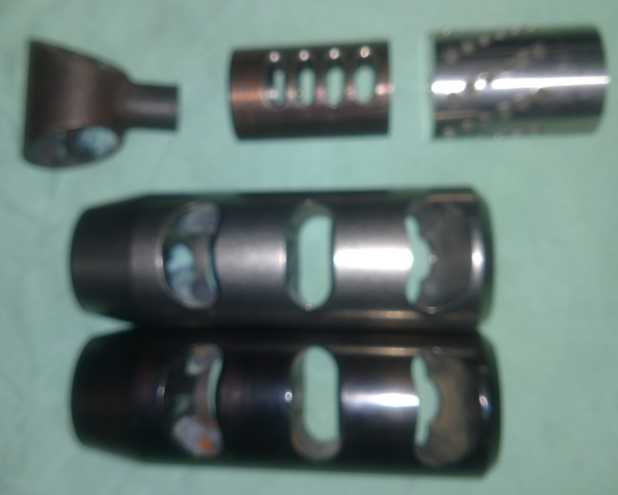

Here is a picture of my titanium brake for my 50 BMG next to a steel brake. I put two of the larger Harrell brakes and a JP brake in the picture for scale.
The piece of titanium cost more than the other brakes but so far all is well.
I did mine to make a weight restriction on the rifle.
