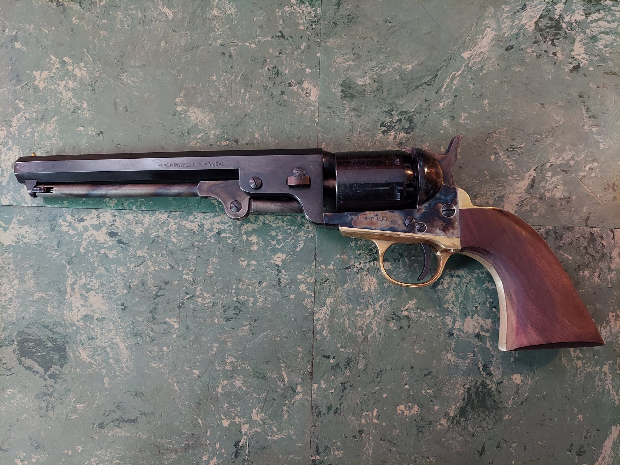

I have been considering getting the kirst cylinder converter for this one. The action is extremely nice the grip didn't fit worth a damn but I have that mostly reshaped. I definitely plan to chop the barrel shorter regardless of what I do and maybe contour like my Griswold. Not that I don't enjoy the hell out of shooting black powder, but I already have a couple in 36 in kinda want to do something interesting.
If any of you have done the cylinder conversion I love to hear your thoughts. Otherwise here is a picture of a very pretty 1851 Navy

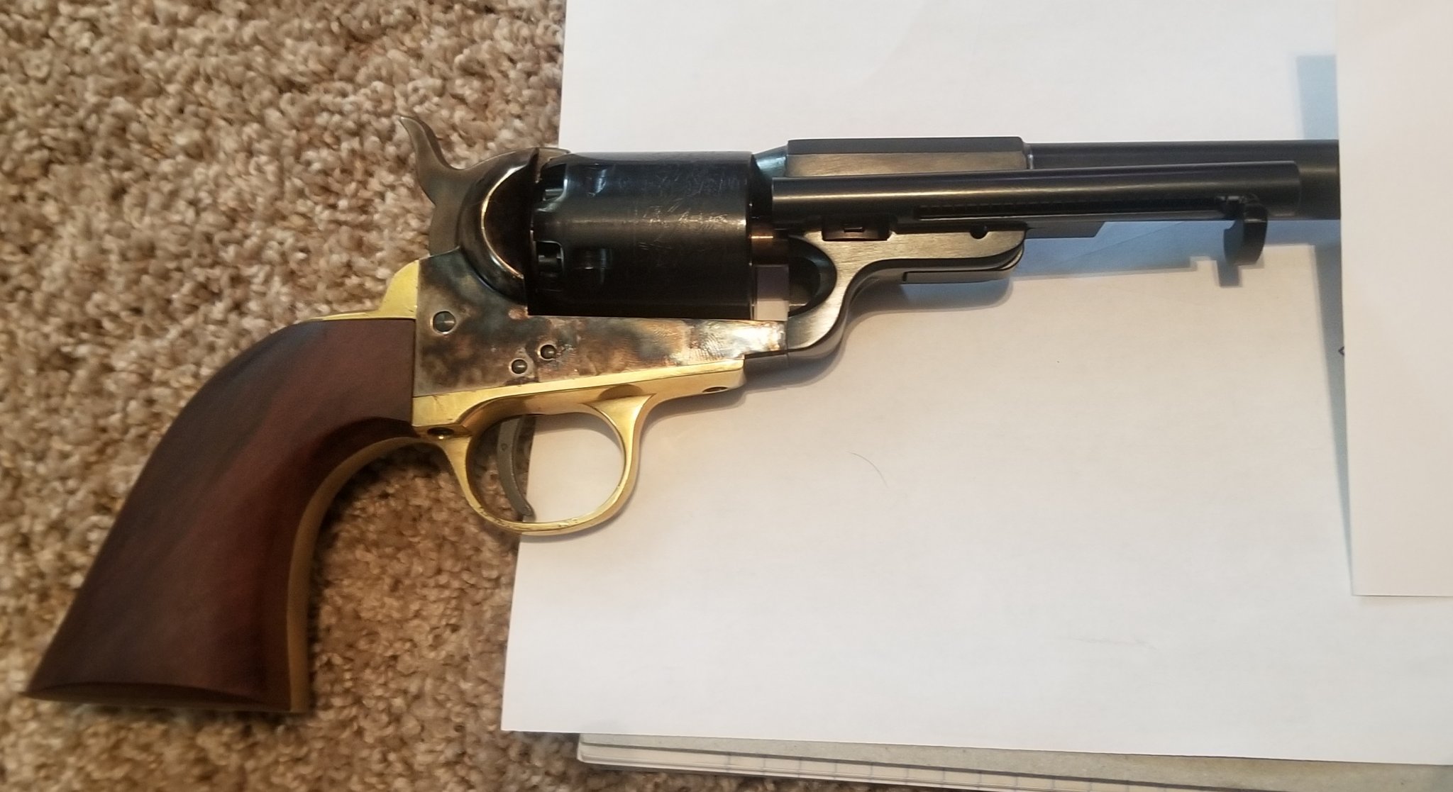

Thanks, I didn't plan on it but the grips on this one were obscenely outside of the brass unlike some of their others that are only slightly outside here and there. That's why I ended up doing it. I was holding off because I had not found any ejection tube assemblies in stock but I found one over the weekend. Once it arrives I'm going to cut the barrel and finish the lathe work on the outside before I send it in to get lined.

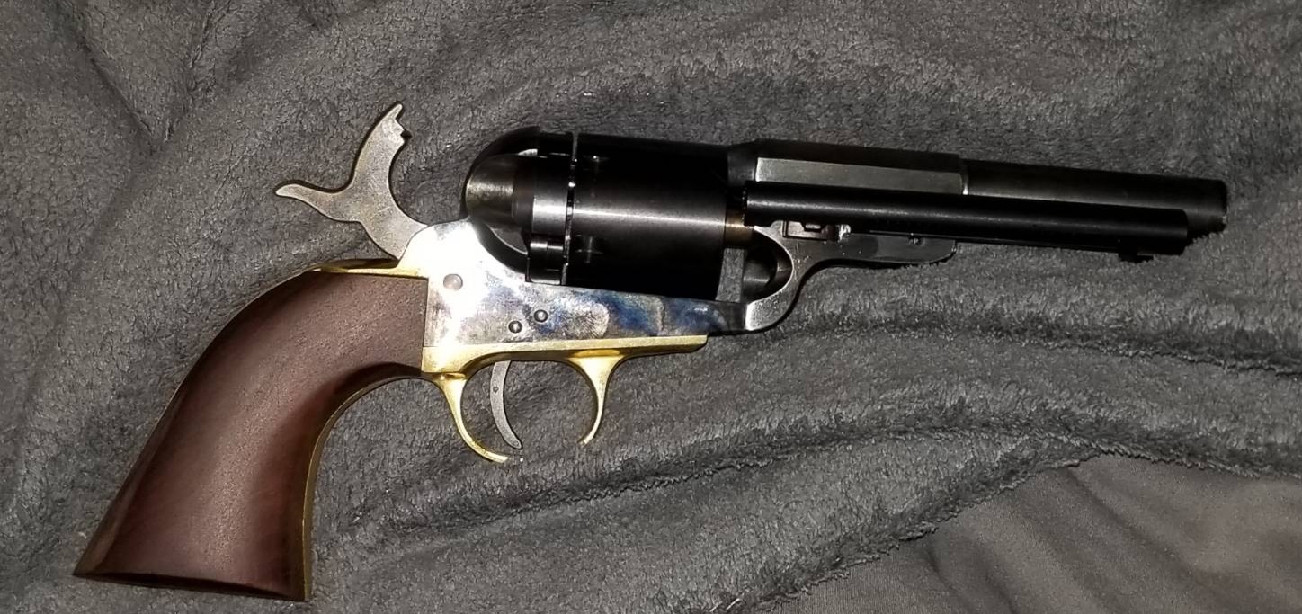

The conversion cylinder should be here soon. The lathe work is done and the ejector came in today so I can cut the length before the barrel is sent off for lining.
bout there looks good.😁
Lookin good! Is that cold blued?
Reactions: Romeo458
Nice!

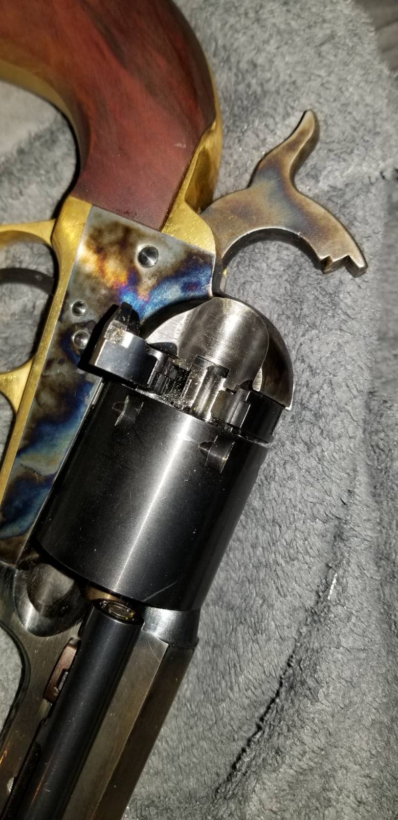

I haven't been able to find the proper sized liner in stock but in the meantime I've been busy.
The ejector rod is still going to need a little bit of fitting work, but she's coming along nicely.
