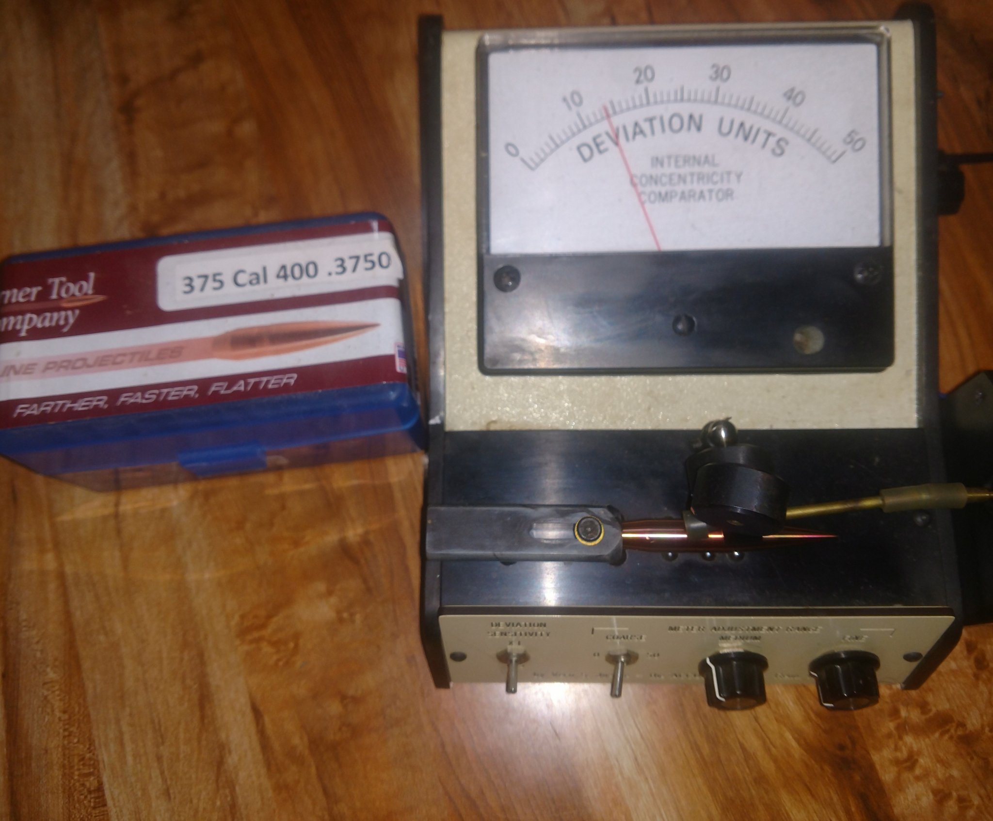

I am spinning some Warner bullets right now. The picture is deceptive because you need to set the matching at a single setting then spin the bullets looking for the variation.
I set it near 10 and in 0.5 scale and so far the first 9 bullets have all measured under 1 deviation unit which is 0.5 deviation on the 0.5 scale.
If the rest measure this good they get more of my money.

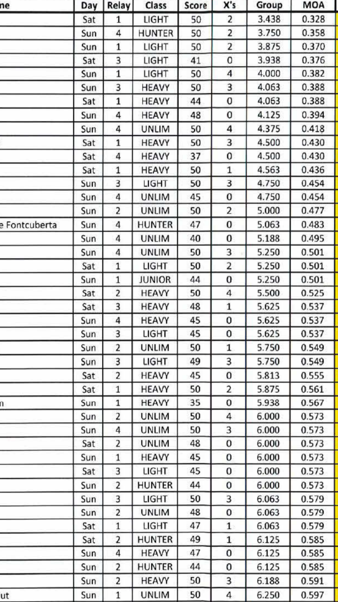

Can you show me a full line of sub 2 inch NBRSA groups?
The screenshot shows the groups at the 2017 Nationals.
I suspect you are looking at local club matches?
The URSA gongs are 37 inches round and if you get 4 out of 10 you advance in 500 yard increments.

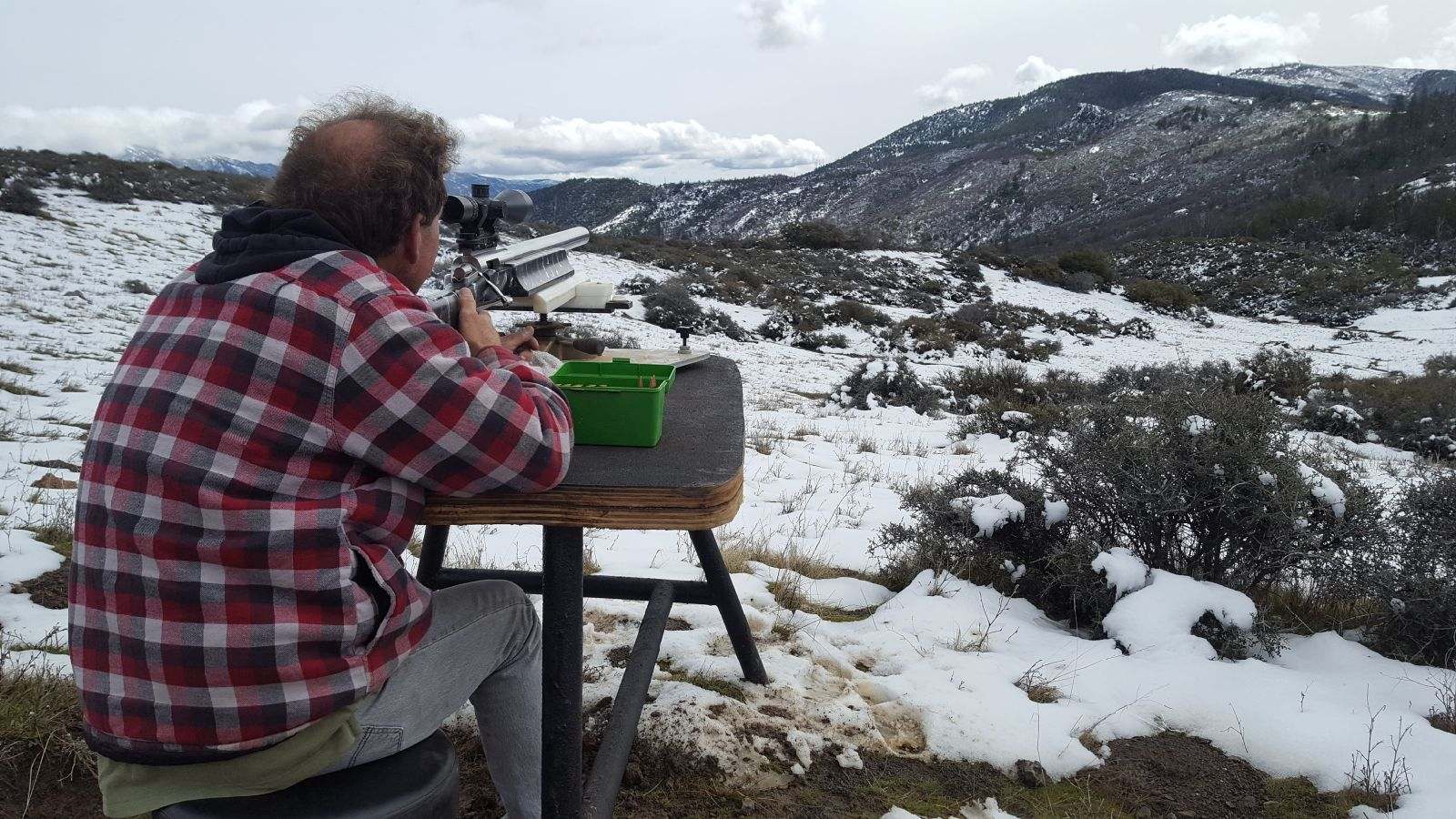

The picture is me shooting my 338 Lapua Ackley Improved across a 2000 yard canyon. It's hard to spot your misses in snow.
What distance are these groups shot at?
All the groups were shot at 1000 yards.
I don't know of any organisation holding benchrest matches farther than that.
Group sizes will vary with the weather.
If your shooting in Reno Nevada and the zephyrs are blowing groups will open up.
