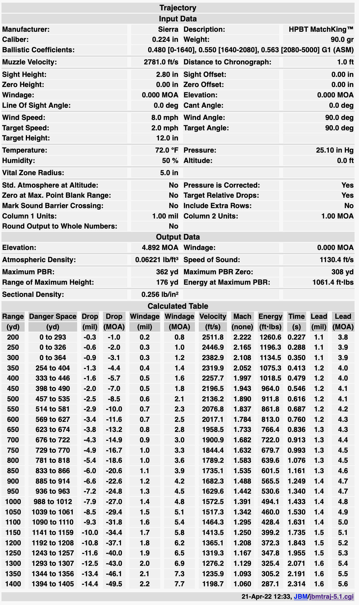

If you look, I am using the Valkyrie in that other post, because the Valkyrie uses a Sierra Bullet, I used a G1 value and they BAND IT, and without any truing the values line up to my real-world data
the G1 vs G7 argument is fake, you can absolutely use both with equal success,
There you can see my inputs for this
