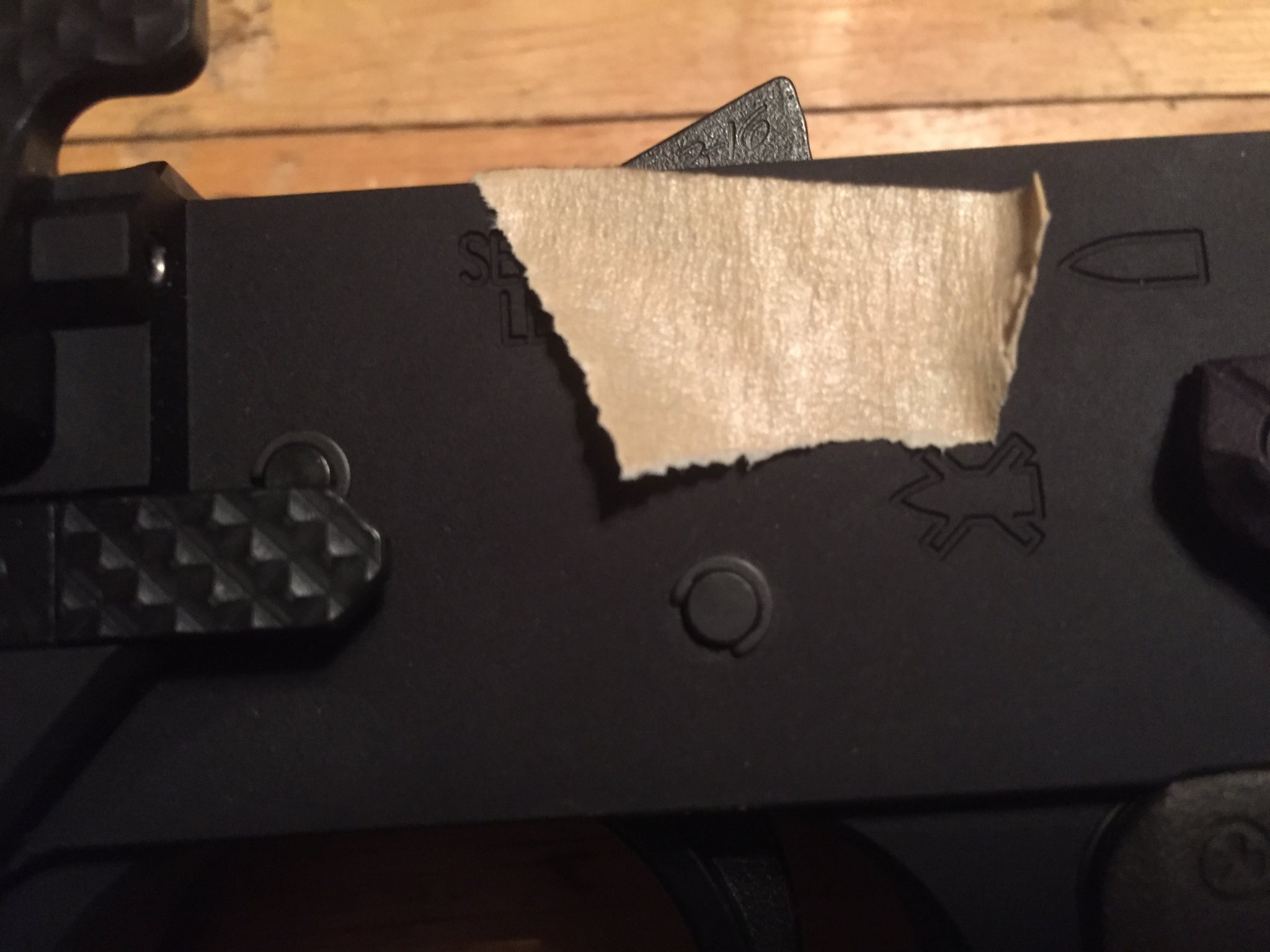

you can wiggle some Kapton tape under each side and use needle nose pliers.Lay the pliers flat on the receiver with the tips on each End of the c clip, a light tap and it will pop off. The Kapton tape will protect the receiver
First one slid right off. Figured I didn’t need a bag for the second one. It flew like a slingshot. Gun bench troll wasn’t quick enough. Found it ten mins later lol
