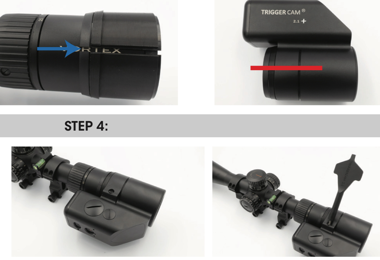

One disadvantage I’ve found with the new Trigger Cam 2.1+, and I hope that I’m just missing something, but don’t think so, is on the Tangent Theta 735 it has to be mounted at a 90, and even still interferes with low/high zoom as it interferes with the zoom throw, which is surprising because it’s not that large in the TT, unless I’m messing something up mounting improperly…if so please let me know, especially if your already running in on a TT 735. Here it is all the way engaged forward on the TT 735, not tightened in the pic, but the outcome is the same in the normal top position.
So it turns out if you mount the Trigger Cam 90 degrees left it will work on the TT 735. Still a miss on Trigger Cam, just lift the top assembly up a few mm, instead of just 3D printing new collars and calling it a “new model” that will work with larger eye piece optics….having used an old one with ZCO there were ways to make it work, but not right. They need to actually redesign the entire system, especially in the days where more PRS and shooters in general are making the x-25 magnification jump to a x-35-40, with footprints shrinking and optics getting better. I mean what’s the objective size on the new Kahles 540? 56mm? Unfortunately there’s no other hand that’s this crisp in town. Even the multi shot camera systems do not have the same level of quality as far as recording and playback when they connect and work properly.

Either will work, the only real reason to get the + is if you prefer the horizontal mount (better view of elevation turret) or want to use a large ocular.
Reactions: Dead Eye Dick
Just want to confirm I’m not a total idiot, the 2.1+ is designed to be mounted sideways on the left side of the scope otherwise the image is clocked 90° and I don’t see a way to rotate the image in the TG 2.1 app. Making me nuts.
Having a hard time getting it to center on a Razor 6-36 because I have the ocular extended and there’s not much scope body for the clamp. Also on a ZCO 5-27 zoom lever interference.
