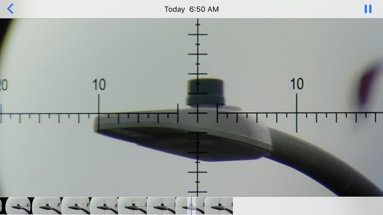

I order a trigger cam and returned it. This is not meant to be a bash, but the reason why was because 2/3 of the view was below the crosshairs. And when I talked with Andre, he said that's how some of them are. If you want one, wait until there is a US distributor because even after I returned it, I had to pay customs on it. This experiment cost me about $80.

Once the update came, about a week after my phone call, the camera is working great and the picture from the iPhone is really nice as it's using that device.

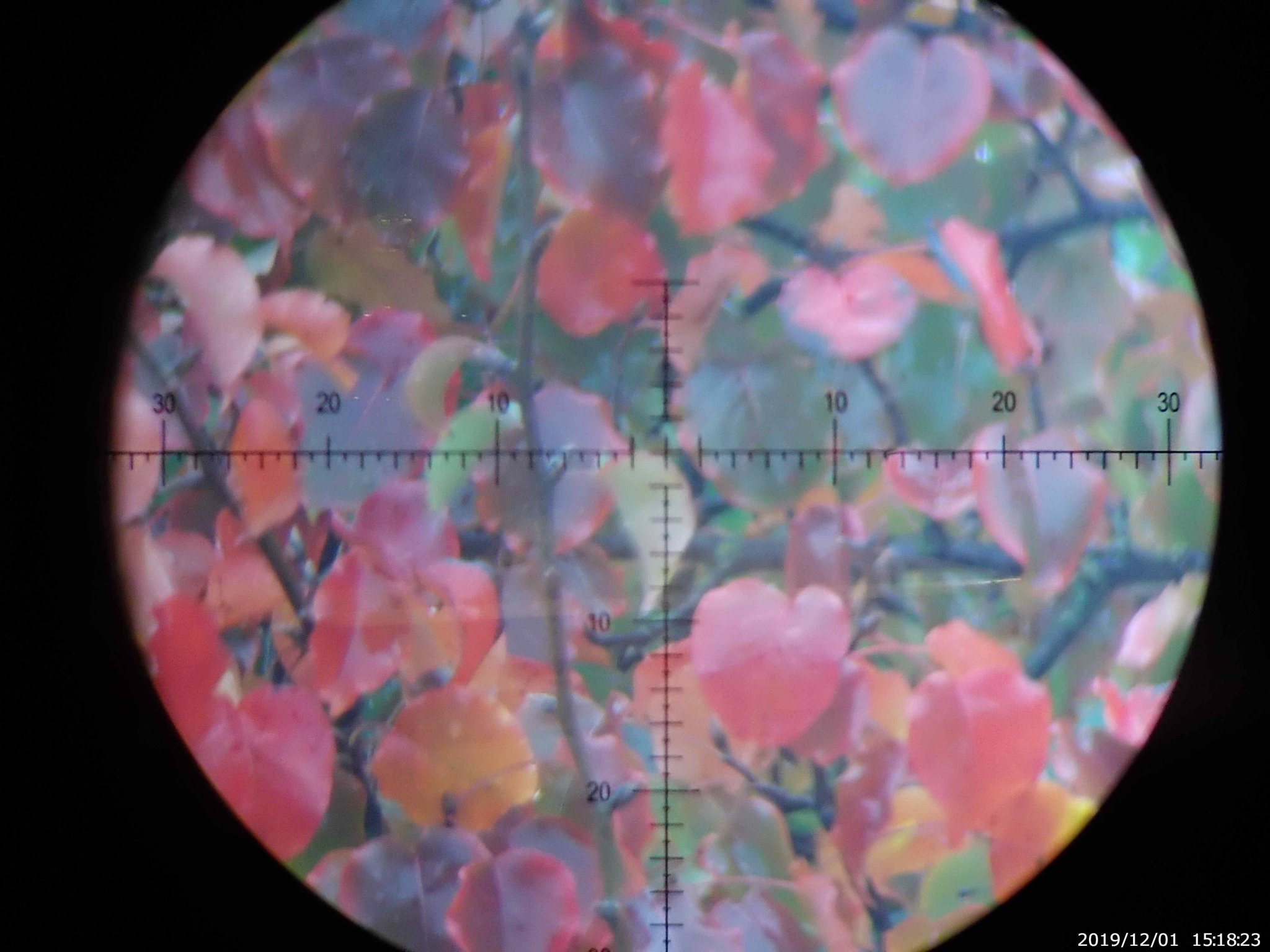

I have the same picture as observed above
Not adjusted or focused, but you can see the view you can get.

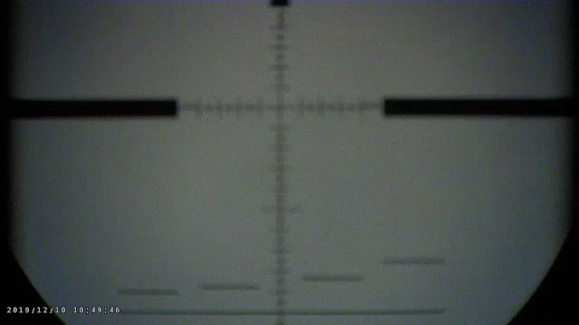

I was unable to load the video, but here a shot of full zoom. There is some black in the upper left hand corner.

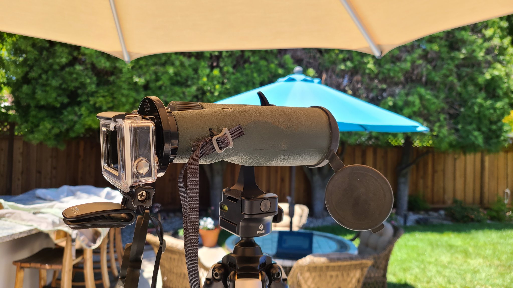

On a spotter though, I have found the Phone Skope system for a Go Pro works very good, it's probably the only way I will suffer a through the scope video

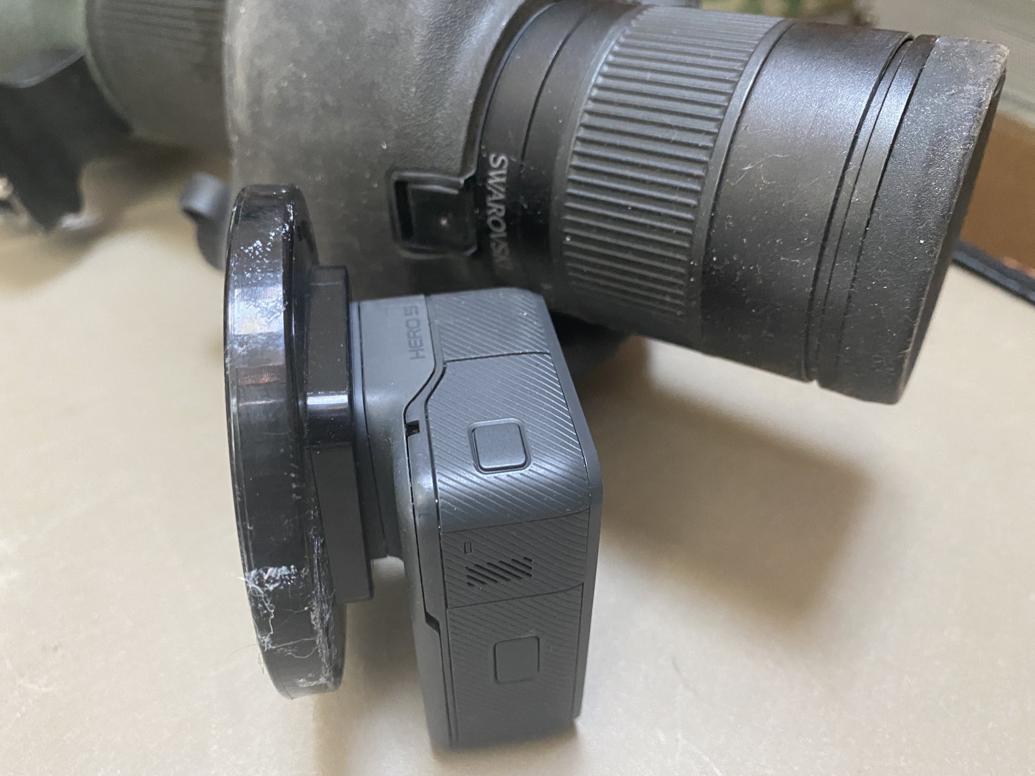

I didn't have great luck with my hero4 and swaro slc 15x56 with the phoneskope adapters. Any tricks?
